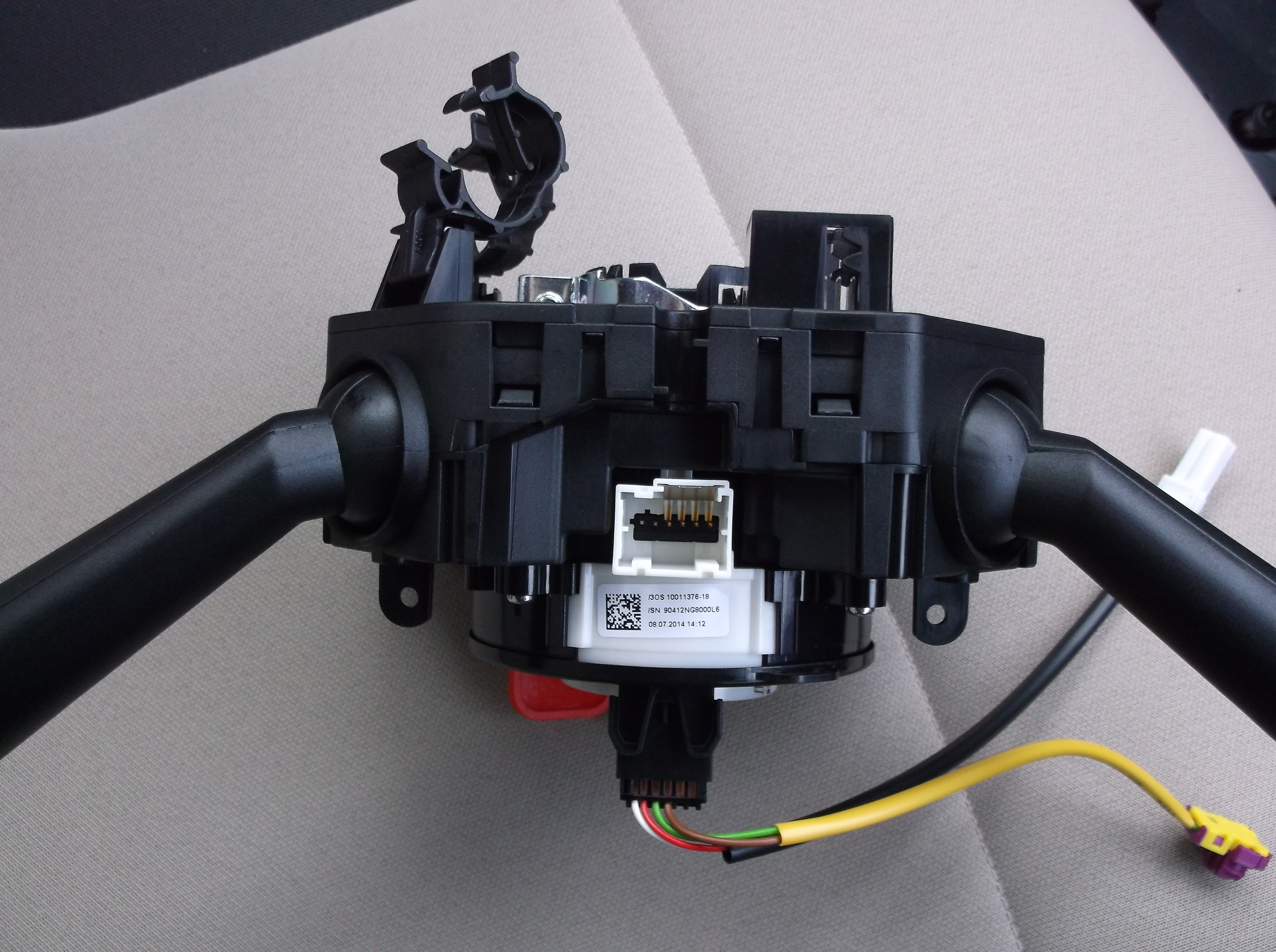

In December 2015 (before that recall was announced) my Panda was suffering from the headlights staying on when turned off. I replaced the stalk assembly and that alone cured the problem. Looking at this forum, other people have had problems with the stalk assembly too. This suggests that it is quite possible that OP's fault is caused by the stalk assembly. I did not have to do any 'proxy alignment' of the new stalk.
Photo of stalk assembly, for clarity on what I replaced:
Replacement of the "stalk" switches is relatively straight forward once you have worked out the tricky spring clips on the airbag assembly. I had to replace my switches etc since the "clockspring" was returning an error that turned the airbag light on when going from lock-to-lock. I was able to order a replacement from shop 4 parts in the UK but this may not help the OP.
No alignment required with Body Computer as stated elsewhere above.
