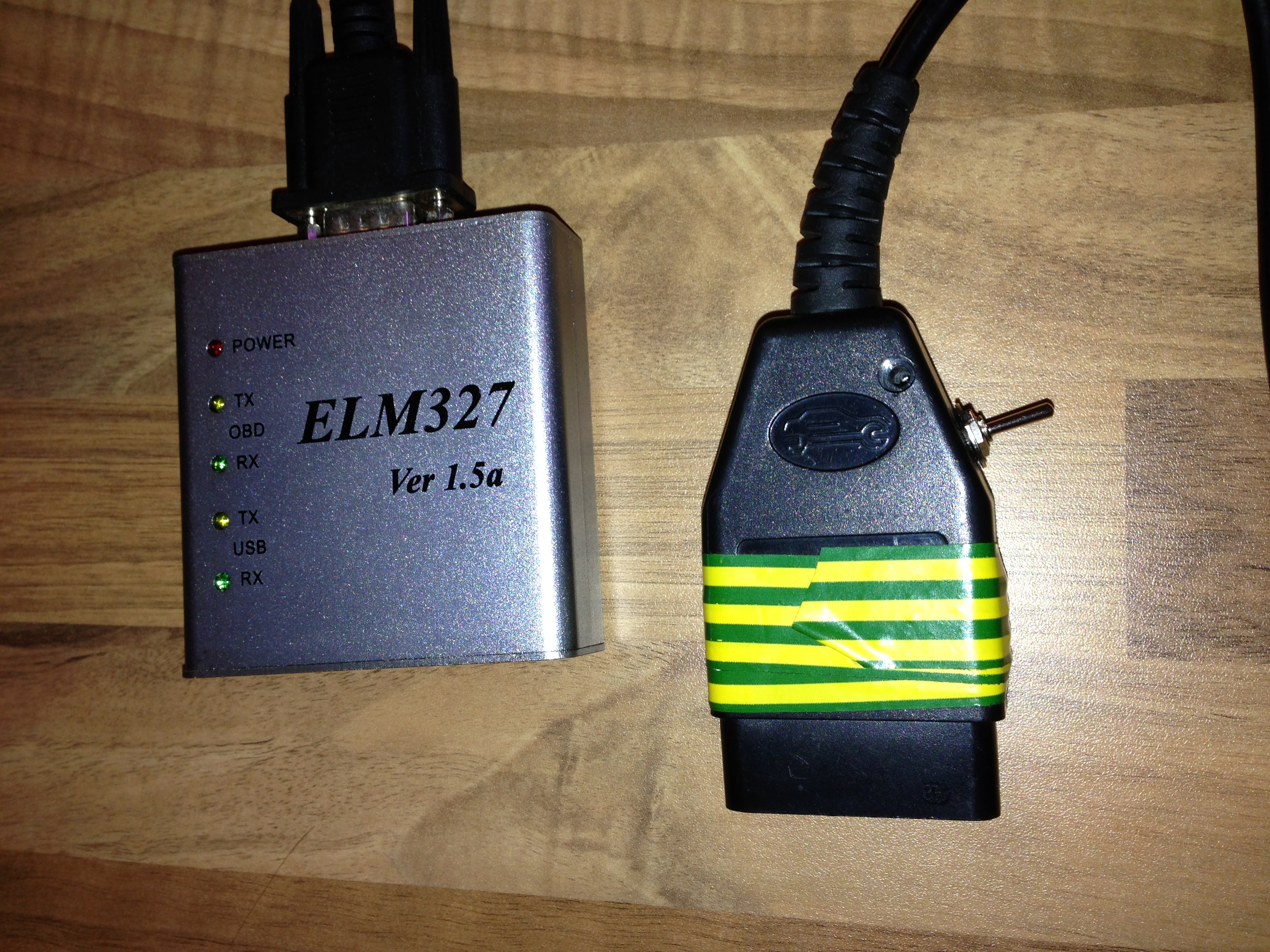

To clear up a small point mentioned earlier: ELM327 is the newer-style interface required for the FIAT 500, Grande Punto, Panda, etc. - basically everything of the Stilo's age and newer - because it is capable of connecting to the body computer or the instrument panel, that is what I meant when I said it was required for the 500 (I assumed we were still talking about resetting the service interval).
KKL (VAG-COM-type cable), often translucent blue, is useful mostly for pre-CAN bus vehicles older than a Stilo. Each ECU tends to have its own pin in the FIAT/Alfa connector, but the KKL cable has only pin 7 connected. Therefore, it is necessary to bridge pin 7 to various other pins (1, 3, 9... etc.) to connect to various ECUs.

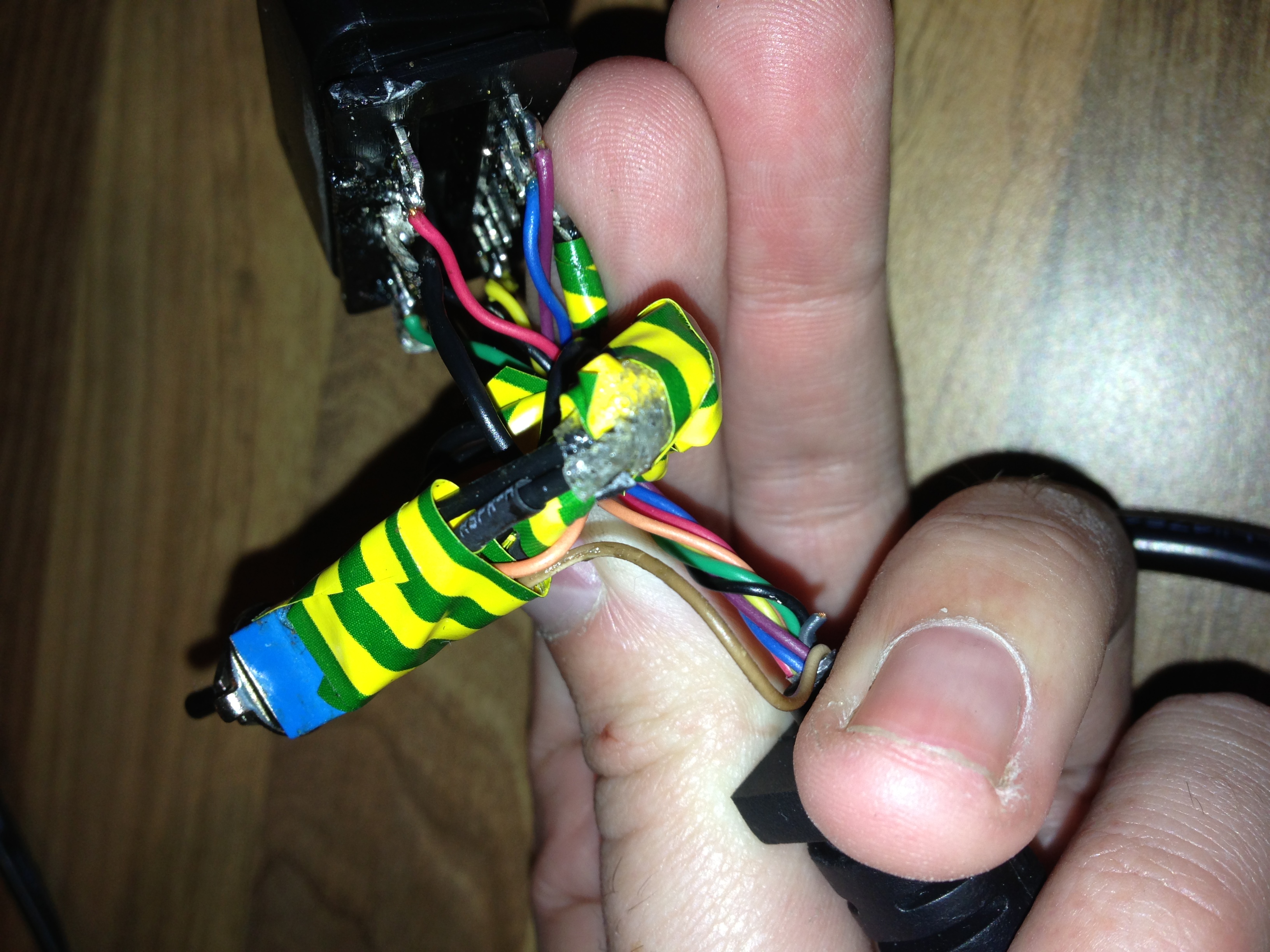

Typically, people modify the plug, as the pins are easily accessed and soldered to. The danger is that plugging such a bridged cable (specifically with a bridge from pin 1 to pin 9) into a newer-type vehicle (500, Panda, etc.) will short out the CAN bus, which may cause confusion and damage. Note that Most Easterly Pandas probably has an un-modified KKL cable or at least a KKL cable without a bridge to pin 9. This point is explained in red text on the 'Supported vehicles' page (

There are three possible adapter cables required in addition to the ELM327, which can be made up by wiring together plugs and sockets as shown on the right-hand side of the 'Compatible Vehicles' list. Note that Adapter 1 bridges 1, 7, 9, and 12, and therefore can't be used on the 500, Grande Punto, Panda etc.

Anyway, to be safe, I start with my 'new' ELM327 cable first, which is useful even on older vehicles for engine and transmission ECUs. I use the KKL cable for other older applications, such as airbag ECUs (pin 3). The software simply won't allow you to use the ELM327 for some older applications, nor will it use the KKL for many newer applications.
I also think it is better to make up adapter cables, rather than modify the plug, because then you can be certain that you are plugging an un-bridged cable into the newer cars (avoiding the risk mentioned above). Alexh365's method of using a switch is good too except for two hazards: (i) the switch has to be positioned carefully, or it will impede the fitting of the plug into some of the more deep-set sockets out there. (ii) you would have to be very certain that the switch position was correct before plugging into the car. For the technician in a hurry it is probably easier to identify the adapter cable, rather than the switch position.
