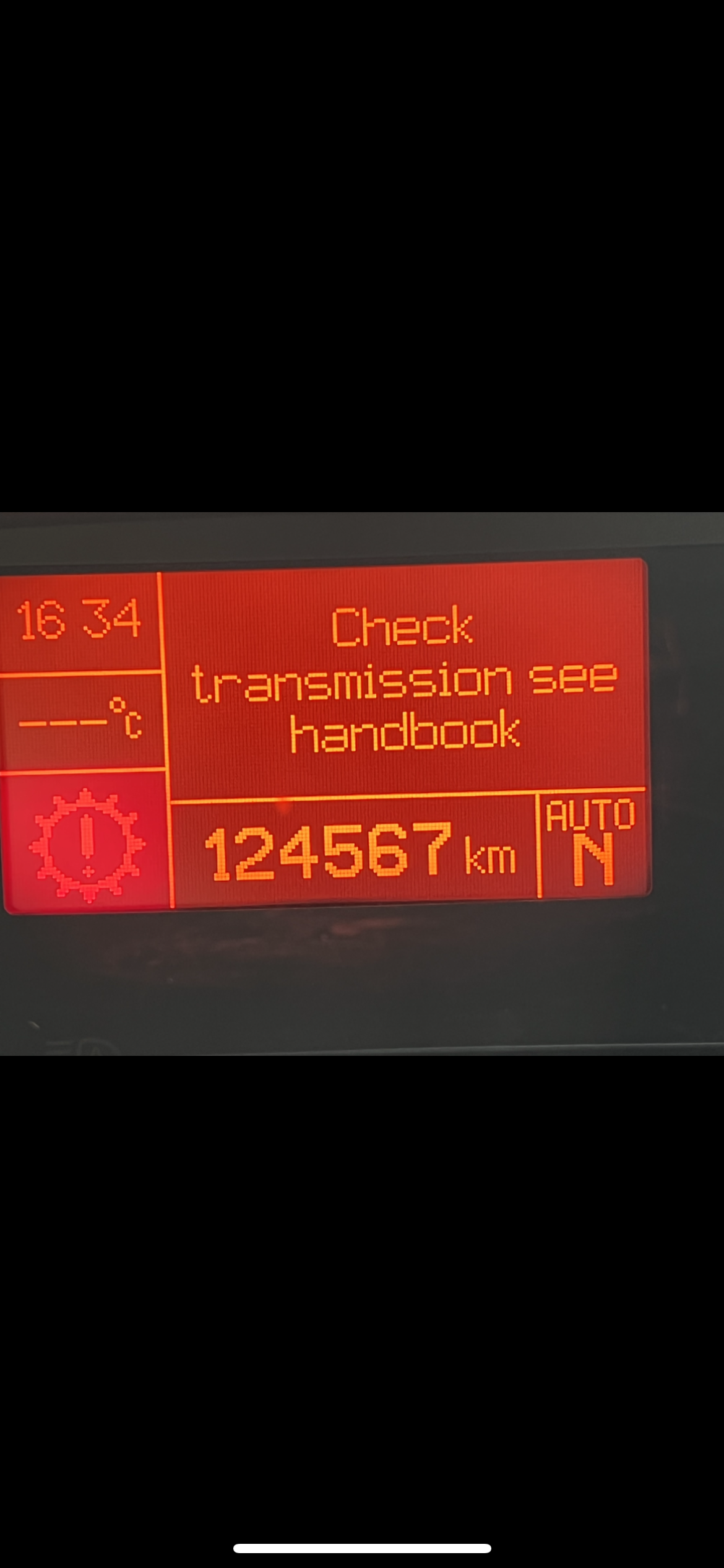

I have 2018 Fiat Ducato motorhome with 127,000km on the clock, now travelling in Tanzania, East Africa.
Some 1,500km ago I got a fault: P2930 Clutch position sensor. It was cleared 1,000km later, and some 500km after that I started to have real problems… like gear unavailable, switching from auto to manual not being able to change gears, automatic gears shifting like, if it was without clutch altogether (car jumping
. I’m hoping to find a mechanic in a bigger town here tomorrow. But the nearest authorised service is 6 countries 5,500 kilometers away in Namibia. I have no chance to get there. Plus, when I asked, they have no experience with comportmatic gearbox anyway. Only manual Ducatos have ever been imported to Africa.
My question is: When does the clutch need to be replaced on Fiat Ducato 2018 Comfortmatic gearbox? Is it possible that 127,000km is just about time? Do I need any spare parts for this? Or the clutch just needs to be “re-machined”? Where can I find any information how to actually do this? THANK YOU for any good leads!!
