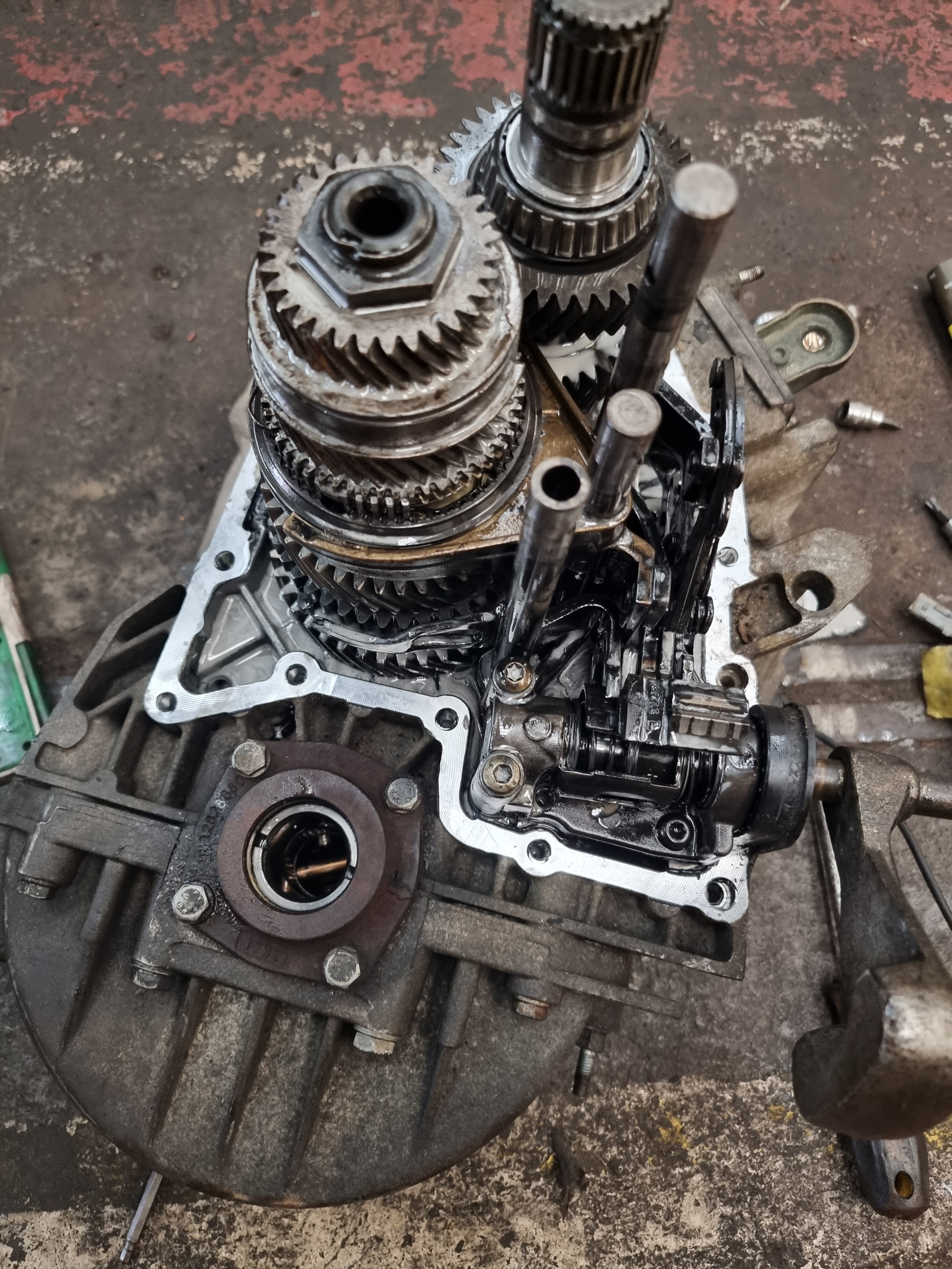

Hi found out why my gearbox won't go into 4th gear
The 4th gear cog had some baulk spring clips in it and one has snapped of which part of it is sticking out the slot in the side of the xog stopping the otherer cog going over the top of it to select 4th gear .got the spring clips to fix but looking at all the cogs and parts I was wanting to no if anyone had a video showing how to dismantle and refit the baulk spring clips and reassemble it as a bit worried might do something wrong or get something in the wrong place or order thanks again in advance mike .
