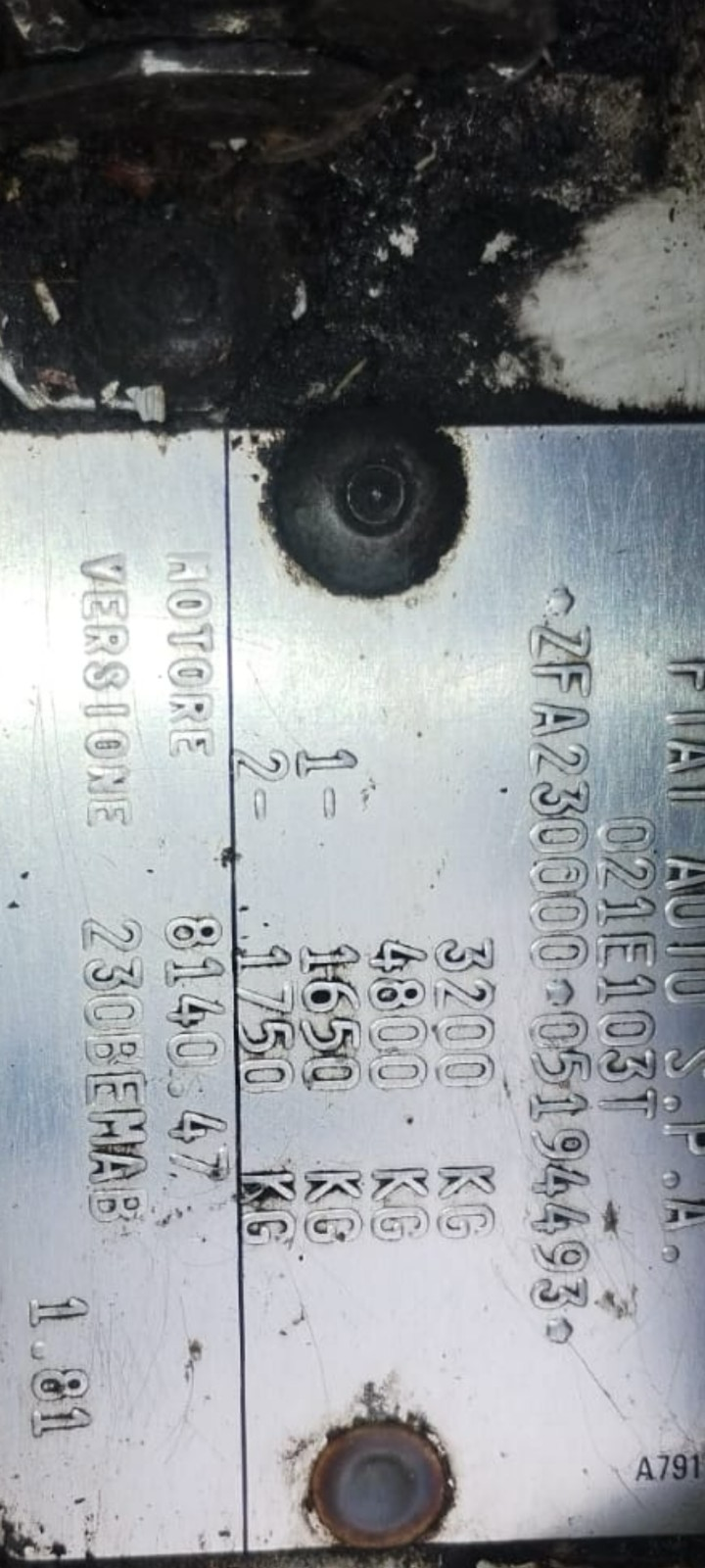

Done a. Number plate search, I believe this is the engine, will double check 1st though
ENGINE Fiat Ducato Estate (Wagon) 2.5 TDI 1996.

View attachment 472084it is 8140.47.. and it has the turbo/intercooler with it... is this the same as you fitted in the boat?
No mine was the 2.8 rated at 122hp. :-
8140.43
2799​
118 (87)/3600
122 (90)/3600​
270 N⋅m (199 lb⋅ft)/1800
285 N⋅m (210 lb⋅ft)/1800​
R4, DI, turbocharged, intercooled​
OHC/8​
This is yours according to wikipedia:-
8140.47
2499​
116 PS (85 kW)/3800​
245 N⋅m (181 lb⋅ft)/2000​
OHC/8​
