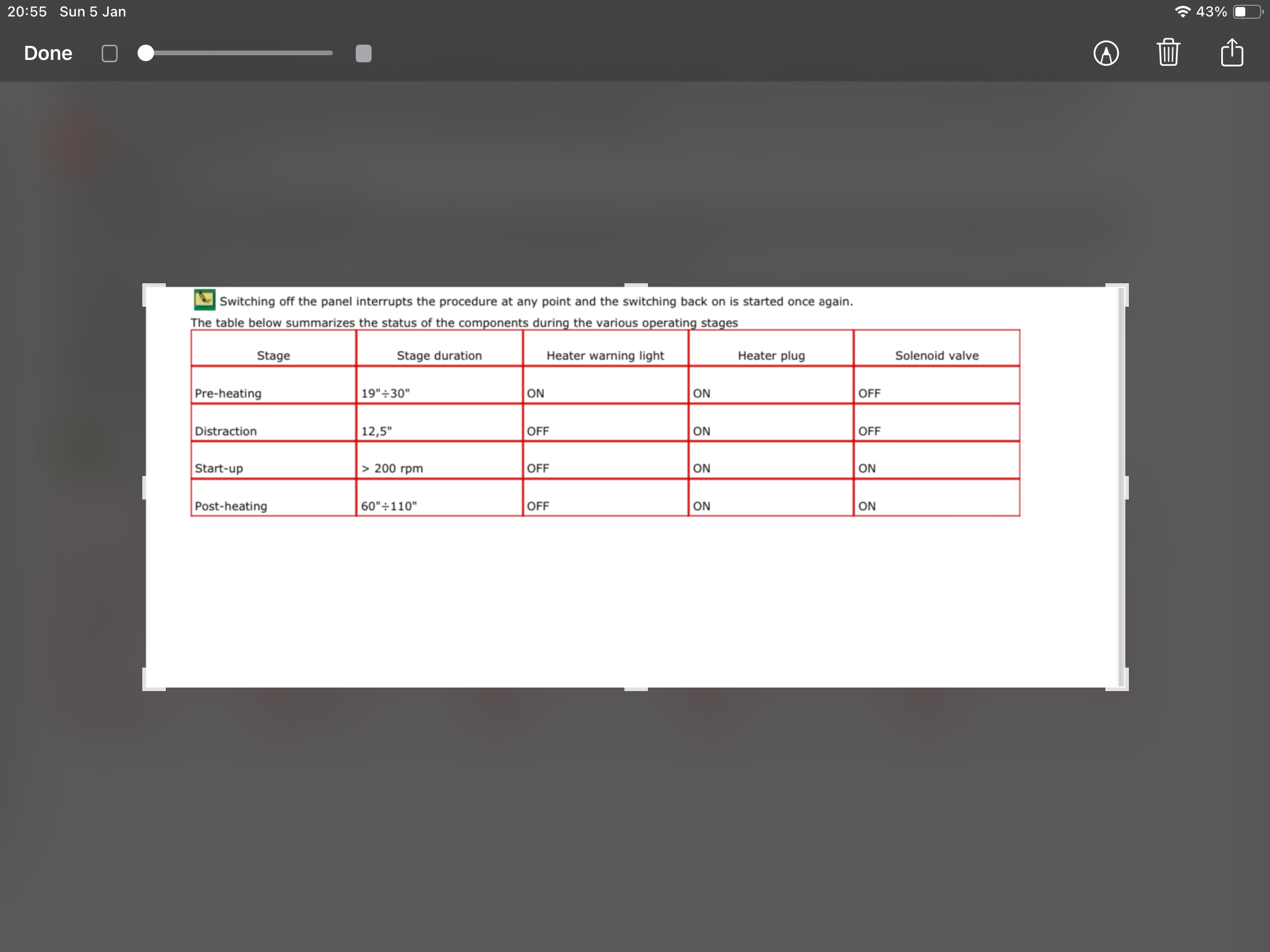

I generally wait until the end of the self test time, before cranking the engine. As my vehicle is a PVC and perhaps because it is rarely used in winter, I cannot remember the flame starter operating. For further info on flame starter operation see eLearn extract, but this does say wait until light goes out. Do be aware that the Motor Roam website is descibing an earlier relay controlled version of the system, installed on an 2.8idTD. The 2.8jtd version is controlled by the ECU.

Right last post for today,honest🤪 so if my glow light is out more or less straight away ,which normally is ,how long do I wait till crank, and how long do I wait if about 12 seconds,which it was for the first time the other very cold day, sorry I’m having a senior moment

To answer the waiting time query by quoting from eLearn
"Starting should not begin before the end of the pre-heating stage (indicated by the heater warning light going out) or else the preheating is interrupted."
The bold type above is mine, and intentional.

As regards the glowplug light, the 2.8jtd starts at ambient temperatures as low as 0C without invoking the flame starter. As previously stated it is good practice to wait until the warning lights go out after the self check phase. You should not need to wait longer unless the "glowplug" light is still illuminated.

Thanks again,yes your right about the route of the lead , it seems to lead to back of starter,it’s going in again Tuesday but would have been started so will start instantly.Has the leak of test got to be done first thing? And the starting lights still confused, the glow plug light is out straight away, so do I start straight away, or wait like I have been for about 10/12 seconds, sorry for all the questions, I did ring and auto electrician and he said straight away starter motor without looking £300🫣
The leak off test needs to be carried out with engine running. You will need to remove the engine cover which is not the simplest task, as it has a projection which hooks under the injector leeds at vehicle LHS. Need to remove lifting lug, and cut cable tie. Take care when removing leak back connections from injectors.. To start, turn key on, wait until warning lights except battery, and oil go out. Start. The most expensive starter that I can find on Ebay is a Bosch at £154.66.
