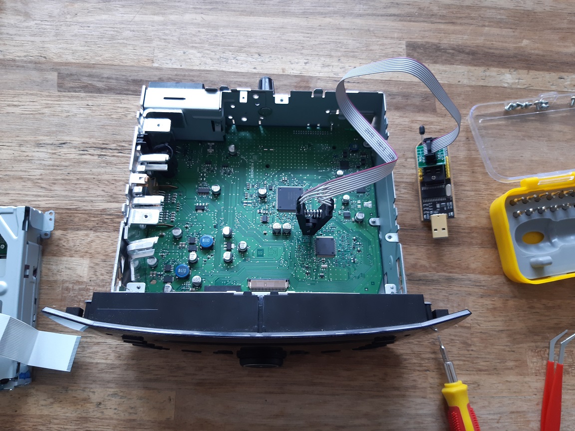

I bought a simple USB EEPROM reader + clamp from Amazon that allowed me to dump the ROM without desoldering it from the main board. You can upload the dump to a forum like Digital Kaos where you always have people helping you out with a code within a few hours.

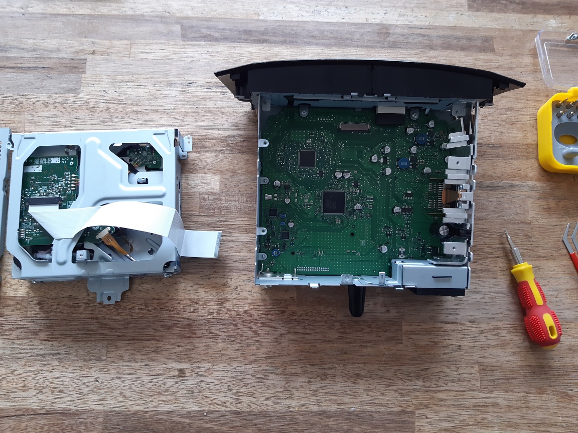

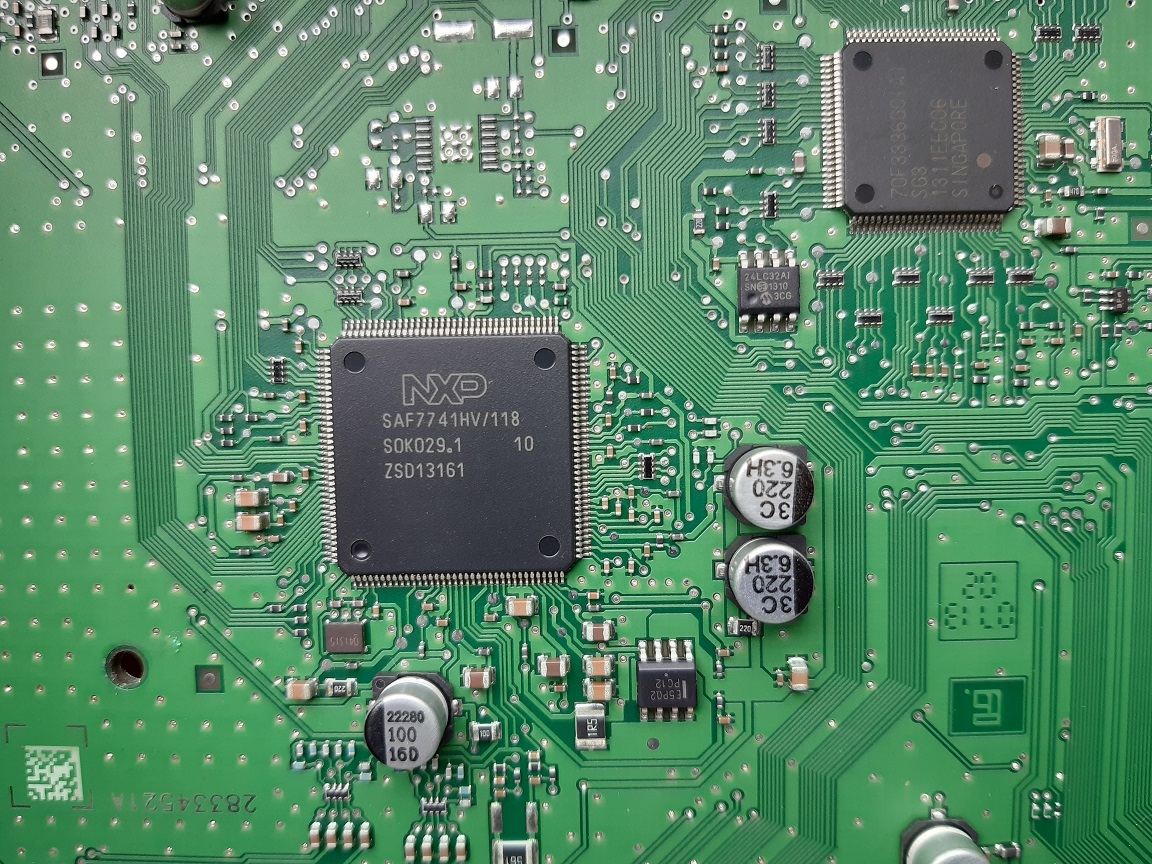

Just look for an CH341A. Be sure to get the clamp as it wil prevent yoy from having to desolder the unit from the PCB. I bought some empty ROMs from Reichelt to do some dry testing (picture with the Arduino) before I used it on the radio. Attached also a nice pic of the PCB with the ROM in between the big chips. It's the one with the 8 legs.
