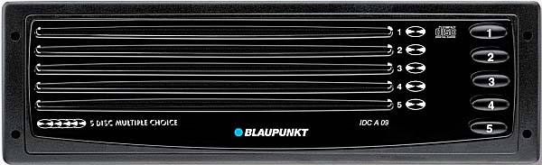

You sure it's an IDC-A09? that model doesn't have a magazine, just 5 slots for the 5 CDs.
Although it has no magazine, an error reading anything will show a fault that the head unit will interpret as "no magazine". Same connection can be used for the 10-disc unit with a magazine, head unit doesn't know what's on the other end.
