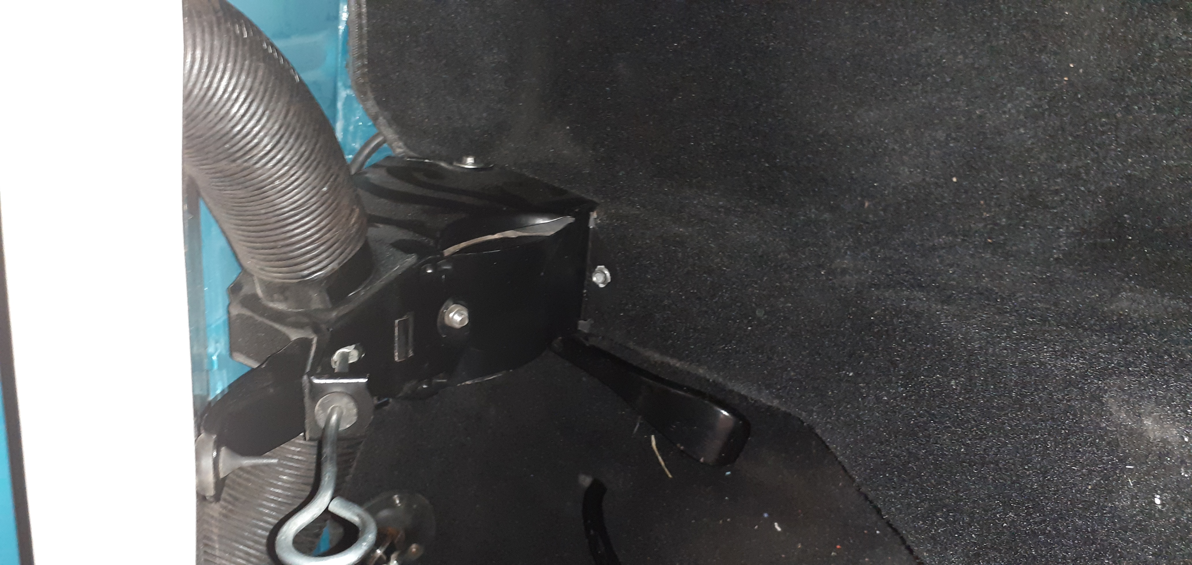

Hi I've just purchased a 1970 Seat 600E which I believe is the same as the Fiat. My first problem is I cant get the trunk open. I'm thinking the lever in the centre under the dash is the release but fully pulled no joy. Anyone any ideas how I can open it without wreaking the bonnet?
--------------what is the wire pull in the centre under the dash?
Maybe it's to operate the heater flap (the heater relies on hot air from the radiator? being blown up through the centre tunnel).

No. The heater flap is located at the back of the car just underneath the rear passenger seat. This opens a flap the allows air from the rear mounted engine colling radiator to be pumped into the car. As such the 600 has no heater matrix.
It's the control for car or screen for the heater.

What I'm trying to say is that beyond the bonnet release and heater lever and choke lever (behind gear stick on central tunnel) then on my Fiat 600D (LHD use to live in Belgium) I also had an additional (not documented in the English and French Owner's Manuals (which I still have) pull ring/tab that was if I remember correctly link to the top of the accelerator cable.
Suggest you get your head under the dash and under the lower parcel shelf so you can see the top of the accelerator pedal and look for what I'm talking about.

Just had a look, nothing attached to the top of the pedal.
