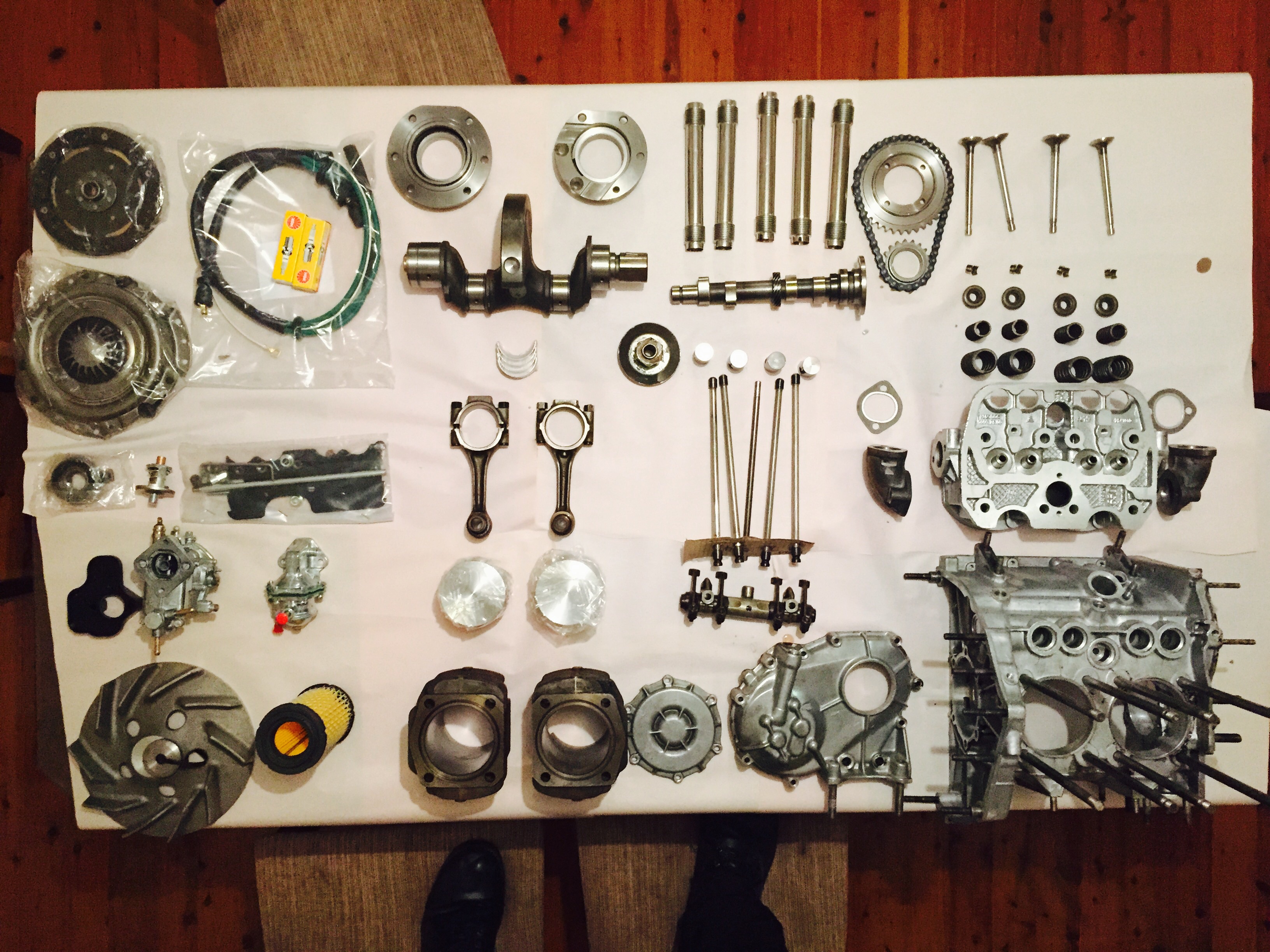

I have finally nearly collected all the parts I need to rebuild the 650 engine so will start post some pics as it progresses.
First pic is sorting the bits out on our dining table

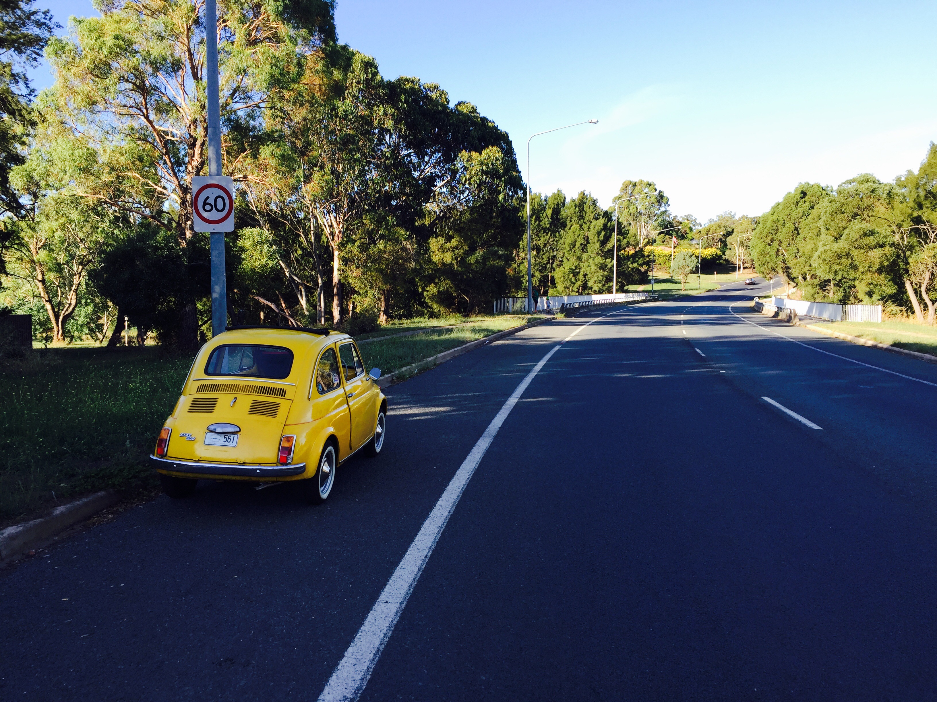

And the car

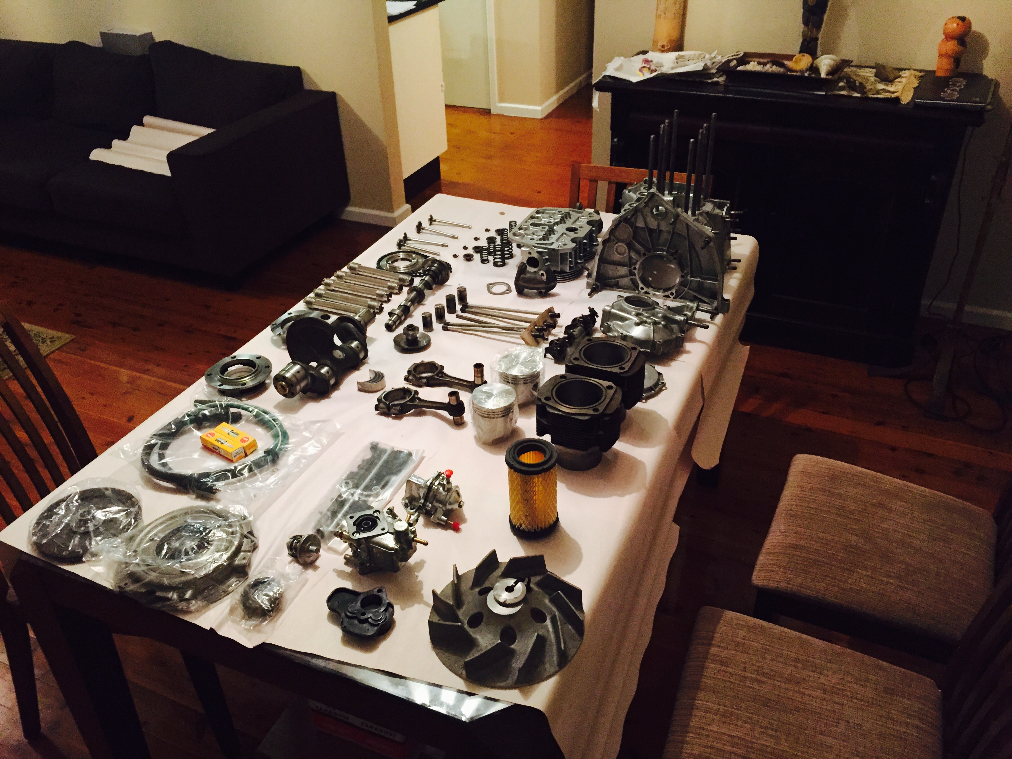

On side... Kind of .... she was on the other side of the world when pic was taken.
Sent the photo to her and got a laugh.
Was too cold to sort parts out in the garage so bought all the boxes inside
Now everything back in boxes but sorted out.
How in heck's name can it be too cold to work in the garage in Canberra--in Australia?! I also have a canal-boat with a 1933 designed/ 1948 built small marine engine pushing it along. When I started to strip it, my garage had no heat, it was November and my wife , when she came out at about 11.00pm to see what I was doing reckons that she could see where I was (lying on my back trying to undo big-end bolt--old marine engines have no removable sump) by where my breath was hanging in the air--I did concede that it was a bit 'nippy'--I had an old jacket on over the overalls!
Seriously though, how cold was it to make you bring everything indoors?--but we are all impressed that you are 'house trained' enough to know that you must always put a table-cloth on under items put onto the ding-room table
Was -3 C that night, but cold is always a relative thing. I spent many colder nights in the garage restoring my 1938 Austin 7 (similar vintage to the canal boat) but when you are sanding panels at least you warm up a bit
Hi 1500500 I am located in Adelaide and am looking to do a 650 rebuild in the future aswell. Any idea what the parts have set you back so far? Cheers!
I have bought a few body bits as well but including postage from Germany and Netherlands
About $2800
five shipments as I researched ( thanks fiat forum ) and found more bits I needed eg didn't realise at first that the last owner still had a 500 head on the 650 barrels so a new head, and everything including exhaust manifolds and brackets all need upgrading
See the list there is not much left of the engine mechanicals that I haven't replaced so pretty good value
I decided to get new crankshaft as the original need machining and standard bearings were cheaper

Good collection of parts! What sump have you got on the engine? I couldn't see 1 on the table, and I can't see 1 in your 'goodies' list. I would recommend that you fit a 3-1/2 litre Ally sump. (a) because it will help the engine run cooler (about 30% more oil in it vis-a-vie a standard sump), and (b) with the 3-1/2 litre sump, it is a simple bolt-on job (with the rubberoid gasket, NOT the cork). On various 'pages' on the forum, I have mentioned, and described, a mod (recommended by Abarth) to the top 2 studs that secure the exhaust brackets to the crank-case. If you can't find it on the forum, e-mail me direct and I will describe it in detail to you.--All the best with the project, keep the pictures coming. Are you going to be allowed to re-build the engine on the dining-room table?

I am planning to keep the engine looking as original as possible so for now thought I would use the original sump. Can always swap later.
For everyday driving I'm assuming that will be ok??

Visited mini friend this morning then popped down to the shops
Car running well
Only just got it back on the road two weeks ago after trying to sort out intermittent electrical ignition fault. I tried an accuspark electronic ignition but with new rotor and cap could not get spark to leads. Also bought new coil. In process of trying to start it the old frayed starter cable broke so I gave up on accuspark, reverted to points and put new cable in. Starts and runs much better than before so for now I'm not touching anything. ( need to keep it all good for imminent return to Michael for his car.).
