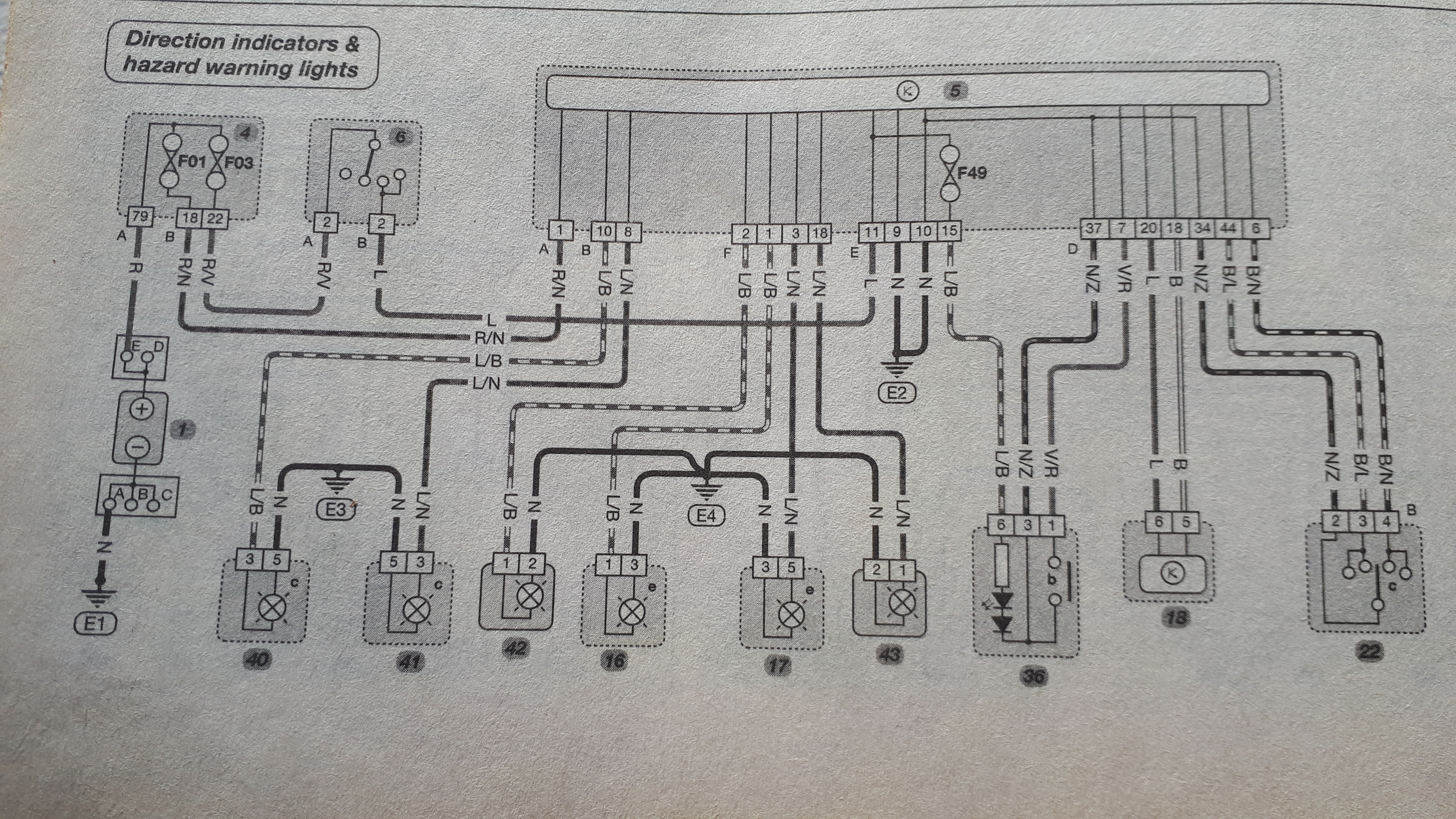

This pic may help
Only fuses I can see are 1 and 3 big ones in under bonnet fuse box and 49 under dash
pin 1,2 and 10 on the fuse box blue with white stripe are the wires to front/rear/side
Many thanks for your help on this, John.
Vehicle electrics are not my strong point but I am going to see if I can work it out from that wiring diagram. The car is booked in for Friday, just in case I can't sort it myself.
