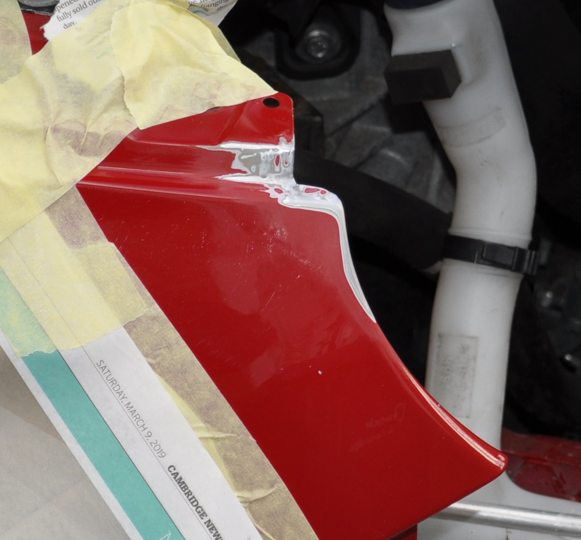

The larger problem though is despite masking a good few inches away from where I was painting, and despite using a fine airbrush spray, the whole panel area back to where the masking tape was got peppered with very fine dusty paint particles.
I did lots of googling and it seems that asking for non-perfect methods of resolving paint problems really sets people off - lots of capital letters everywhere saying DONT and NO and DO and MUST.
Options I can see working might be:
1) Hit it with grease remover, this will definitely 100% take the dust away but it could leave me with an advancing line where I can't get any kind of blend between cleaned and not cleaned, until I end up spoiling the new base coat where it was actually needed. Had this exact problem on the original priming attempt. Perhaps one quick single wipe across the whole area wouldnt ruin it.
2) T-cut the overspray area & new basecoat. This one particularly seems to make people on google really furious, but it would take the dusty stuff off and blend it nicely. I suppose I'd need to wet & dry it before clearcoat though.
3) 2000 grit across the whole area, wash it down then clearcoat.
Here's the problem - you can see the bit I actually painted looks smooth and deep, but outside there is the dusty overspray with a big step shape where the masking tape was. The overspray is very rough to the touch. Didn't think a modelling airgun on such a tight cone would still result in overspray that far out.

Use some g3 or g4 cutting compound after a very light sand and then a good quality polish. That should sort it.
I think you’re being very hard on yourself, you’ve made a cracking job of it. Maybe it would have been better to put a new wing on.
I don’t think you’re ever going to get a perfect finish using diy equipment.
I found something that worked when tested on a small outer bit of overspray - Novus #2 , it's actually for polishing pinball machine playfields which are remarkably similar to car paint in terms of bases & clear over the top. There are different grades, 2 is a fine abrasive, enough to reduce light scratches.

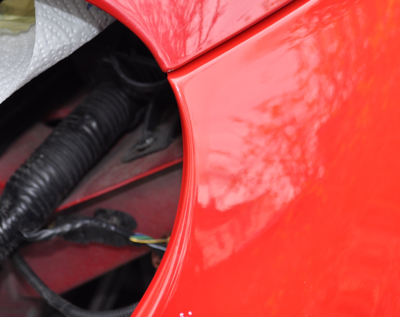

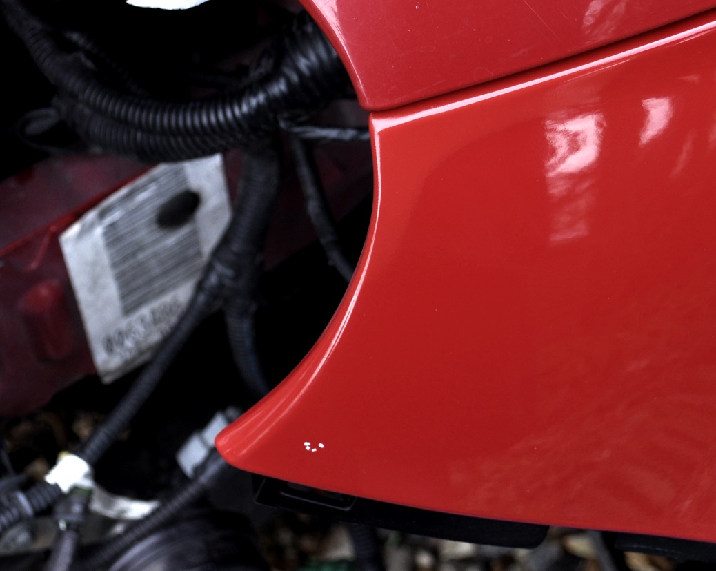

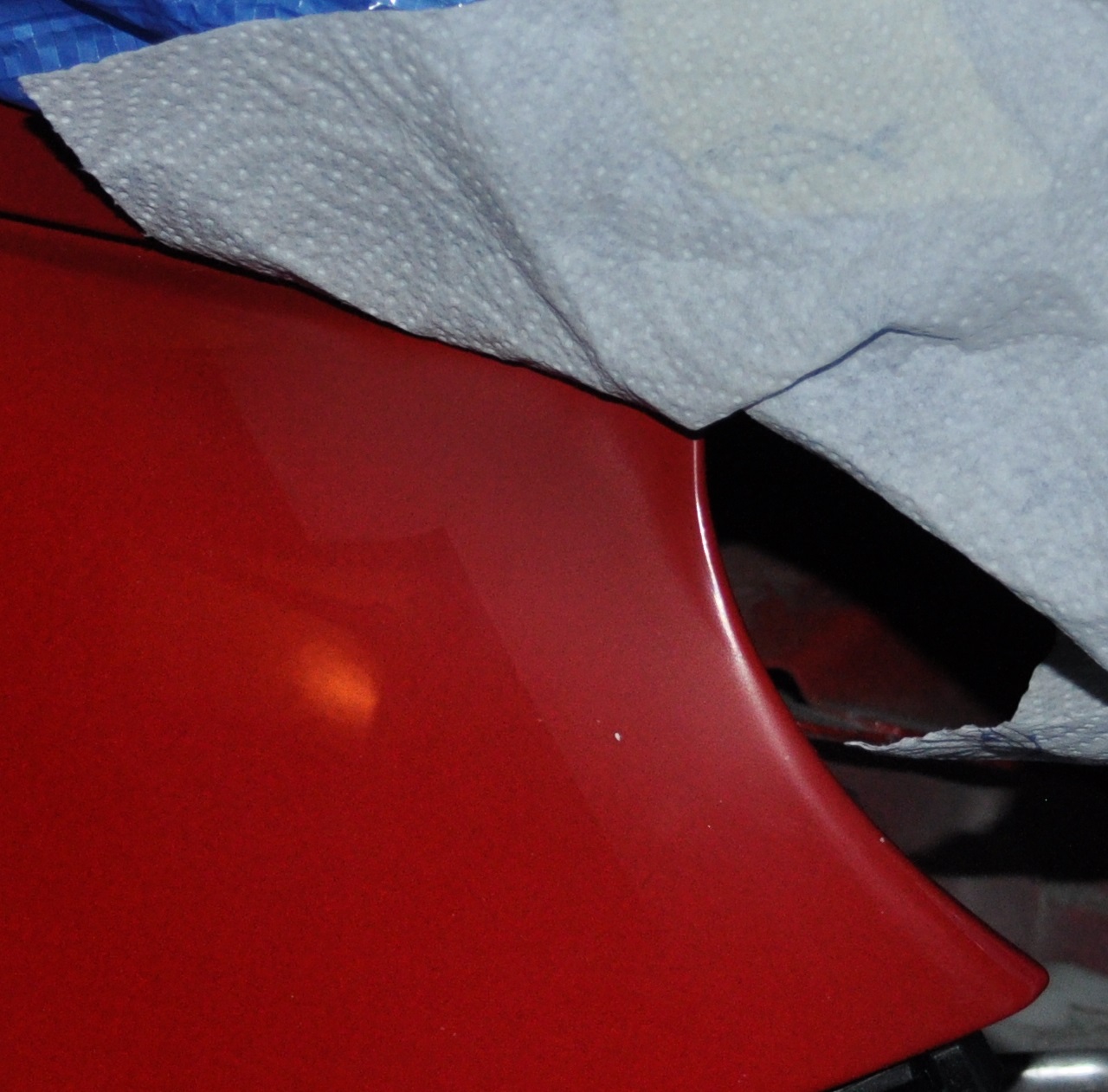

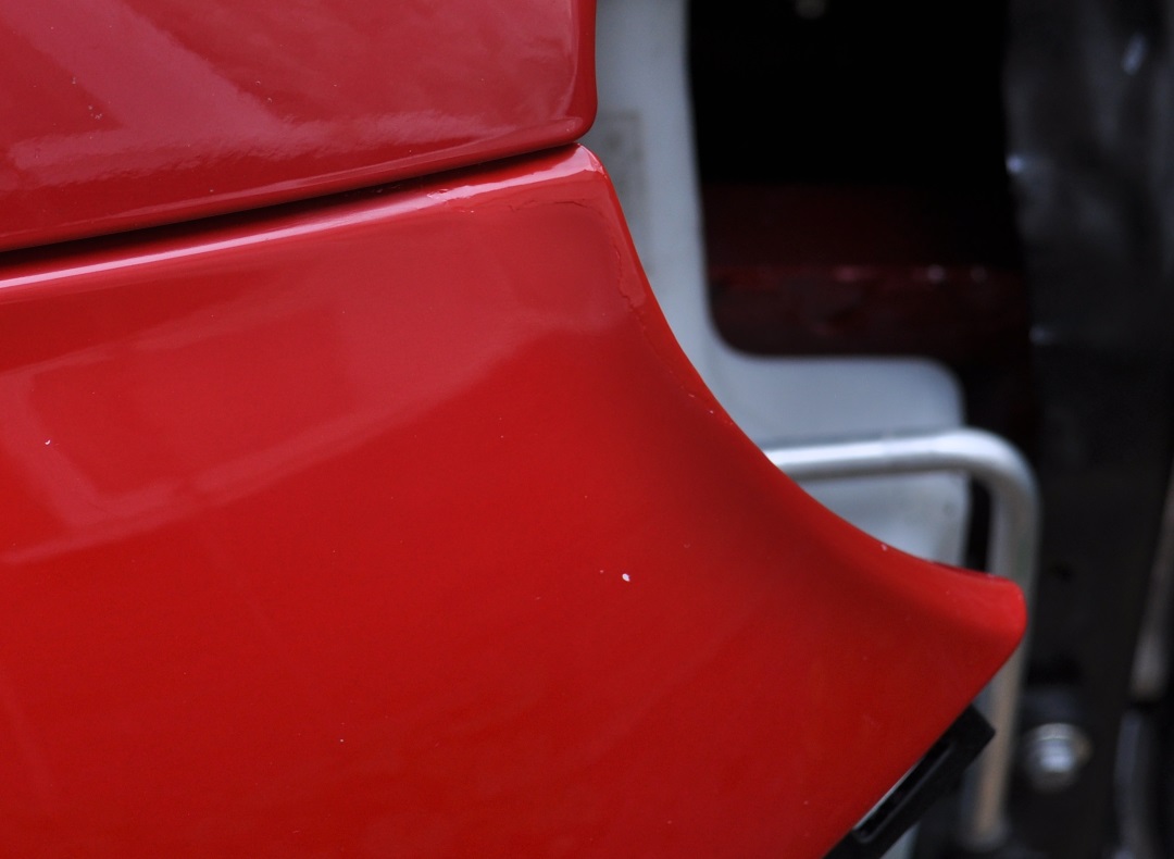

I managed to ruin the driver side and took it all back off - thankfully the degreaser is great for getting back to the beginning. So the passenger side is sprayed & polished, the driver side has been roughly done with a touchup paint (this is getting removed regardless).
Which do you think looks best? Spray version ends up with a visible paint area in a lighter shade, touchup does the same but very localised and a bumpy finish. Driver side has by far the most paint loss.

Didn't like either of them - it's back to bare metal again.

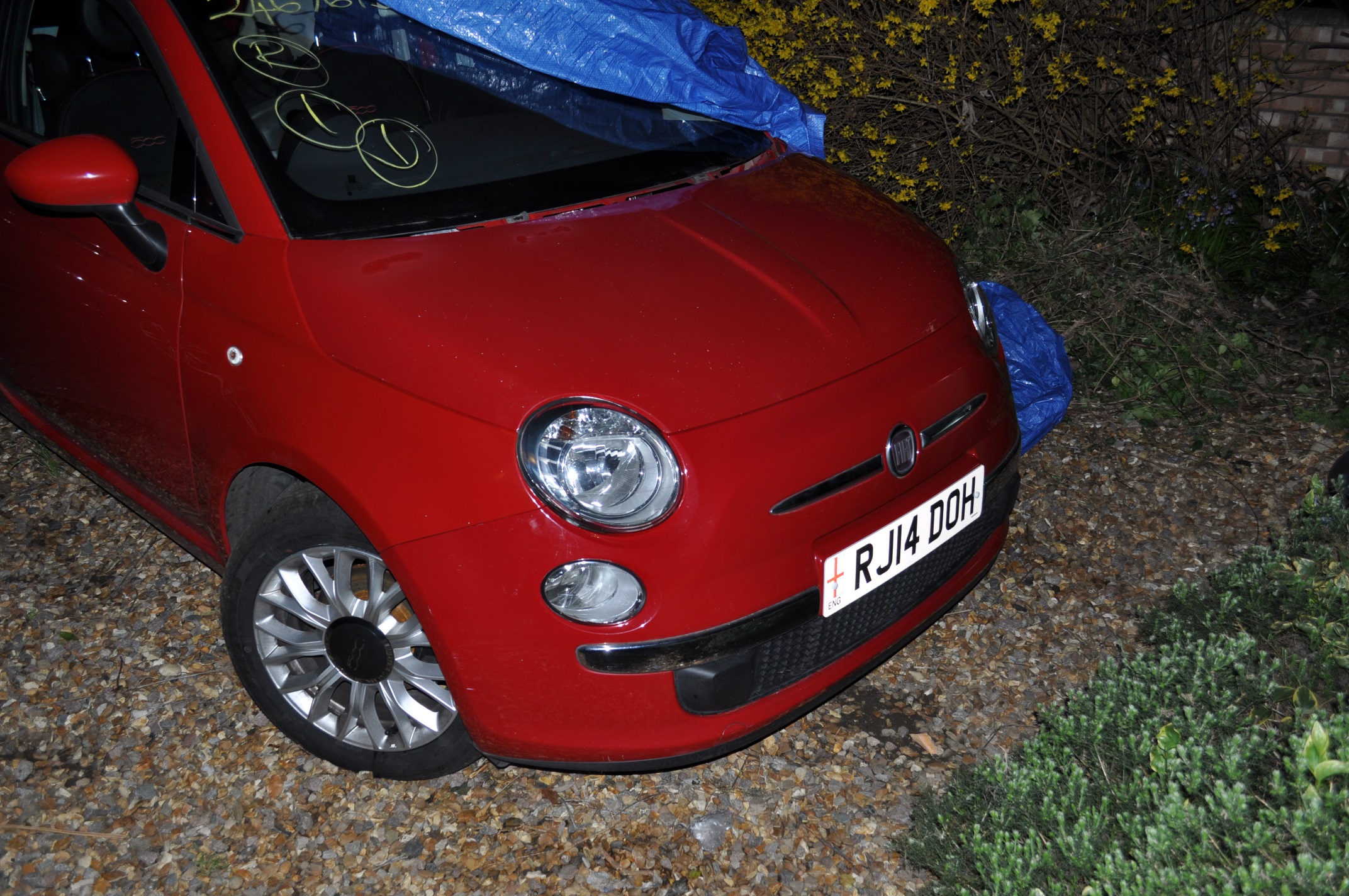

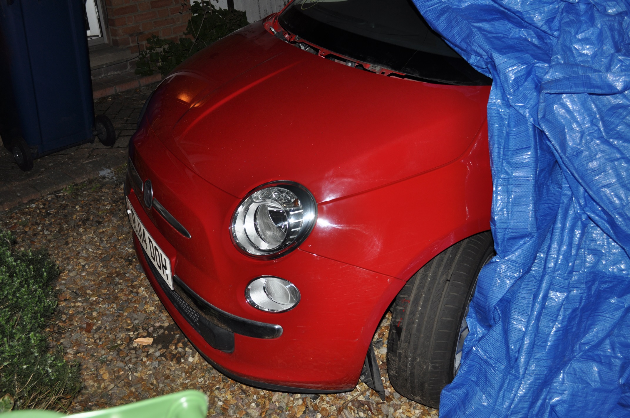

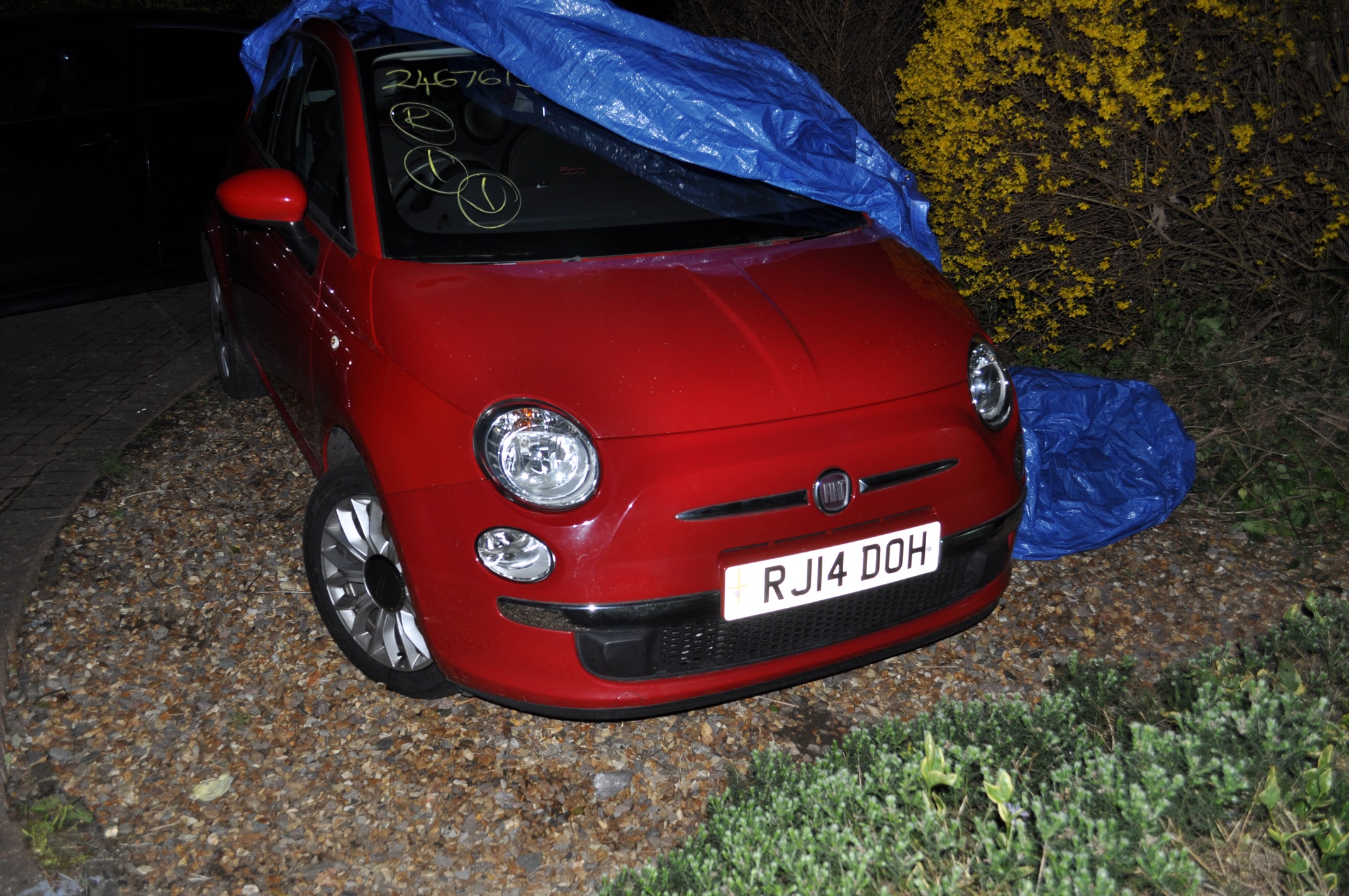

Clipped the front bumper back on today as I'm generally happy with the latest attempt at paint, but....
Electrical problem.
The daylight driving lamp on the driver side doesn't work. As I messed with swapping bulbs and temporarily plugging in different lamp units, I somehow destroyed 4 bulbs. I THINK the problem is when you turn on the main beam, the daylight part of the other lamp blows, on the driver side - could be bad wiring in the new lamp unit?
I've run out of bulbs now, so I'll have to get more tomorrow and see where this goes. I haven't found a helpful fuse map yet. Really hope that it'll just work with 2 new bulbs in there as I don't want to have to take the bumper back off again...
Also I think my slam panel might be a few mm too low, and I'm not sure I have the right bumper bolts - should they securely hold the bumper in place? They seem to have a 'step' in them which is big enough to never clamp down completely on the plastic bumper so you can slide it in/out when they're torqued right down without too much trouble. Do I have the wrong bolts or has the plastic just thinned with age?
Photos taken without bumper to wing bolts installed, or any of the lower bumper bolts and the liners are only partially fitted. You can see on the bonnet where the lacquer got torn off by the tape, I've sprayed some lacquer on the area and made sure it flowed under the edges but it hasn't been polished yet - shouldn't look quite as bad after that but really that bonnet needs repainting. It also needs to move back towards the windscreen on both sides by about 1mm - easy job.
Nice job. The bolts do hold it tight down and it allows for a bit of back and forth movement. I had the same problem with the front panel I’ve just put on. It was too low. Loosened all the bolts and jacked it up, then retightened.
Yeah on this one they aren't holding the bumper tight - I really torqued them up too. There are 'slide' marks which suggest it's been moving around a lot before on the car it came from. I'll see if I can find some 0.3 or 0.5mm thick shim washers of the correct size.
