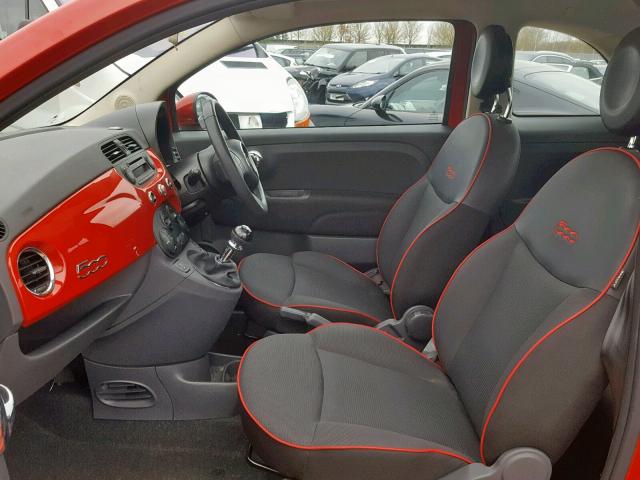

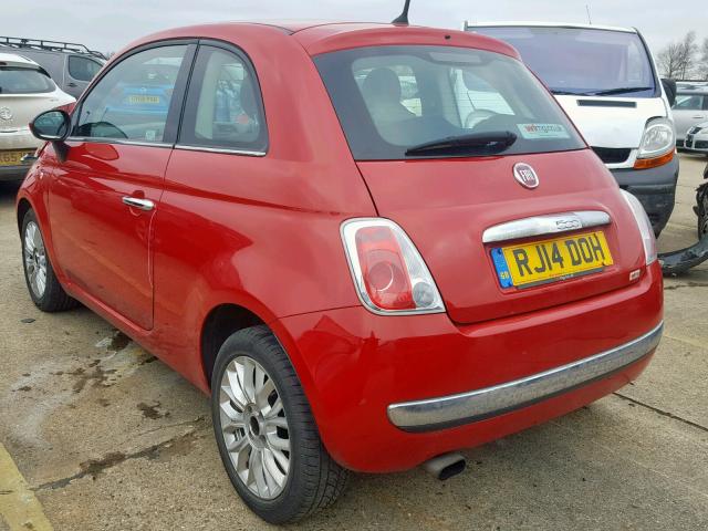

So I went and did something really stupid and won this 2014 Lounge on Copart while stopped at a garage on the way home. After the fees I will have paid too much, looks like the slam panel is toast, at least one but probably both of the radiators and good chance the fan behind with them, headlamps potentially can be staple fixed (mountings snapped), one wing will probably pop out but the other will need some fill or replacement along with the bonnet, hinges and bumper. It apparently does start and drive though.
It's a cat N rather than S so I'm hoping the parts the slam panel are bolted to are straight, looks like it was a very straight hit into the back of an open backed transit or similar, airbags didn't deploy.
When I've got it and start the work I'll try to post a thread with lots of pictures of the journey. It's been about 20 years since I seriously worked on a car, all I can really do is get it, and start taking stuff off until I'm left with things that aren't damaged. At least removing the bumper is going to be really easy since so little of it remains.

Hello and welcome to the forum :wave:.
IMO you dodged a bullet with the yellow one and made a good decision to walk away.
What you've bought looks to me like it should be a straightforward repair. @typecastboy has taken on a number of similar projects, and will no doubt be along soon to point you in the direction of how best to source the parts you'll need.

So, front panels are the same for twin air as the 1.2. If you can salvage the intercooler that will save you a few quid.
Front panel will almost definitely need replacing. New pattern part around £65. The pattern parts are fine. Never had a bad one. You could buy a complete front panel, intercooler, radiator, fan and condenser for around £250. There’s a bloke on eBay in Essex who has one for sale at the moment. At least he did a couple of days ago.
Headlight repair kits can be bought on eBay for £9.99 a side. The lights already have screw holes for mounting. You just have to grind off the old broken lugs.
eBay is without doubt the best source for parts.
If you need any help give me a shout. Try getting quotes for transport on Shiply Don’t use Coparts own delivery as it’s expensive and they just sub it out. I have a bloke I use but he’s based in east London so wouldn’t be economical for me to recommend him. How much are you getting quoted?

I don’t think they deliver on transporters they just sub it out to local one man band outfits. Those transporters in their pictures are used to collect cars not deliver them. I would say you got that for a good price. I would have been prepared to pay more.
You should be able to pick up a wing for about £50-60, bumper around £100-£150. Front panel/rads as mentioned earlier. You should be able to do it all for a few hundred which will be massively under a straight one cost.
