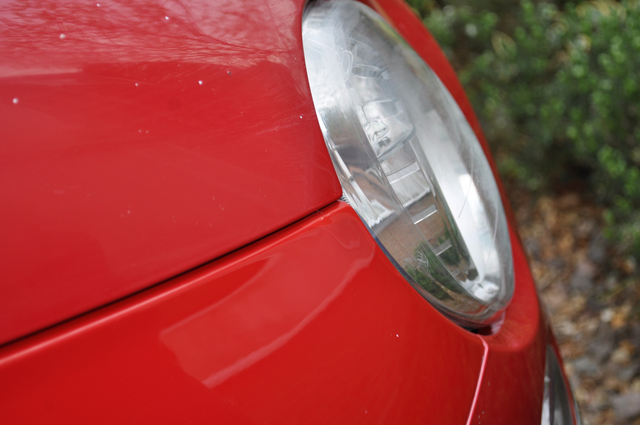

I forgot to post pictures of the wings now I'm happy with them - note first picture is catching a bit of rubbing compound from doing the bonnet that I'd not wiped off properly. If you catch it in the right light you can tell the colour match isn't great and the finish isn't quite as good as it was on the third iteration, but the area repaired is much smaller and I'm happy now, it'll do.
That almost looks like it was when it came out of the factory. Cracking job.

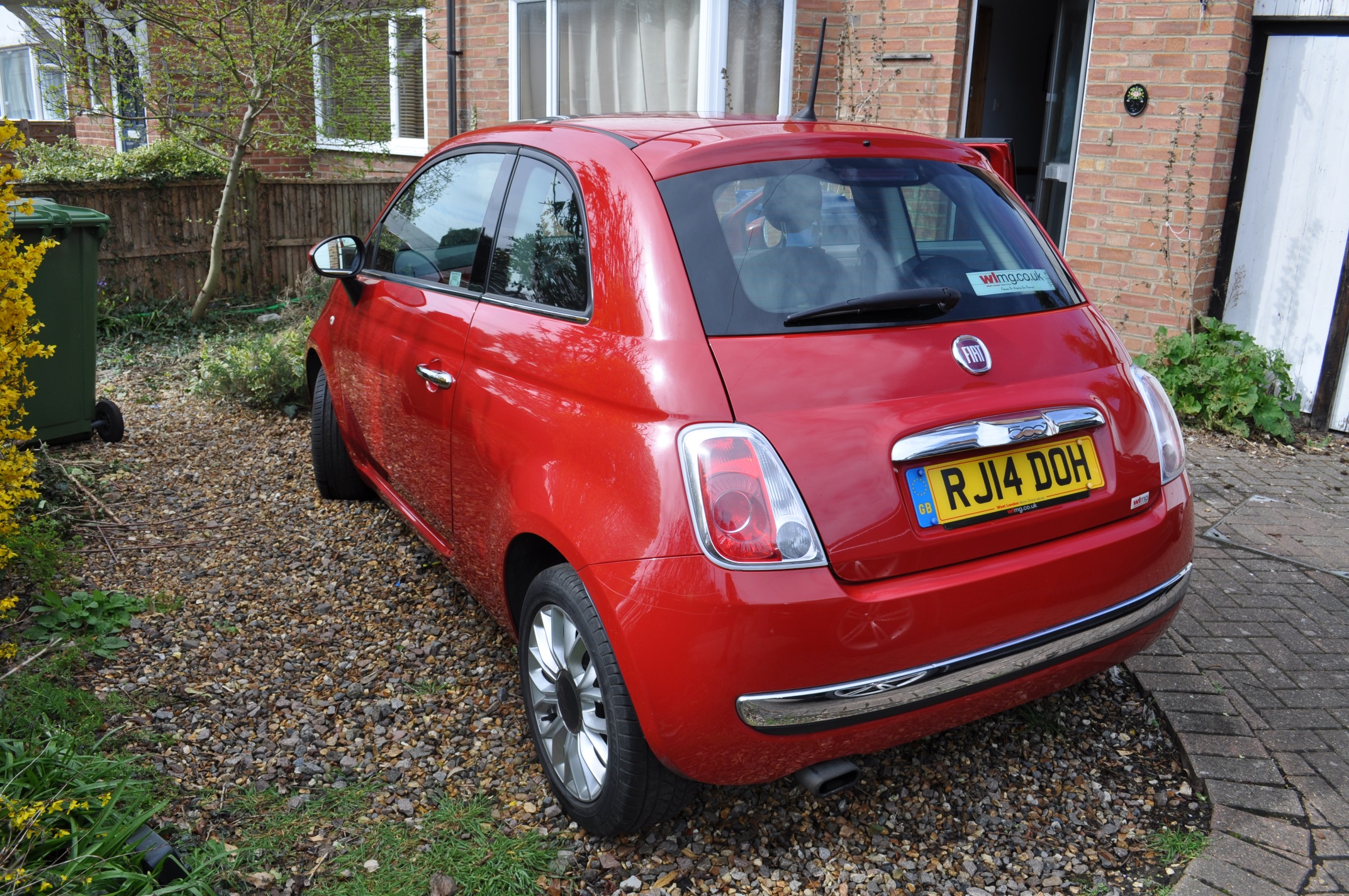

Windscreen is done, gave it a basic quick wash - definitely needs a rub & polish as someone has sprayed black near it at some point and there are specks here and there which come free with gentle persuasion. Wiper blades are fraying at the ends so I'll grab some today. I think a proper MOT might be a good idea if that was missed in January...
Forgot to add the post wash pictures.
