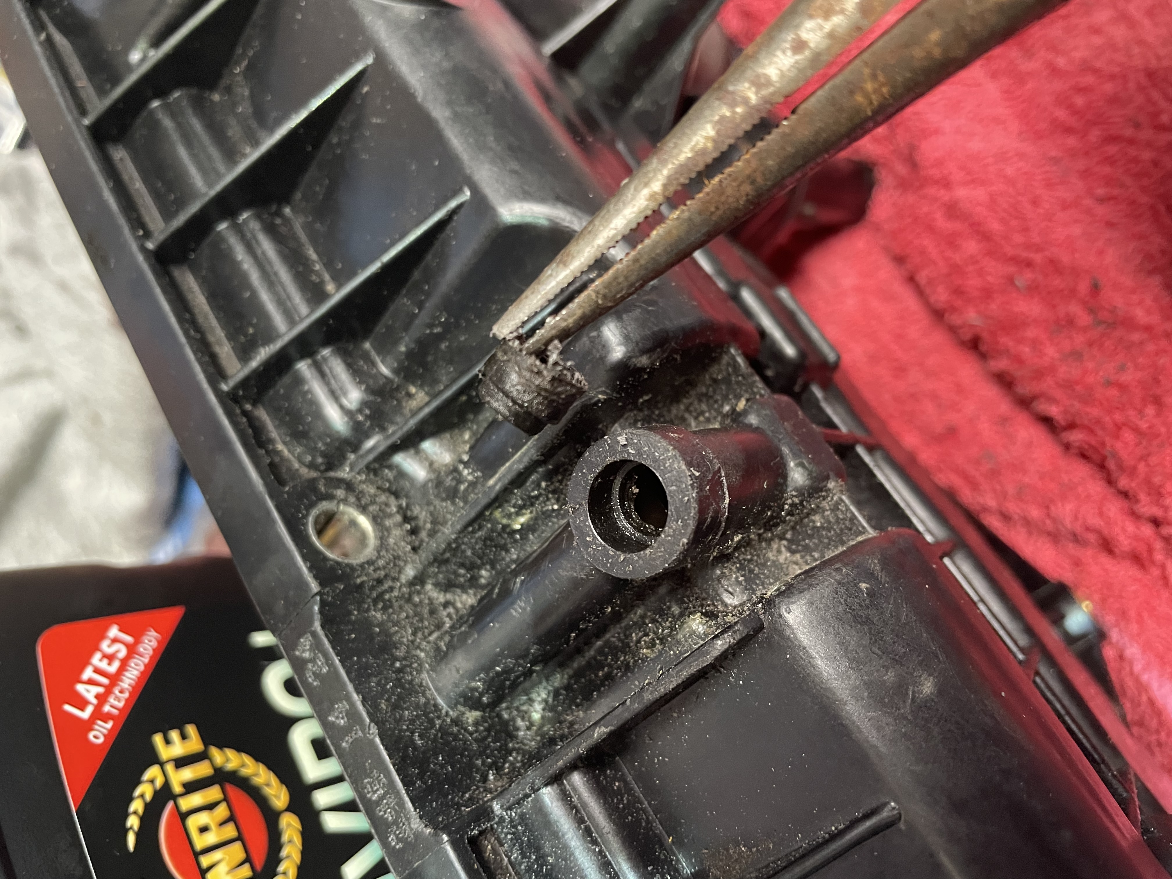

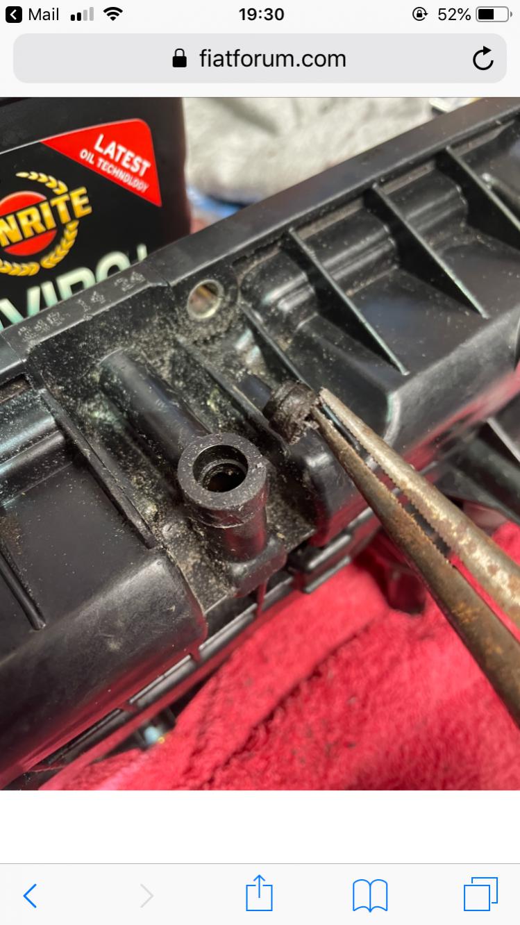

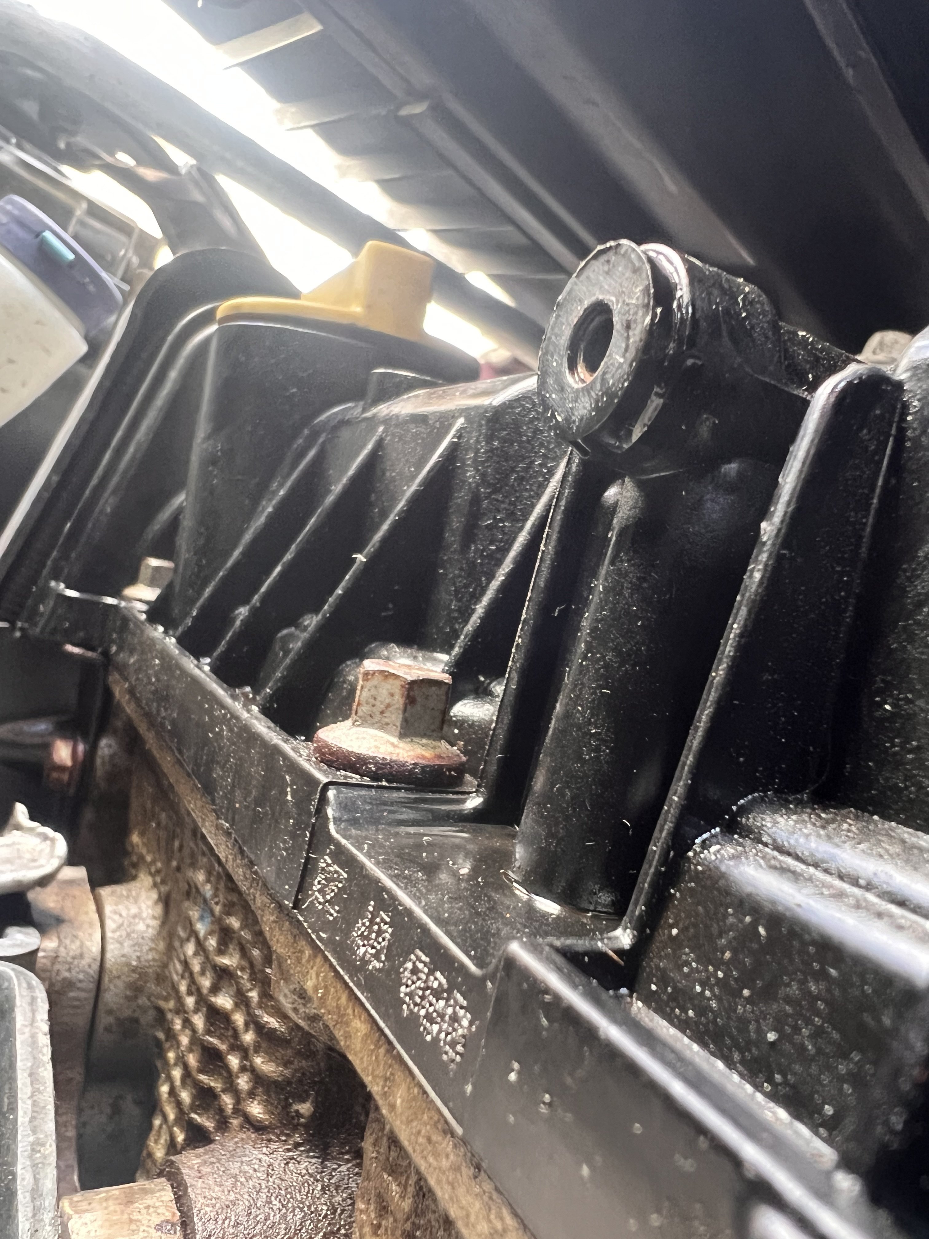

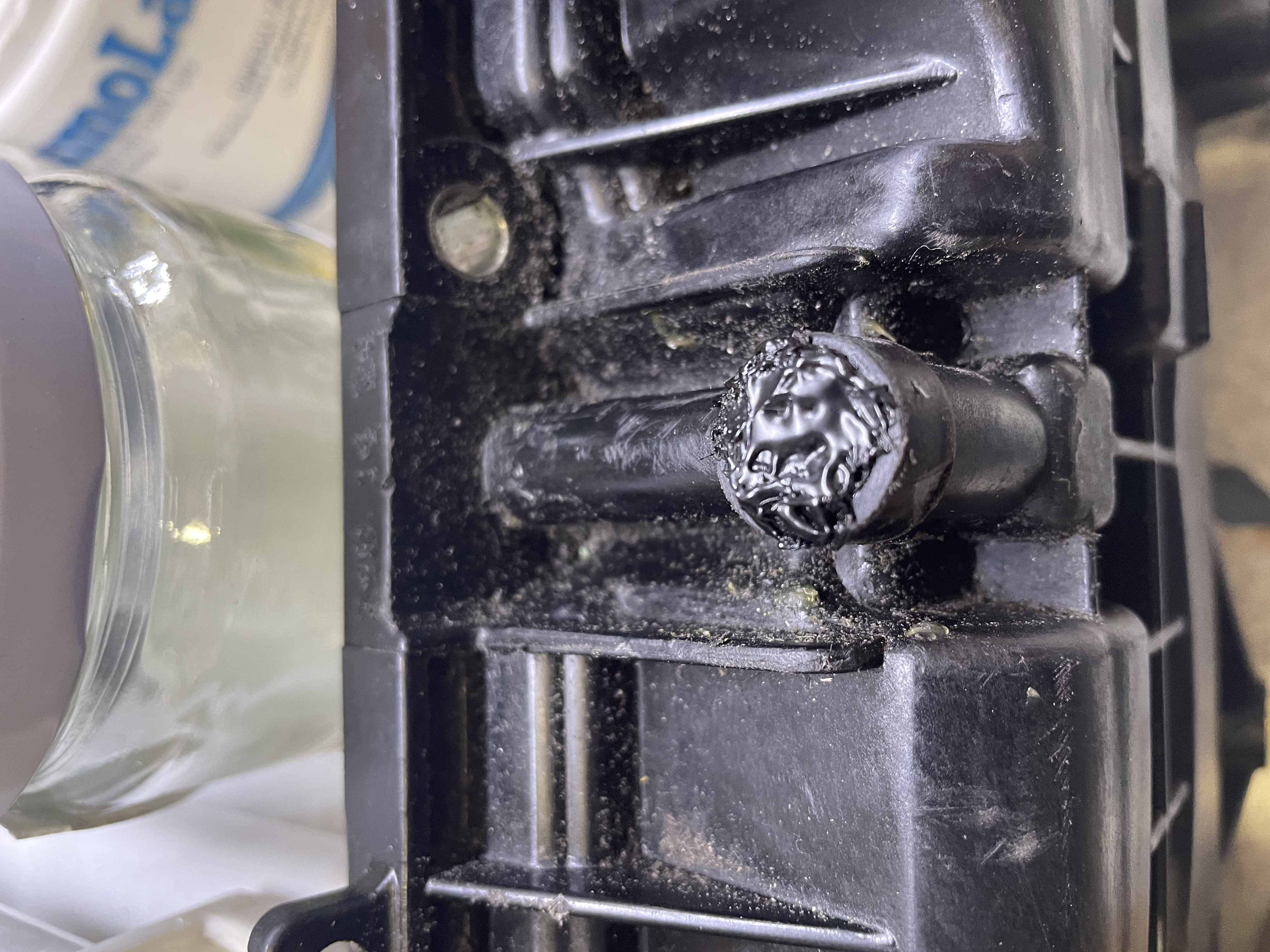

30991695-8E68-4471-ACCE-6DCB8DEDFB67.jpegSo further to my last, I won’t bore you with trying to get help from fiat ……AUS$1400 for a new plastic rocker cover.

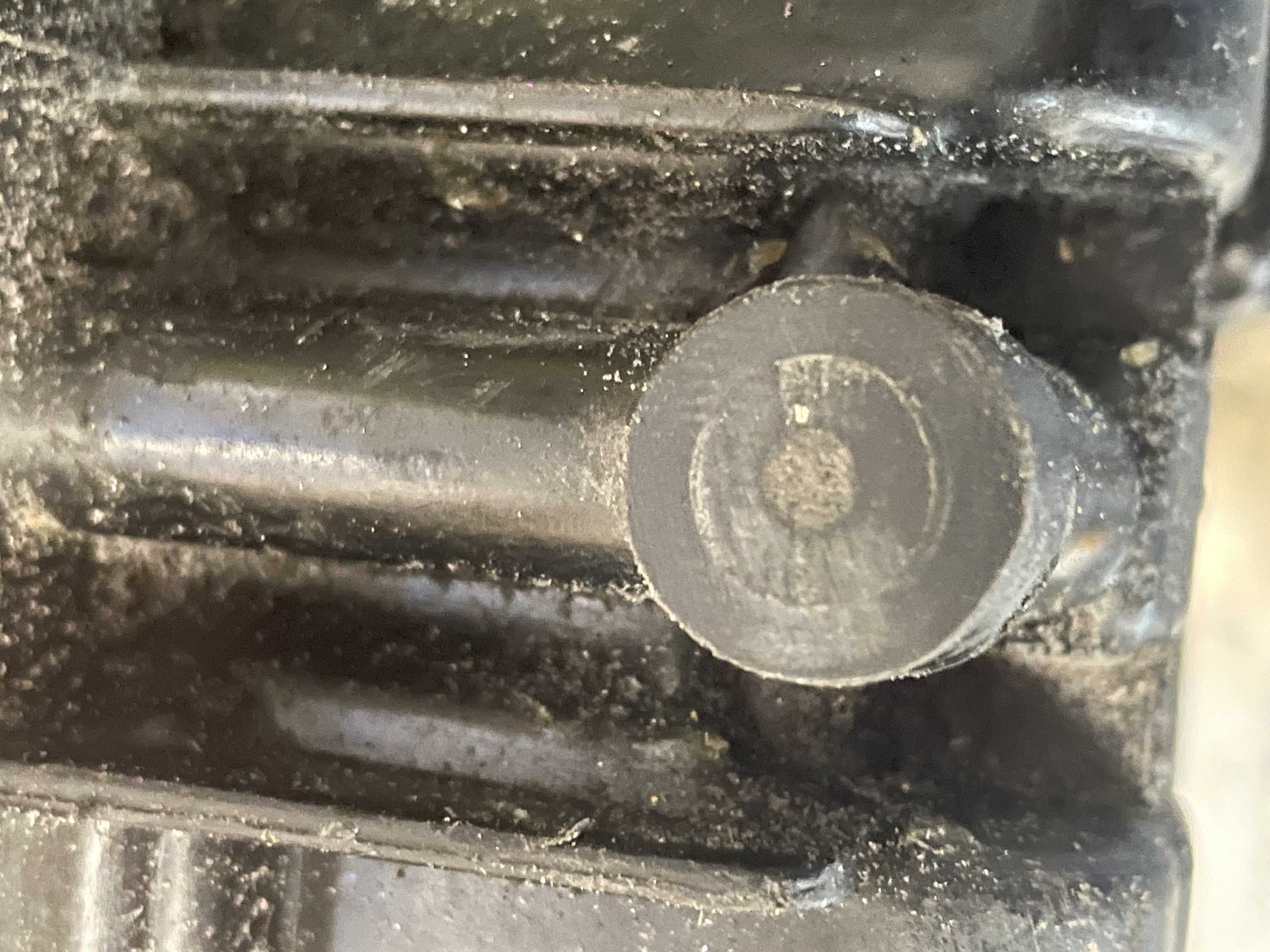

So, I decided to drill the plug out but as soon as the drill grabbed the plug popped out. So I cleaned it up and used a engine gasket sealant on the first half (narrow part) and locktite prism (superglue) on the outer half. That seamed to do the trick but to be sure I plastic welded it together with a soldering iron and quality cable tie (YouTube has videos how). So far so good. Clocked up 200 km with no leaks. [/ATTACH][/ATTACH]
View attachment 220589So further to my last, I won’t bore you with trying to get help from fiat ……AUS$1400 for a new plastic rocker cover.
Even if you got a new rocker surely the problem would/could have happened again!
Well done fixing the issue it will probably last a lot longer than a new one anyway! I just can’t understand why they would use plastic!?! I suppose because it’s cheaper! False economy in the long run!

Look at picture in first post. The valve cover is the black plastic thing at top of photograph.
This one?... do you by any chance have a better picture?

I’m dealing with this exact same issue. I’m curious to know, when you pulled the bung out, does it have a hole through the centre or just a recess on one side?
Same problem, oil leaking from the seal around the bung. Does it pop out without damaging? Or unscrew? Can’t afford £180 for a new cover

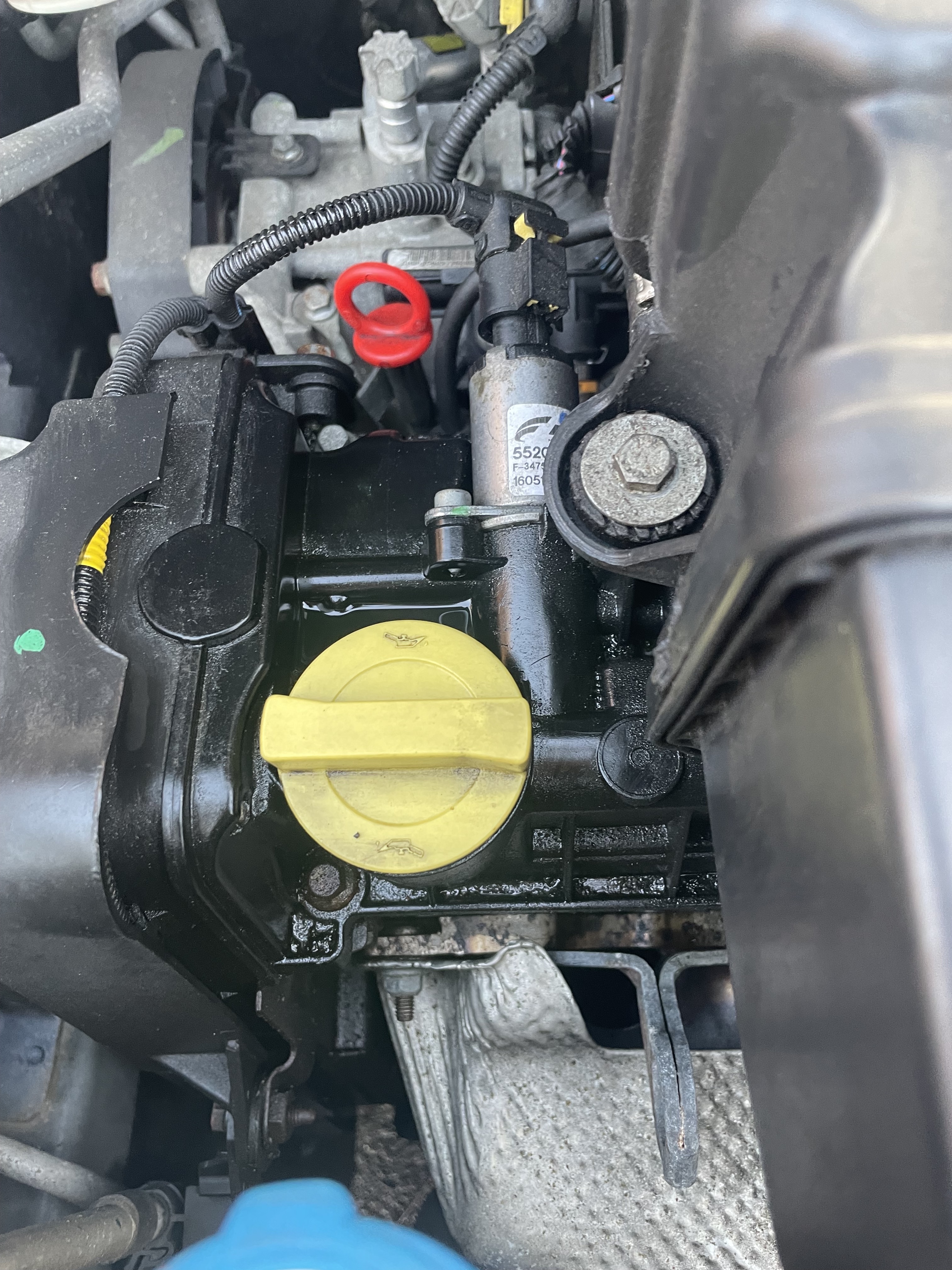

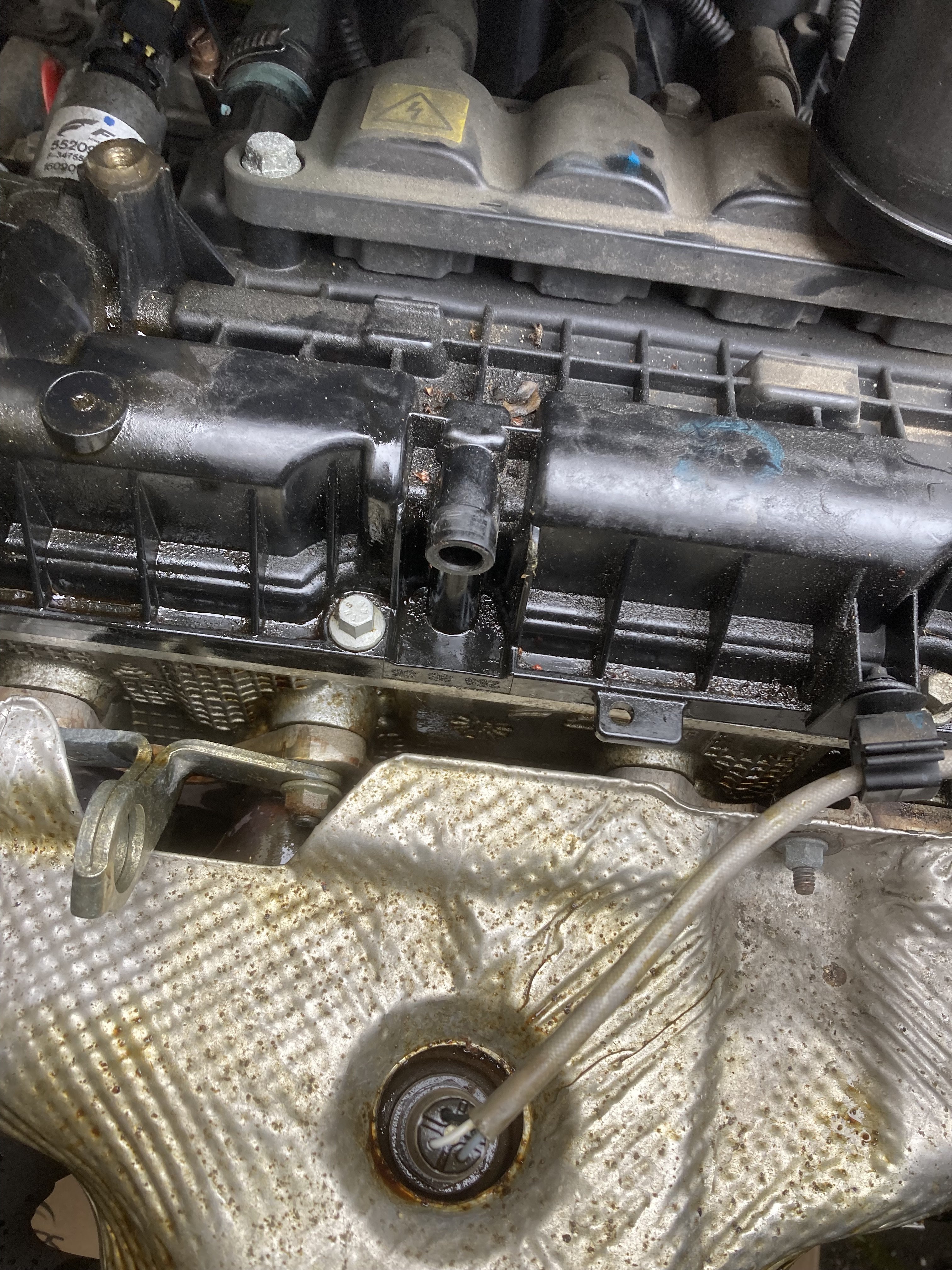

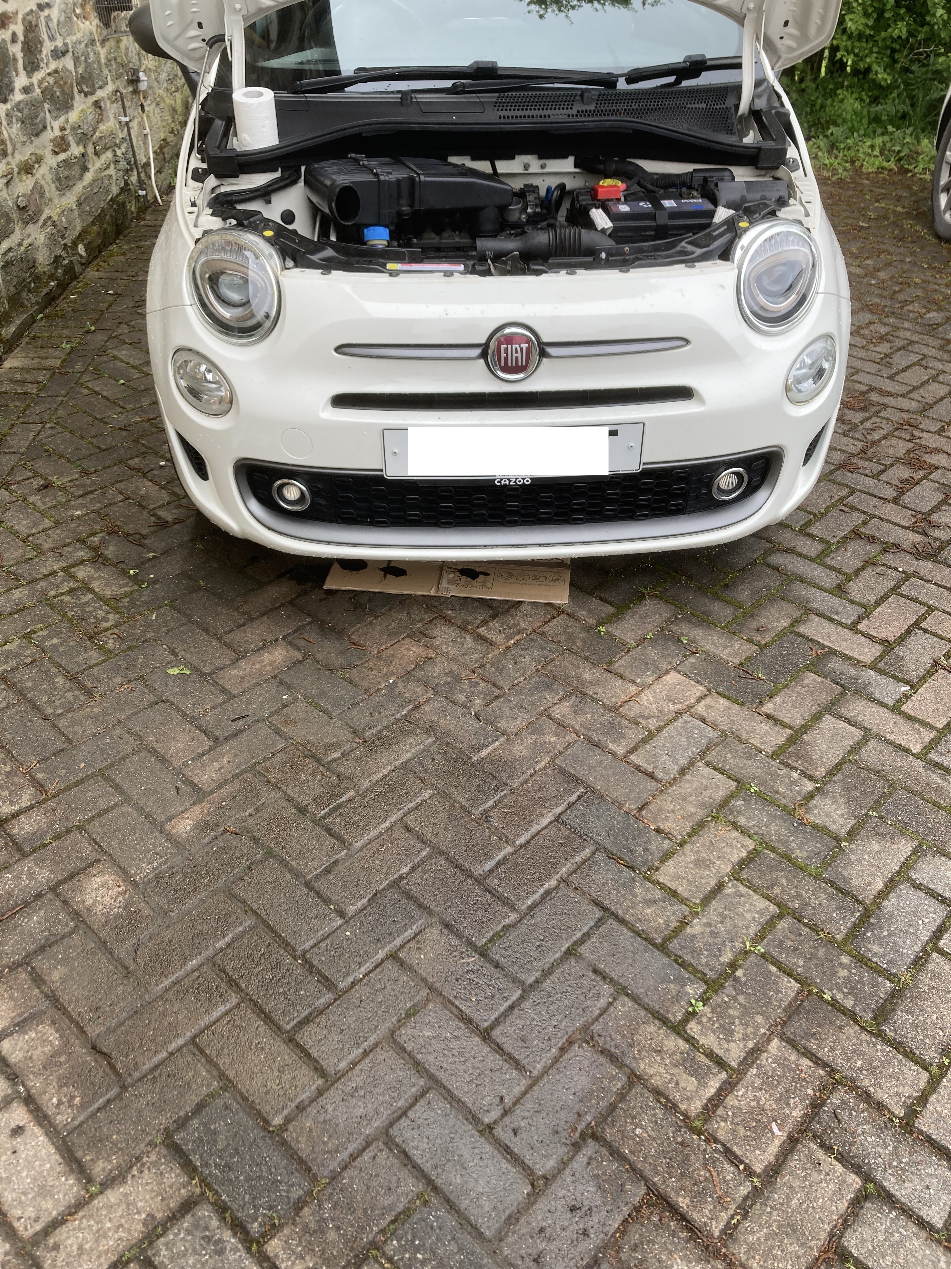

Well fiat are aware of the issue, but it's not a recall. Local dealership said the replacement part is now aluminium. I just went to move ours down the driveway & it failed completely. Luckily, I turned it right off because it drained itself of oil all over the driveway. Still can't find the plastic bung.
I’ve got my mobile mechanic replacing the cam cover on Thursday. So if yours is leaking, I'd just replace it before this happens. I was supposed to be driving to Manchester today from Cornwall, thank goodness I didn't!

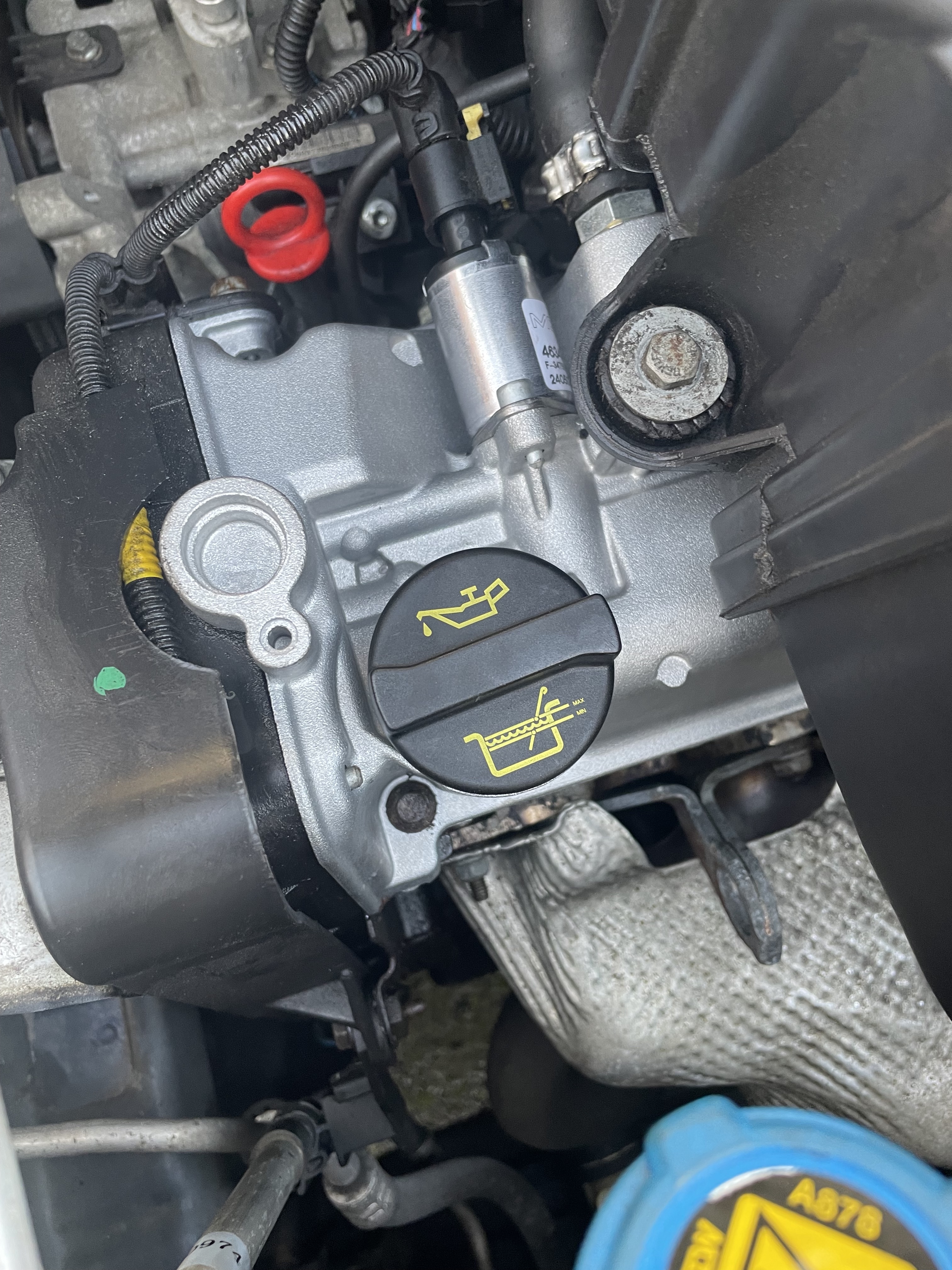

Just to help people along, I have just lived the leaking cam cover bung issue on my 2017 1249 cc fiat 500. It appears you can't buy the plastic cover for this unit now, although they did send an incorrect plastic one as part of the process to sort it. We were also sent an incorrect metal one, so watch out for that. But finally we have the new cam cover fitted. £360ish for the part plus fitting, so not a cheap solution, but it seems OK so far.
