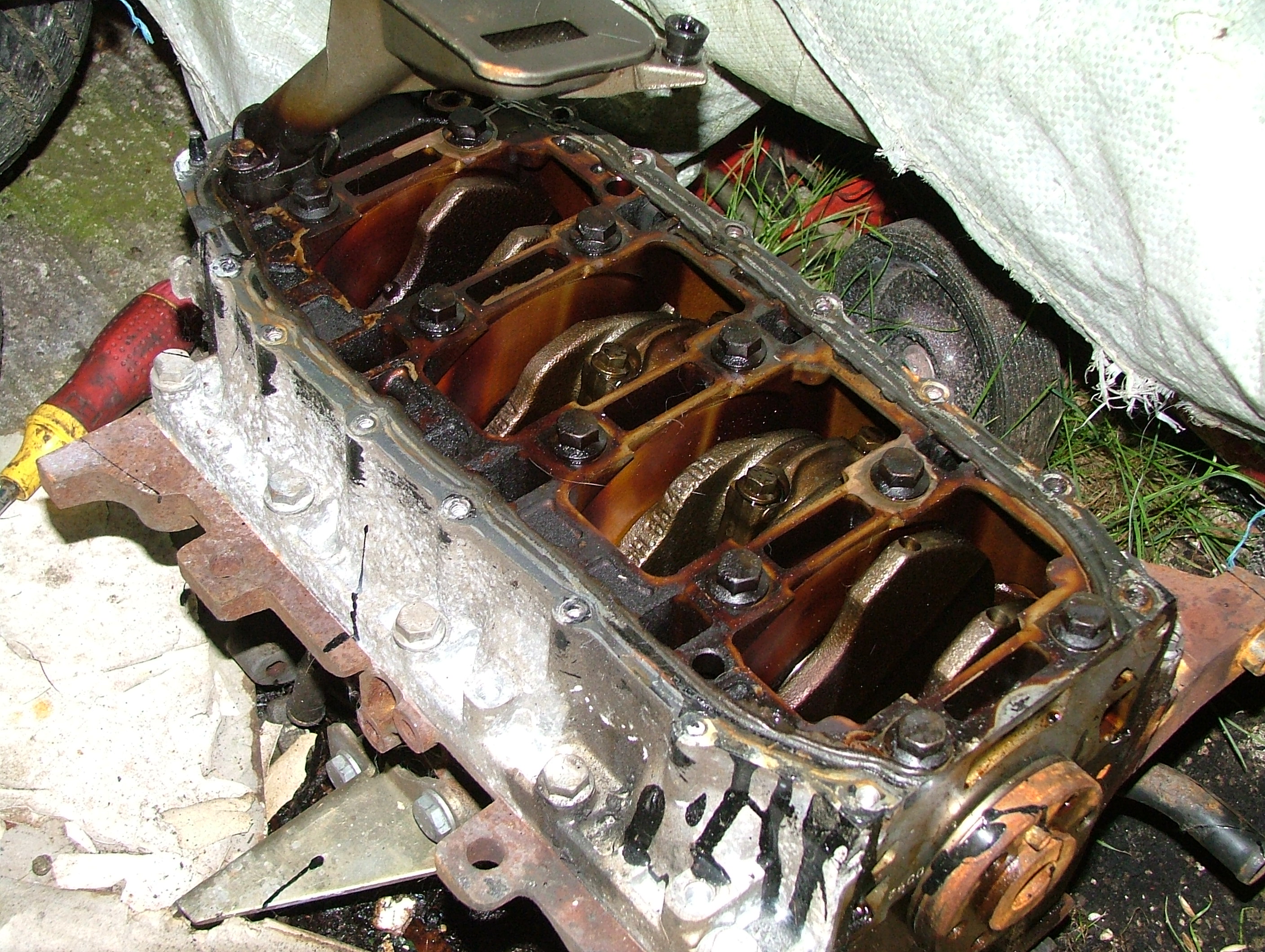

trackdayqueen said:
you can see the cast iron block
I can only see that the block has a different color than the rest, this not necessarily means that it is made of iron i think.
ePER not shows cylinder sleeves/liners for the 1.4, that must mean it is an cast iron block i guess.
I wonder where the false information about the alloy crankcase comes from.
You can also find almost the same wrong text about the 1.4's in the Panda 100HP and Punto 95hp all over the internet.
:bang:
the crank case is the sump extension, that bit is alloy, an that bolts onto the steel block
see like this
the t-jet has a forged crank up rated conrods an difrent pistons to the na 1.4 engines
The paint is a dead giveaway because iron is always painted as otherwise it goes pretty rusty on the outside. You can seen in the pics where there is no paint (around the core plugs etc) that its rusty. Defo cast iron.
good, op probable couldn't understand what the difference between cast iron a steel was either :rolleyes:
you could have also got that same picture out of my gallery as i have just fitted one to my punto
The difference between cast iron and steel is all in the carbon content isn't it? I honestly thought most people would know the difference.
no if an op askes if its steel all they really want to know is is it the hard stuff or the soft stuff.
no need to complicate things for them with over technical stuff that they dont really need to be told.
pick a word they have already used makes it a lot easier for them

Well okay, I understand but I do think its better to give people correct information. It's not that technical really though to say the block is cast iron, the crankcase and head etc are aluminium alloy.
then you have to say if it white or grey cast iron, then you have to explain what the diffrence is and so on....
when all they realy want to know was that it isnt alloy
Is it the same engine block as used in the T-Jet (120/155hp) from the Grande Punto or the Alfa MiTo (1.4TB 155hp) ?
Is this an alloy or steel block ?

Der Block is identisch mit den anderen 1.4 Blöcken. Der Unterschied zwischen dem Turbo- und dem Saugmotor sind die Kurbelwelle, die Pleulstangen (beide besseres Material) und Kolben, welche die Pleullager nach oben verschobem haben, um eine niedrigere Kompression zu erreichen.
Der Haupteil des Block is aus Gusseisen and ist verlängert mit dem Halbschalenträger für die fünf Kurbelwellenlager, welches aus Aluminium ist. Darunter ist die Ölwanne, welche aus Aluminium gefertigt ist.
Das Getriebe der Turbomotoren stammt vom Tipo mit dem Zweilitermotor.
