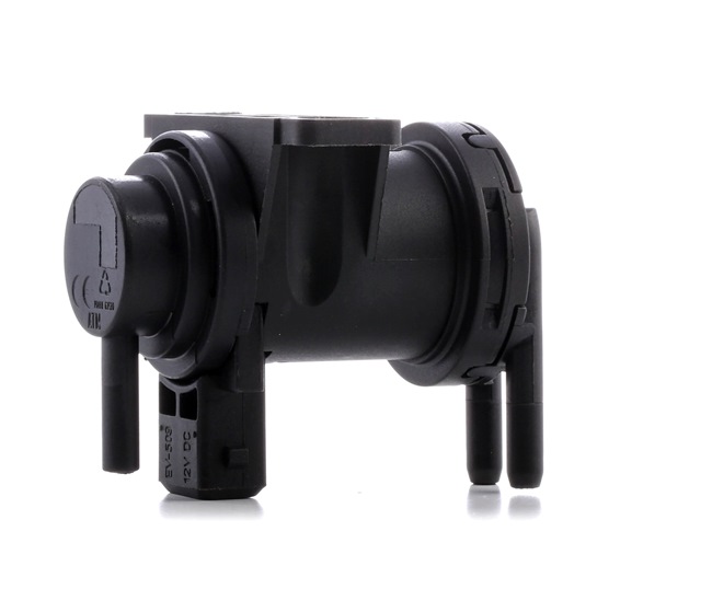

This problem has now been resolved I bought a pressure converter/ exhaust control valve fitted it then scanned with my multiecu scan read and cleared the fault codes and my engine management light has now gone off a good £75 investment was made with the sensor
is this the turbo solenoid valve?
It was the one that sits above the engine on a little scuttle panel and was listed on Autodoc website as pressure converter- exhaust control valve
