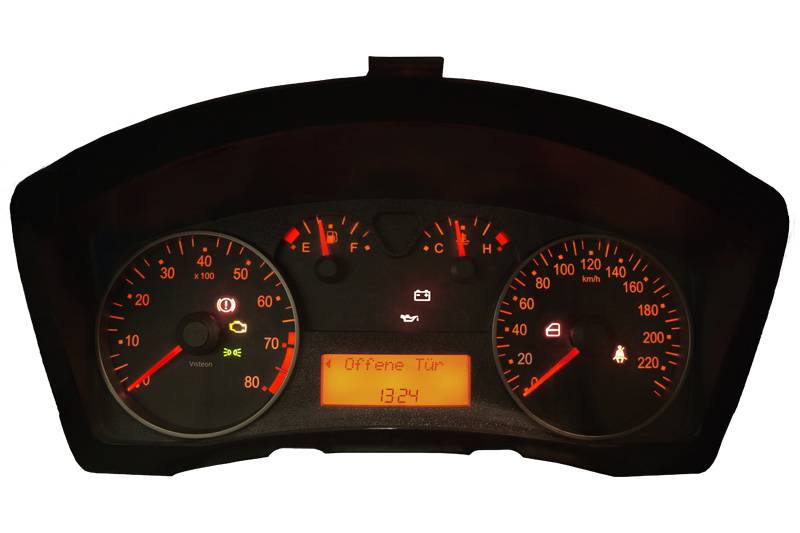

My instrument cluster seems to be on its way out and I was wondering if the newer white instrument clusters can be fitted to a car which originally had the older ones.
I've noticed a few changes between them apart from the colour
- the displays are slightly different
- the needles are slightly different
- the placement of some of the icons is different
Will the newer ones work with my car? Ofc knowing that they have to have the revs for the petrol engine. It's a 2005 1.4

My first cluster was the same as yours ( Picture on the right ).
I bought a abarth display from the scrapyard , just plug and play.
Same with the newer dials. You do need a proxyalligment
