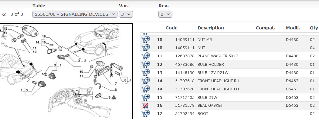

I’ve had my 2004 facelift model Barchetta since new. I’m from the UK but now live in New Zealand. It’s time for the Barchetta to get some TLC and one of the many parts I’m looking to replace is the indicators on the front bumper. Does anyone know if there are different ones for right and left, or are they the same?
Cheers :)
Going by ePer it looks like they're different. I think it's part 14 on the diagram as D6463 indicates post MY 2003:
So part number 51707618 for right hand and 51707620 for left. Autodoc have them in stock as new items.

Thanks Chris! Henk at Barchettaparts seems to think they are the same - I’ll check that with him. Either way, Autodoc are showing no stock as far as I can tell.
No worries, Henk may know that they can fit either way, I'm sure he's seen far more of them than I have! Sorry about Autodoc, I thought I saw they were in stock, my mistake.
