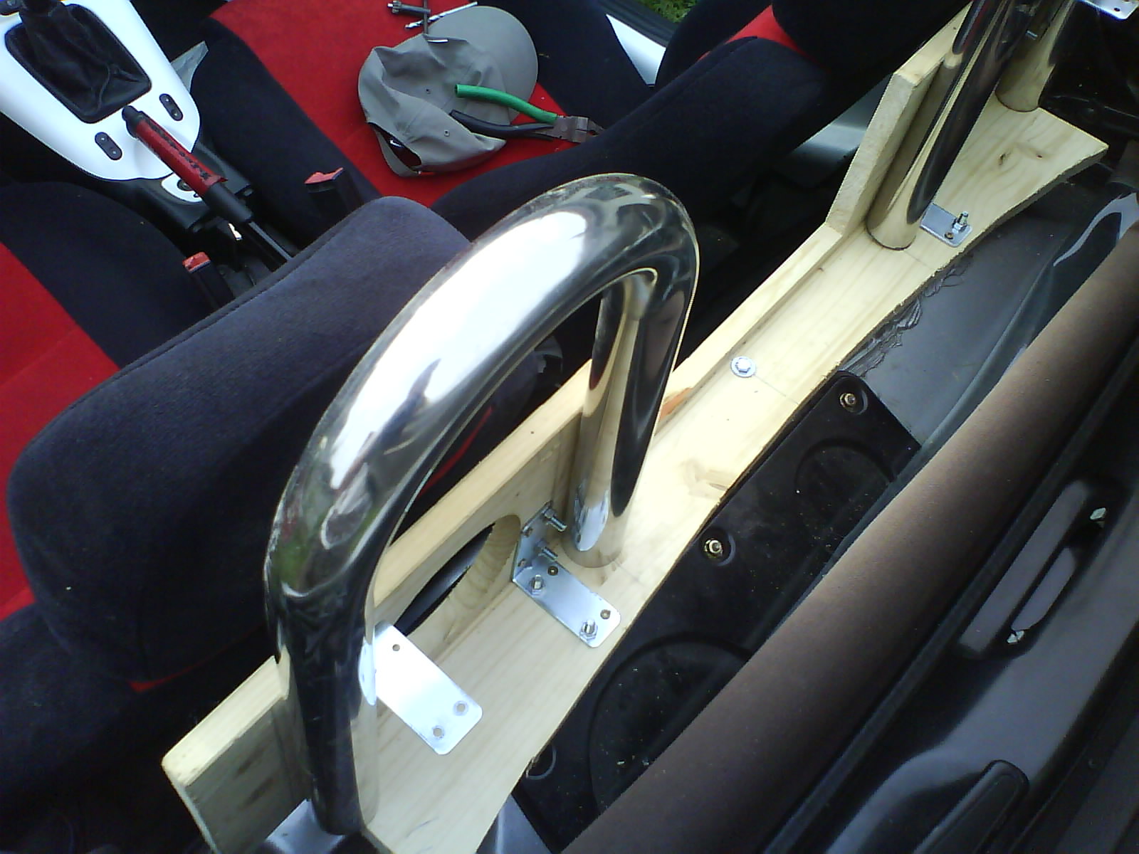

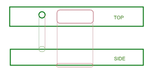

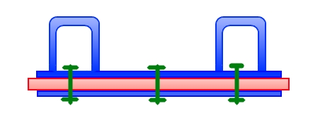

not sure... those existing holes are so hard reachable, probably will drill another ones. this should be very stable and well bolted. and rollbars will be bolted with "U" metal things (second picture). First picture shows bottom of speaker box, red line is metal plate that will press down whole thing.

You know the petrol tank covering (The huge metal plate)
Could you also bring the front of this up through that metal plate? The top of that metal plate, remove the bolts and buy longer ones, then place the bottom of your thing on the top of the metal plate inbetween the body and plating.
This is what I am doing. I also bought some Merc Roll bars as they are not round and look slightly different.
Will post pics when she is done. (y)
yes that metal plate will be used to bolt rollbars, and those "U" metal things will hold speaker box close to rollbars to avoid moving.
here's example what i had in mind; a sandwich plate. that red thing is petrol tank covering plate. it have some holes, but they are hard to reach from the bottom.
right picture shows holes on that metal plate. on top there are small bolt holes and from bottom are huge holes but are moved and are not exactly below bolt holes (only middle one is exactly bellow). you cant put your hand inside.
one way it to create another hole all through and fit it as on first picture.

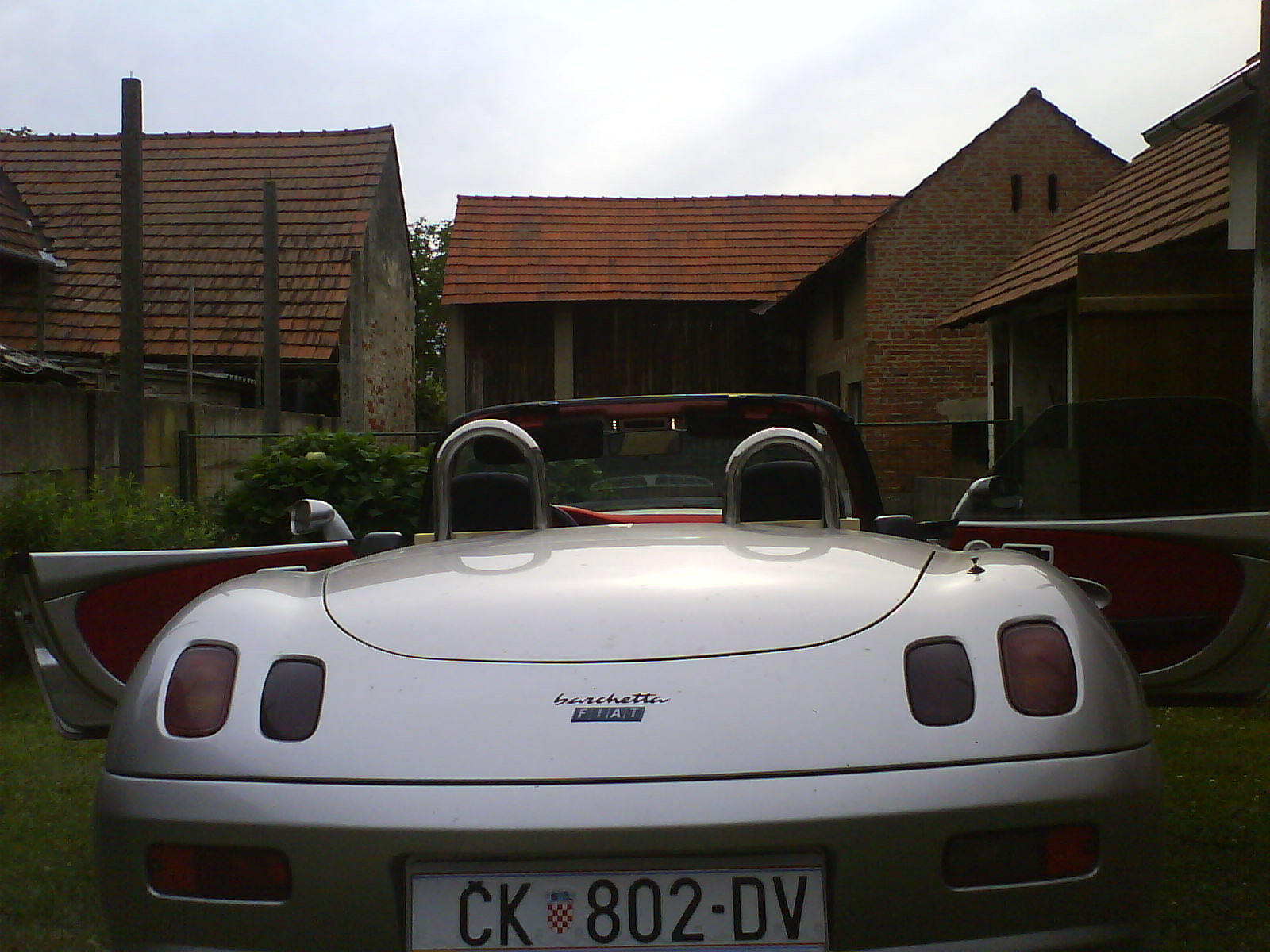

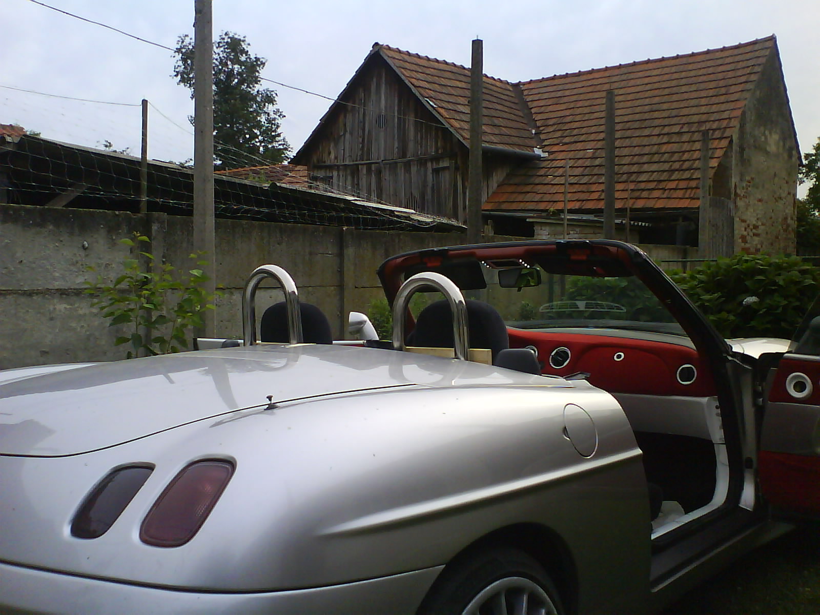

hi. need help about size of rollbars. on first picture, do you think i should lower them? make them smaller... they looks to high even that one i cut. i think they should be aligned with seats... or little higher than seats.

yup i agree with you,, they look better when they are aligned with the seat and the curb is a bit larger. good work though so far!!!
