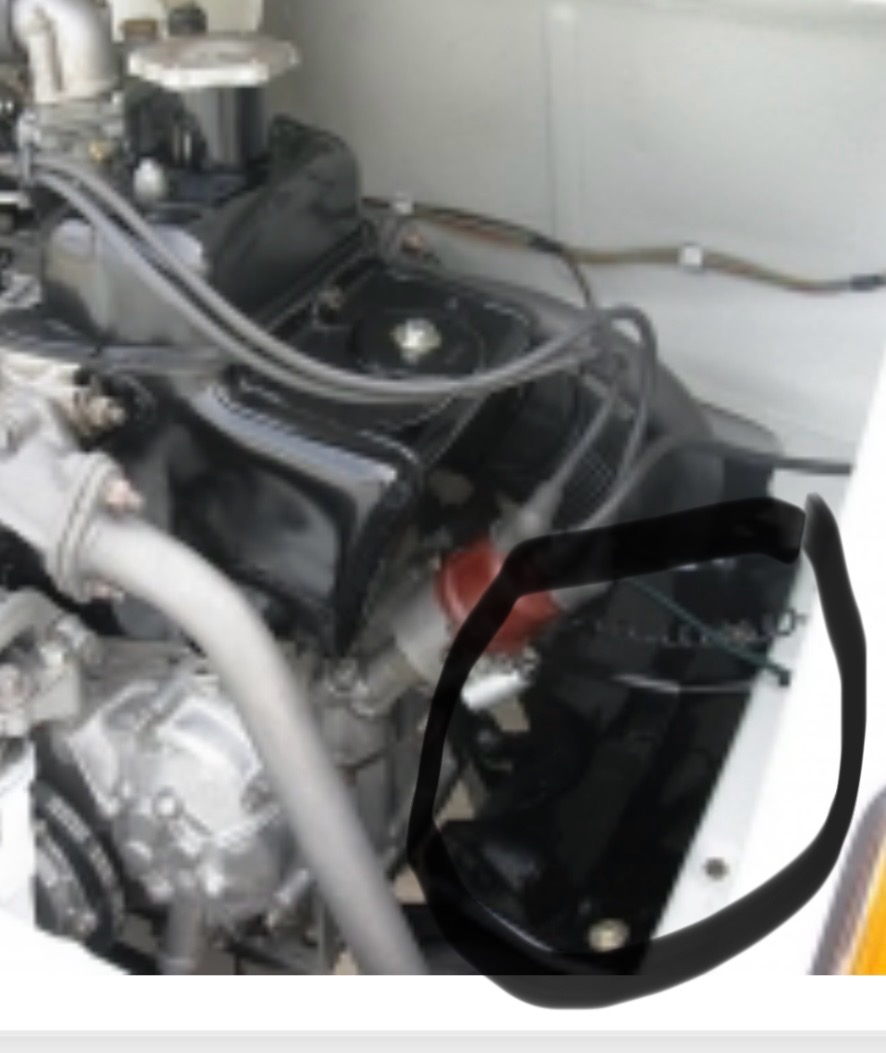

Is the circled part the heat shield. I think my 500 is missing this also.
Yes, that is the heat-shield. There should also be an asbestos (or the modern equivalent) small heat-shield on the engine cover---this one is tp shield the number-plate light and its electrics from the heat of the engine (it is close to the rear-most exhaust 'elbow')
