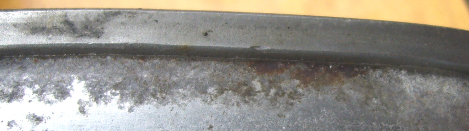

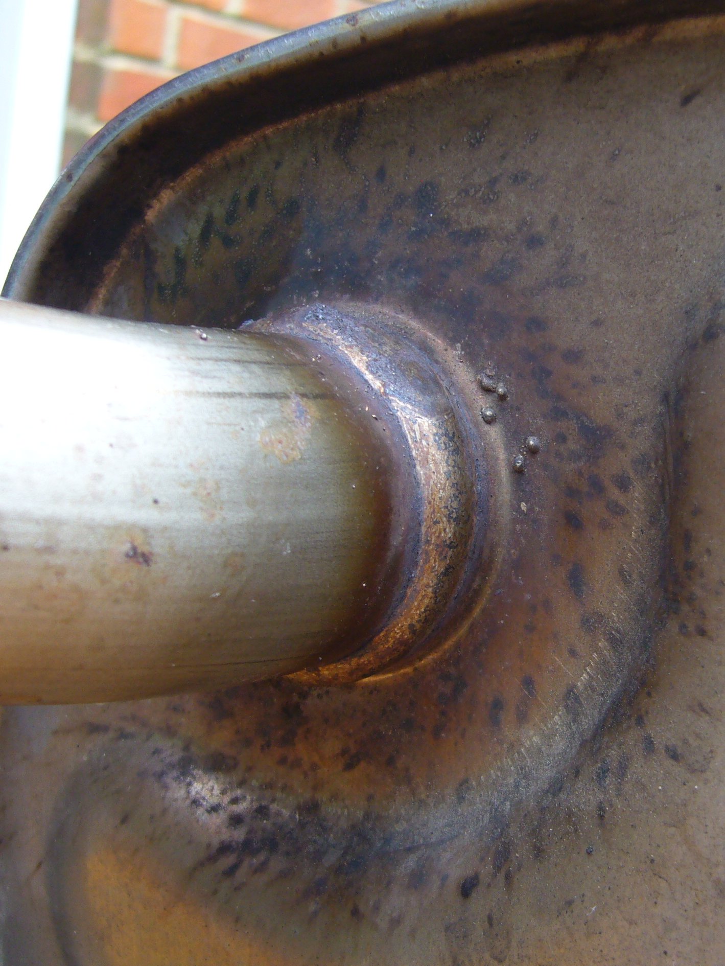

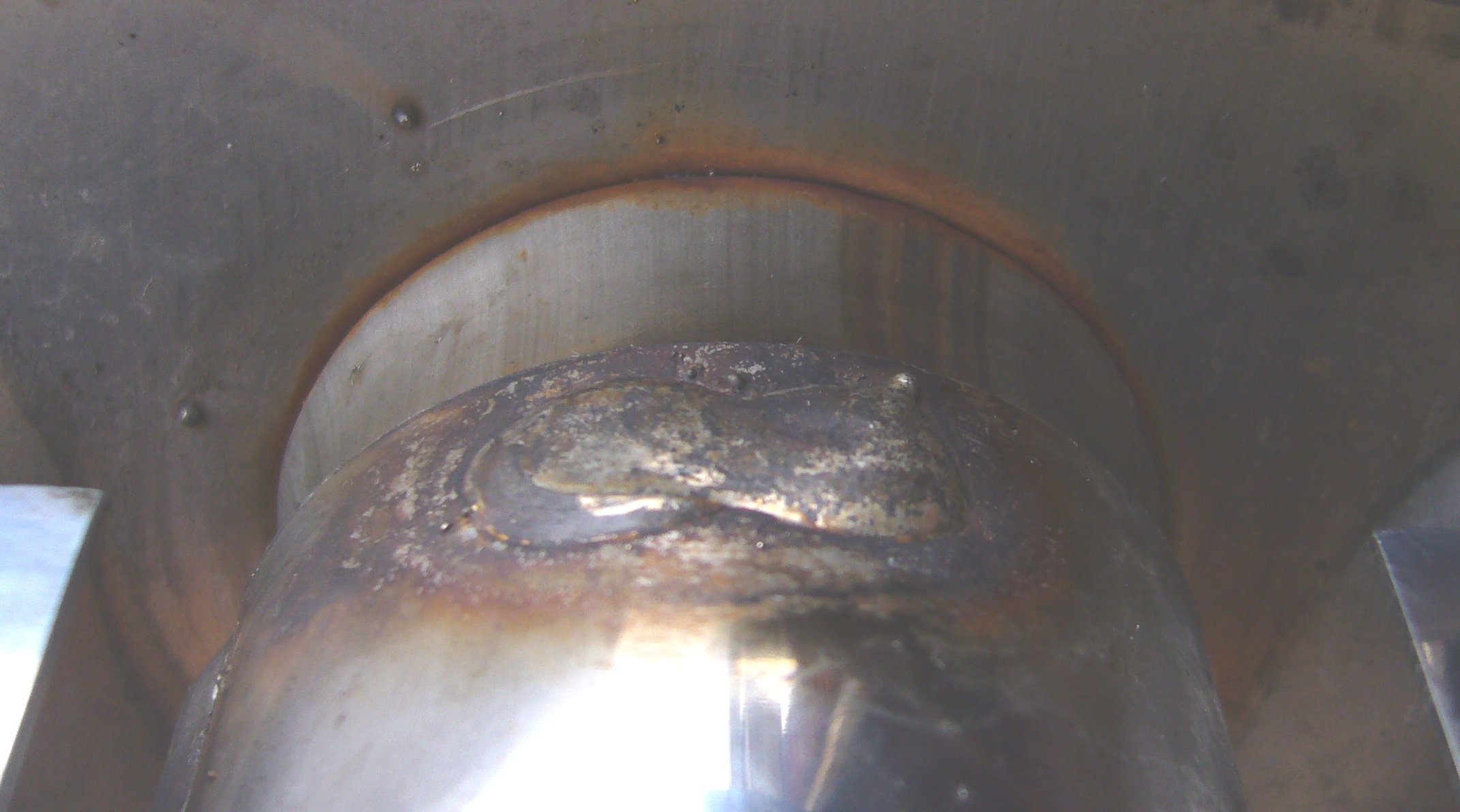

Not on this car, though. I've removed the backbox from an almost new 500 for these photographs.
This car has been garaged since delivery mid March, has done only a few hundred miles and has never been driven in the rain.
Corrosion is already starting around the seams, on the pipes, and on the welds attaching the pipes, hangers and trim. There is no evidence of any kind of protective treatment and without immediate attention I would be surprised if this exhaust would last more than about 18 months in our British climate.
I've left the pictures in high resolution in case anyone is interested in the detail.

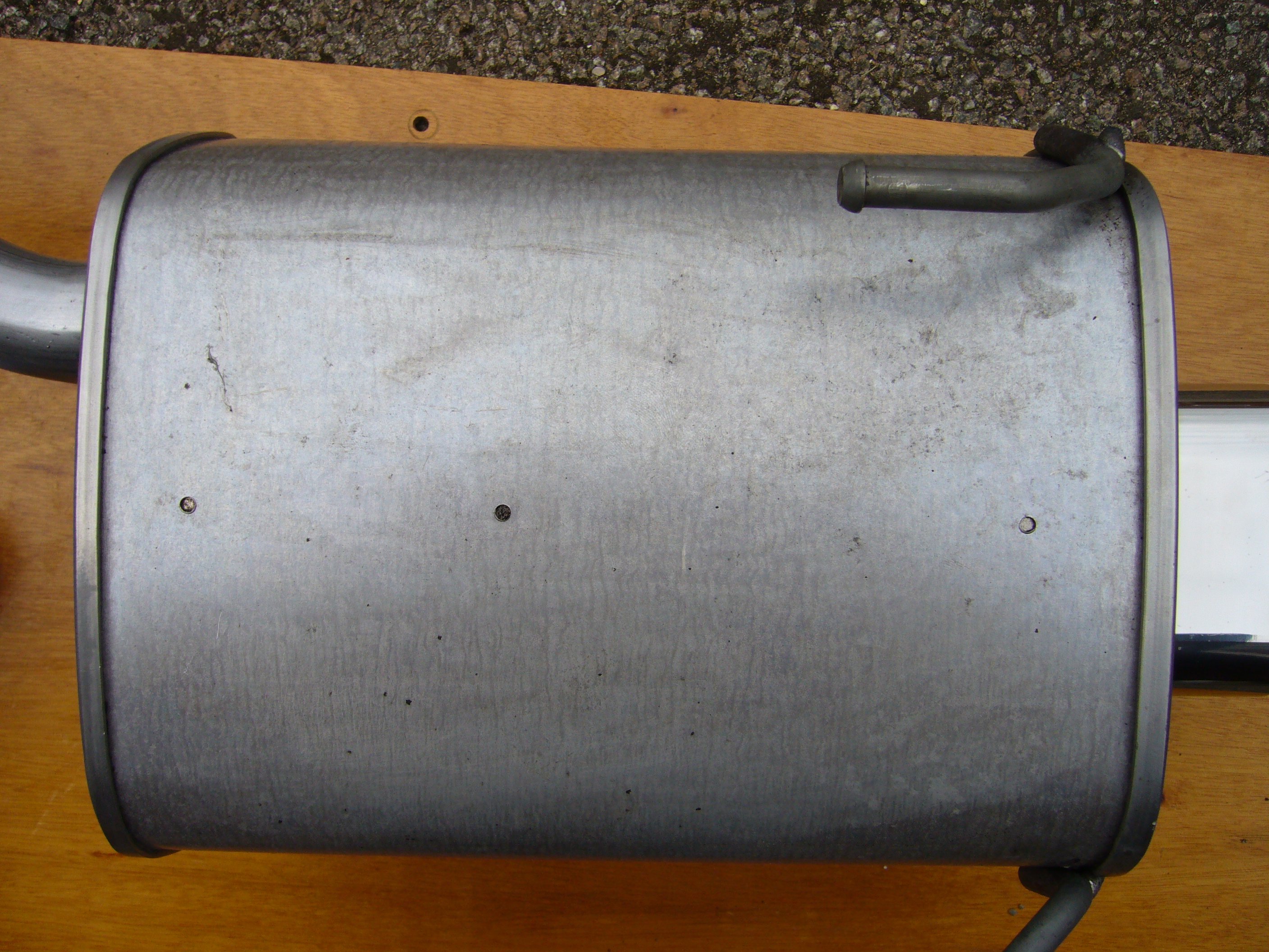

Are you sure it's actually blowing, though? There's an intentional small drainage hole in the lower front of the back box (see attached photo of the one I removed this afternoon from a practically brand new car) and a small amount of exhaust gas will blow out of this hole. You will also likely find a layer of soot around this hole (I'd already cleaned mine off before taking the photo). This is completely normal and won't cause your car to fail an MOT.
However, the extent of the visible corrosion on the seams of your back box is worrying, given the age of your car, and will ultimately lead to perforation and failure.

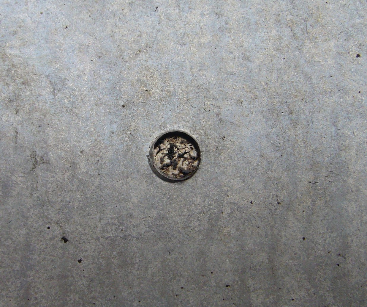

There are also 3 holes drilled into the outer sheet of the top of the can, which appear to serve no useful purpose (though they're perhaps needed in the manufacturing process). I've posted a photo showing these, and also a closeup of one of the holes. There's another sheet of steel immediately underneath these holes, so they are effectively blind - but will allow salt spray thrown up from the rear wheel to get into the innards of the box and accelerate corrosion. I suspect this could be the cause of Mark Elvin's failure as they could easily be mistaken for spot welds in a corroded exhaust.
I'm not sure. That hole would certainly be in the right sort of area, but the soot distribution looked like it was seeping from the seam on the bottom. I'll have another look tomorrow (if I can find my wax. Car really needs it.)
Zanes
The welded seams are on the other side of the end plate to the hole. The metal on the side with the soot is just folded over (much easier to see when the box is removed) and so is not in a place I'd expect it to fail first. Fingers crossed for you that yours is not as bad as you might have first thought.
