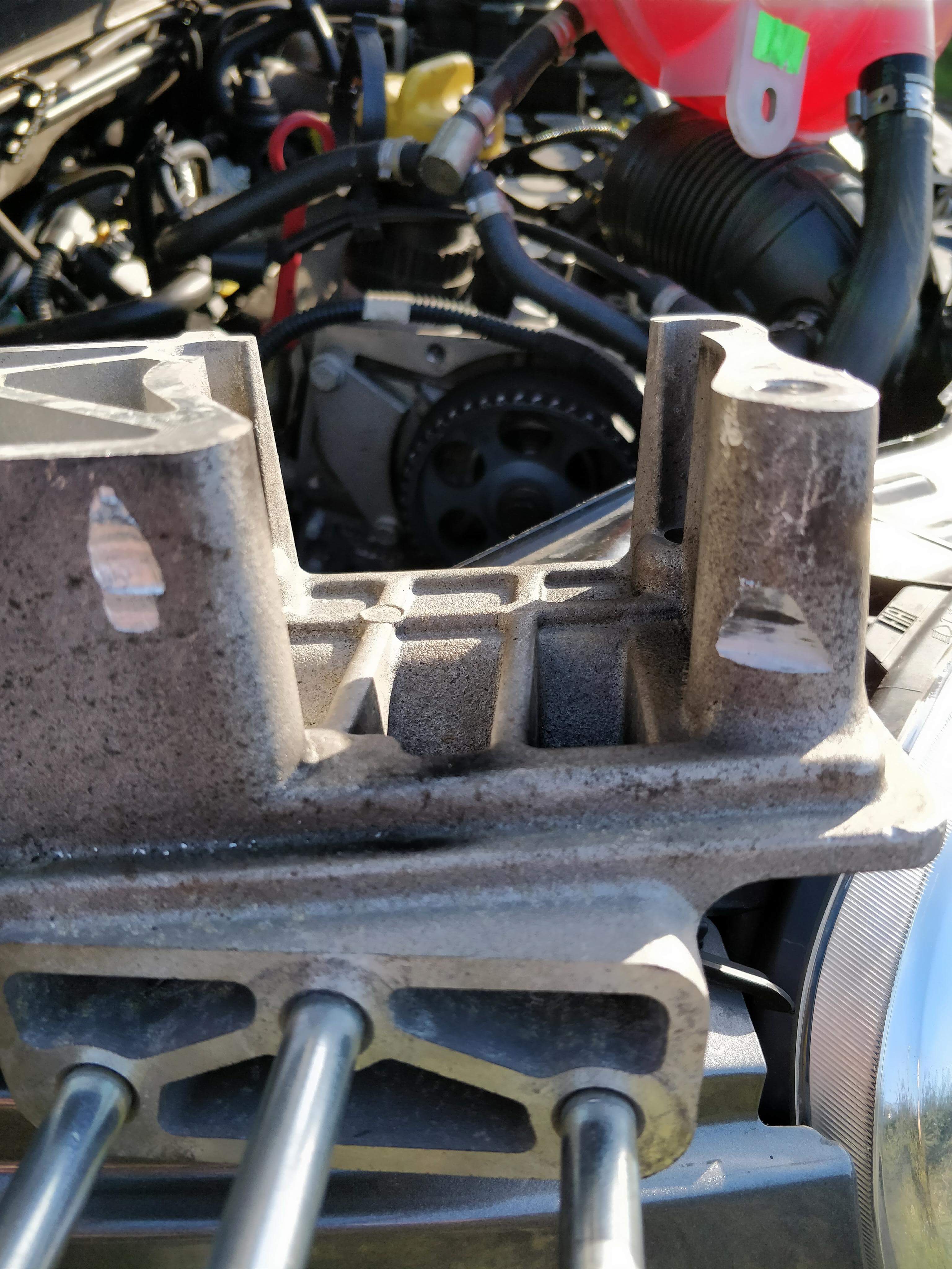

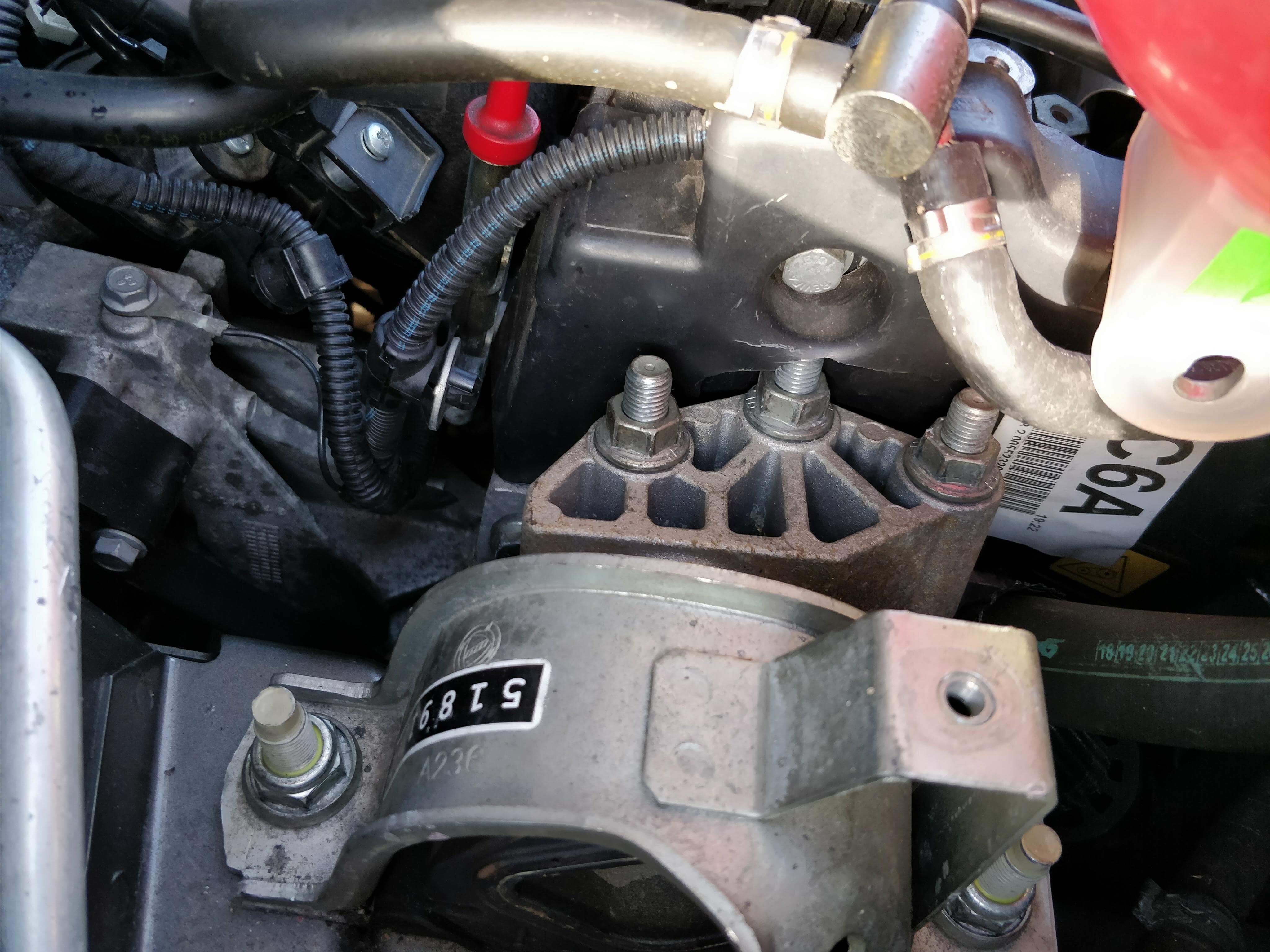

So found the problem. When the car was in last month for the water pump and belt change the garage must have over tightened the bolts holding the engine mount in place. The engine had dropped and the mount was rubbing against cam!

I’m going to give the garage a call on Monday. Would they have needed to take the mount off to do the water pump and cam belt?
Yes, mount has to come off to do the belt.
You say it dropped. Does that mean the bolts came out?
Whatever has been rubbing needs careful inspection, and replacement if necessary. Do not be fobbed off with "it'll be all right".
The mount bolts to the engine block, if any of those threads are damaged in the block casting, you'll be needing a replacement engine.
Keep your temper, but be firm and persistent.
When I say dropped I meant the engine was tilting to the drivers side. The mount was only being held in by one bolt, and that was bent with a crack in it.
The threads on all the bolts are damaged. It looks like they over tightened and stripped the thread inside the block.
Too tight, or not tight enough.
Either way, damage to threads in block is critical.
It may be possible to use thread inserts, but the engine will need to come out to ensure proper alignment, and the amount of material around the thread needs to be considered before drilling a larger hole for each insert. These need to be strong enough and all aligned.
You may need an independent engineer to assist, as the garage may try to take the cheapest solution, which long-term might become worse. If you are a member of the AA or RAC, they may be able to help here.
My advice is don't drive it to the garage. If you reassemble it now, some evidence is lost. Invite the garage to visit the car and look at it there.
Good advice from PB. If one or more of the bolts are misaligned when reinserted, stripping the threads becomes a certainty.
Who did the belt change? There is a special tool for supporting the engine to hold it in the correct position when the mount is removed during a belt change; I'd expect all fiat dealers and service specialists would use this. Home mechanics and independent garages will likely improvise an alternative method of support, which is fine if you're careful and have some mechanical competence. If you're not, or you don't, and you don't use the factory supporting tool, then this is exactly the kind of thing which happens.
If the threads in the block have stripped, then on a '60 plate car it's the mechanical equivalent of a Cat N writeoff; repairing this properly will likely cost more than the value of the car.
Whilst I'm not for a minute advocating not replacing timing belts/chains at the recommended intervals, I'd just observe that I've seen more posts on the forum from damage caused as a result of belt/chain replacement than I've seen about actual belt/chain failure.
The garage is Meridien Milano in Portsmouth. They have had it in a couple of times as the water pump failed last year luckily it was still under warranty, but it went in again a couple of months ago as the pump was leaking. So the mount has been removed by them a couple of times now.
They're a franchised Abarth dealer and I would not expect them to mess up on something as straightforward as a belt change.
The good news is that you're not dealing with some small independent garage. I'd expect them to take responsibility for this and do what is necessary to get it sorted properly, and you will also have recourse to Fiat in the unlikely event that they don't.
