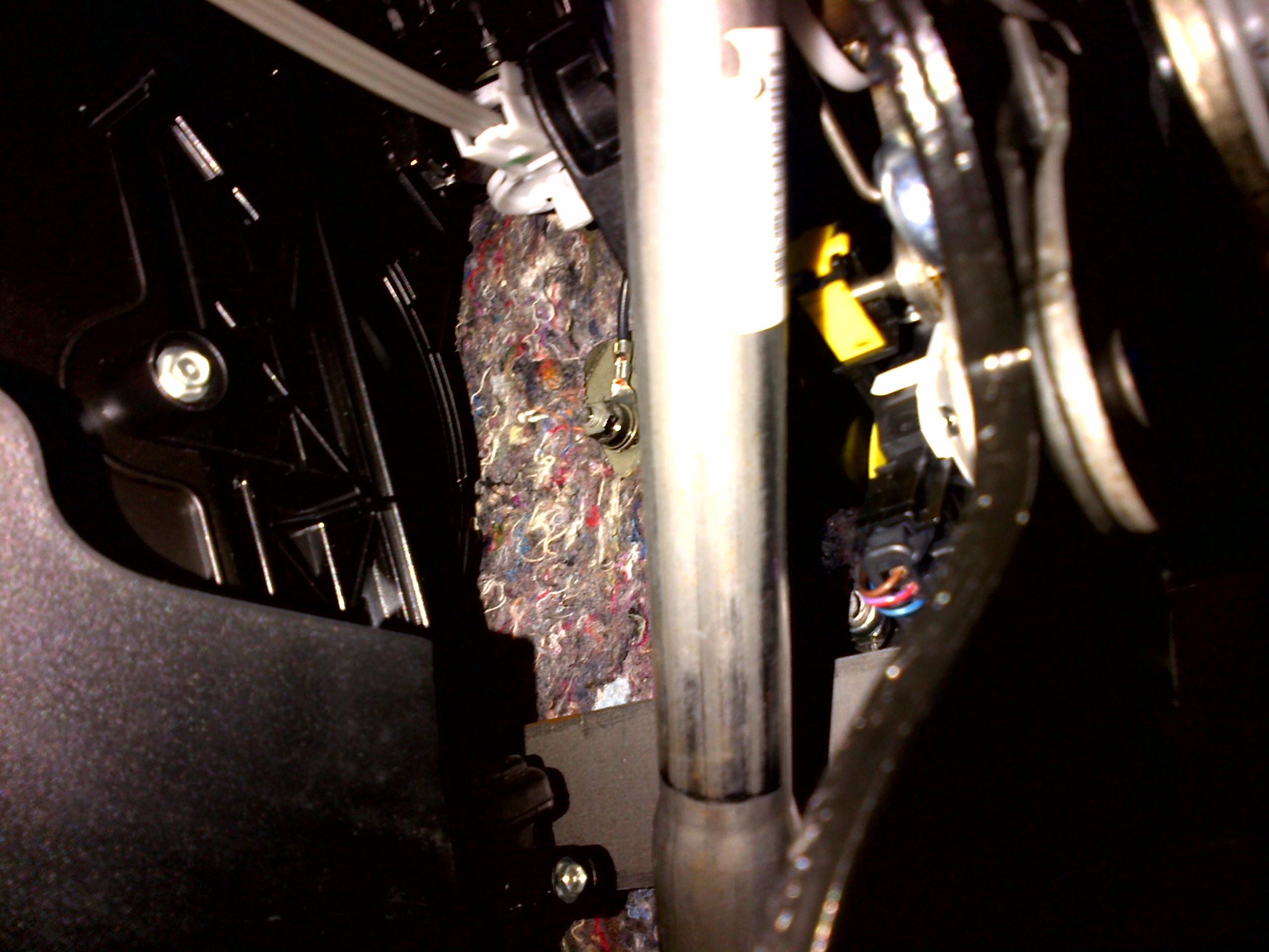

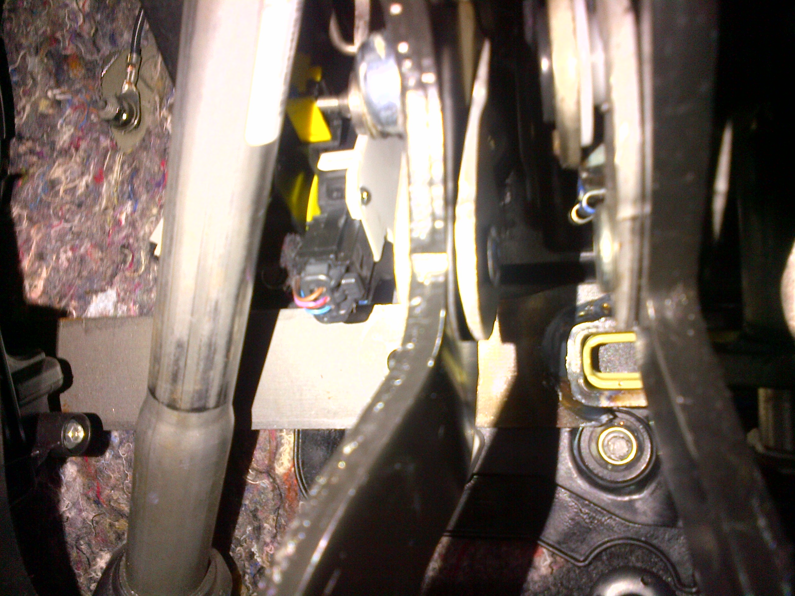

If you still have access to it, can you please have a look up in the drivers footwell and see if you can find the supposed clutch position sensor - some photos of that area might be interesting.
Hi Jrkitching.
I've attached some photos of the clutch position sensor, as requested. They're not brilliant due to the restrictions under the dash and it's right behind the steering column.
You can see the peg on the side of the Clutch pedal arm and the yellow plastic slot cam that it moves when the clutch is depressed.
This is definitely what gives the little throttle blip when you lift the clutch pedal, disconnect it and the blip stops.
