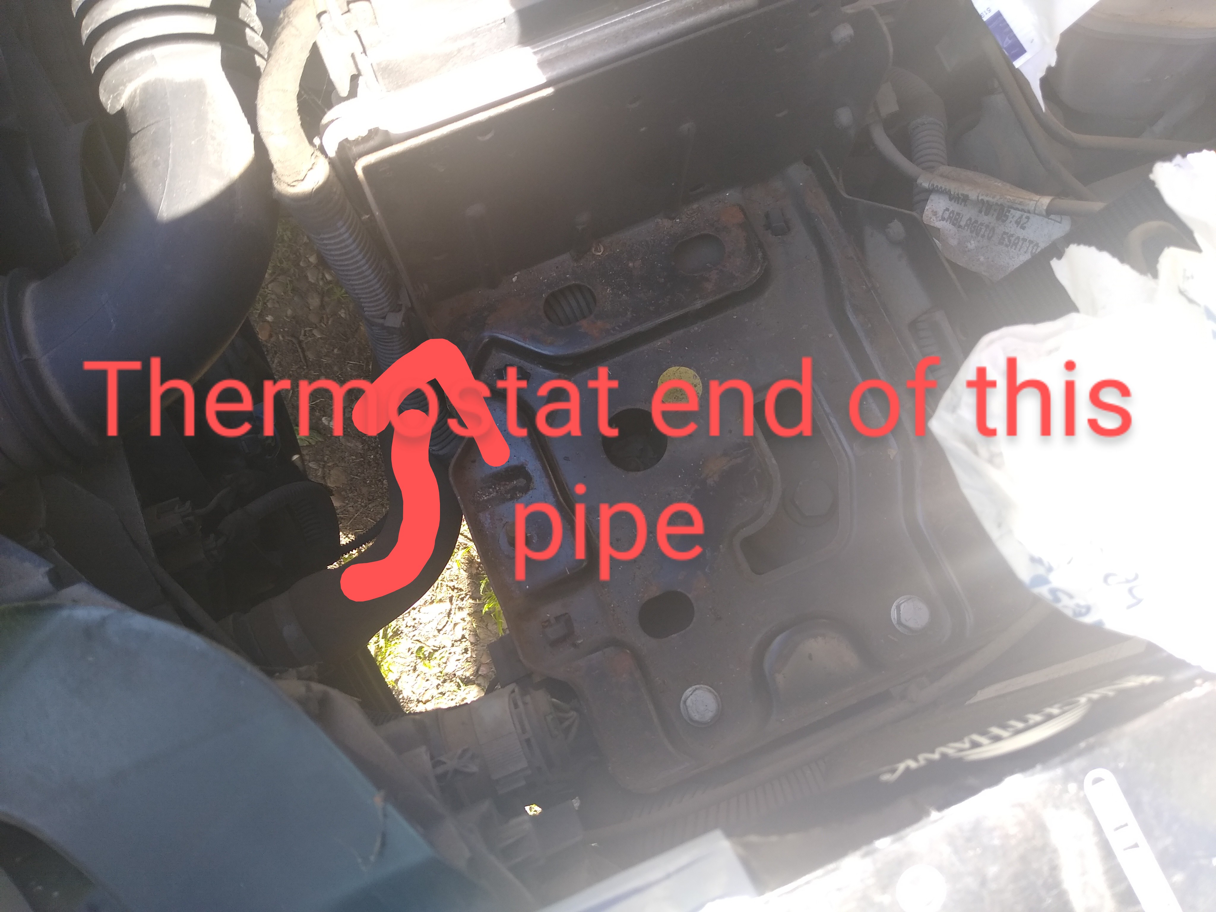

Step 1: Locate thermostat and remove battery and battery mount.
Sockets needed 10mm and 13mm, plus a 10mm spanner for the earth wire on the ECU (not enough clearance for a socket and wrench).
Pitfalls: Several annoyingly fiddly plastic clips to wiring/hose bundles on the bottom of the battery mount - find someone with small hands to undo them. Plus one cable tie in one at the front that needs cutting. Make sure you've got all of them undone before you lift it out

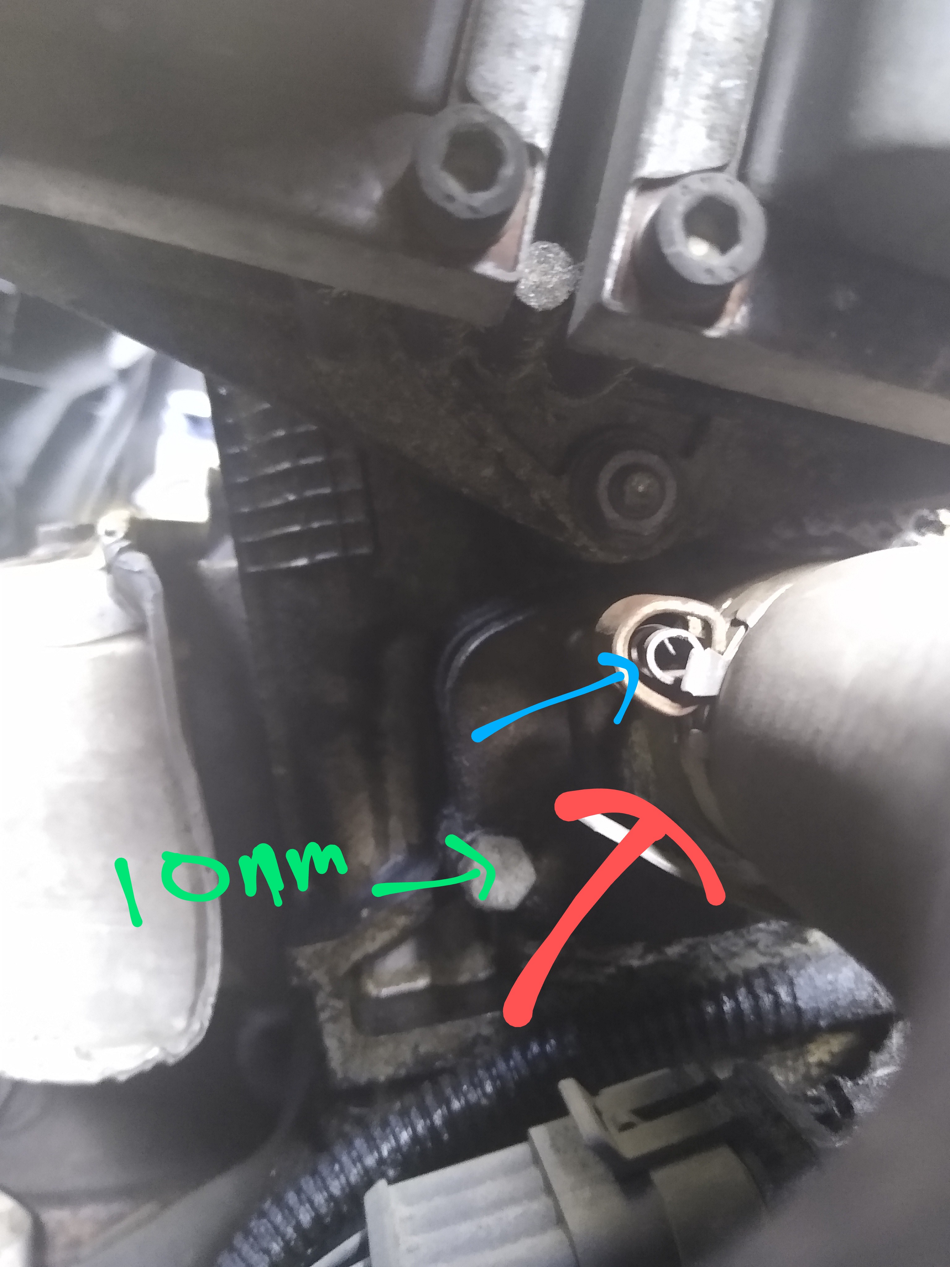

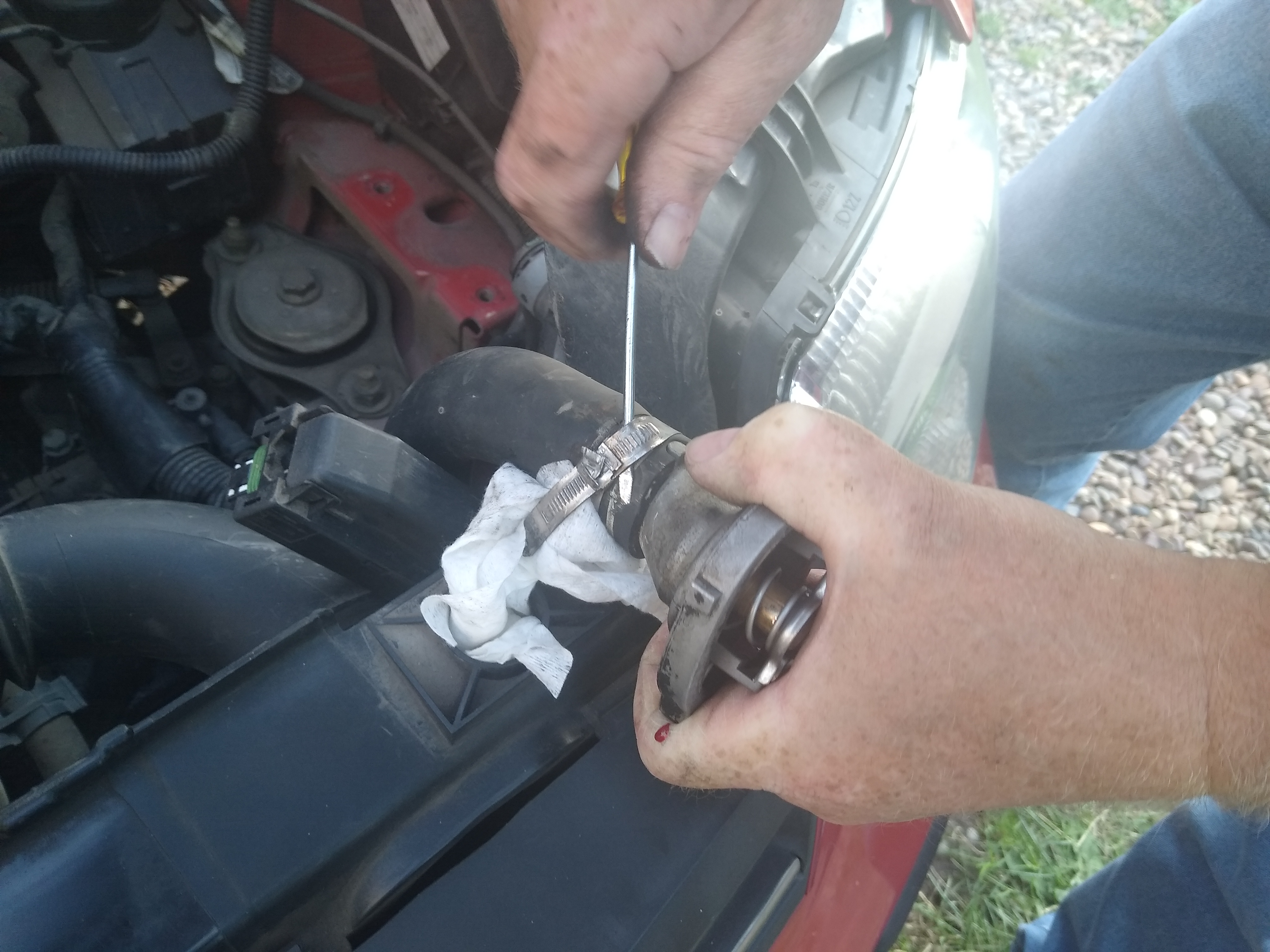

Step 2: Give up on getting the stupid hose clip undone in place and unbolt the thermostat (2 10mm bolts) to get easier access. Discover you've not drained all the coolant ?
Step 3: Injure your helpful family member trying to undo the stupid clip, trying a variety of bending back the clips, attacking with pliers and swearing
10mm socket, medium socket extension, 25-35mm jubilee clip (because I refuse to believe you can get the original one off in a state to reuse)

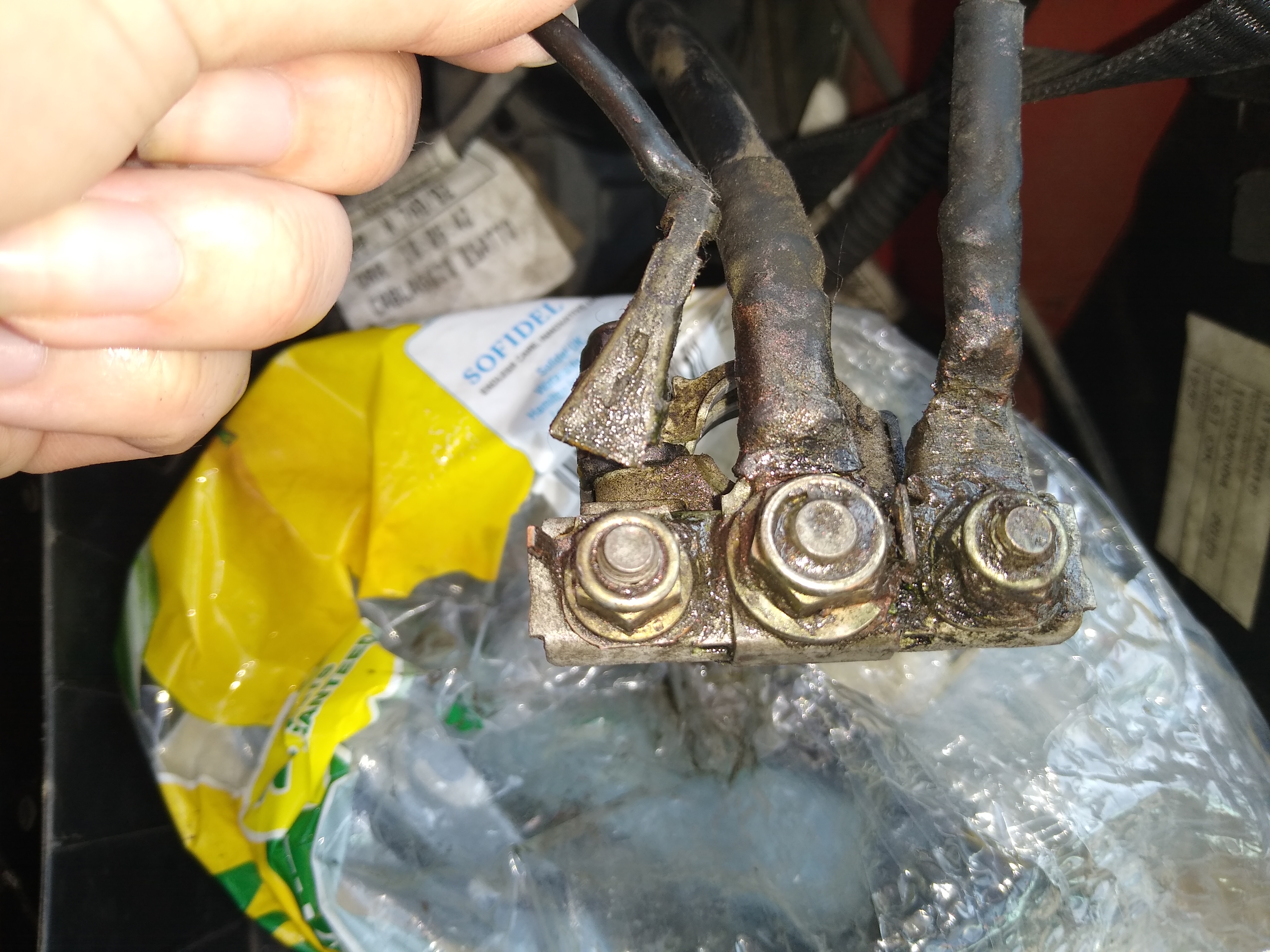

And now I've snapped one of the negative wires on the battery clamp putting everything back ?*♀️
I knew this job had gone too smoothly!
Could be worse it could have broken while out on the road
At least its an easy repair.
I doubt you will have a large crimp tool or connector. You can strip the end and pinch it under one of the other temporarily At least you will be back running in a couple of minutes
For convince its probably worth talking to the mechanics at a local garage they will probably pop a new one one free of charge
Other options would be either buy a new crimp and crush it on with pliers or get a replacement cable from the breakers. You could buy a crimper if you do a lot of repairs. I use mine rarely though. Its possible to flame solder the parts. I wouldn't recommend this as the wires go brittle and may fail down the line

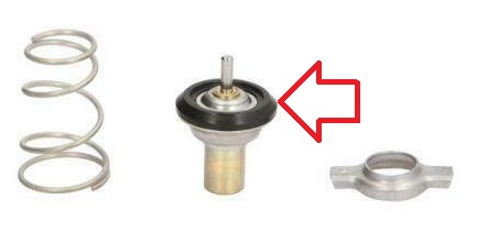

Its not the thermostat itself that fails
There's a internal rubber sealing washer that perishes away. leaving a gap. So it can never fully close
They all fail after around 10 years
Aaaah! another light bulb moment! I've long been puzzled about why these seem to need regularly replacing when a cursory examination seems to show nothing wrong. I'll be having a good close look at Becky's old one when I do the job. Thanks very much Koalar.
