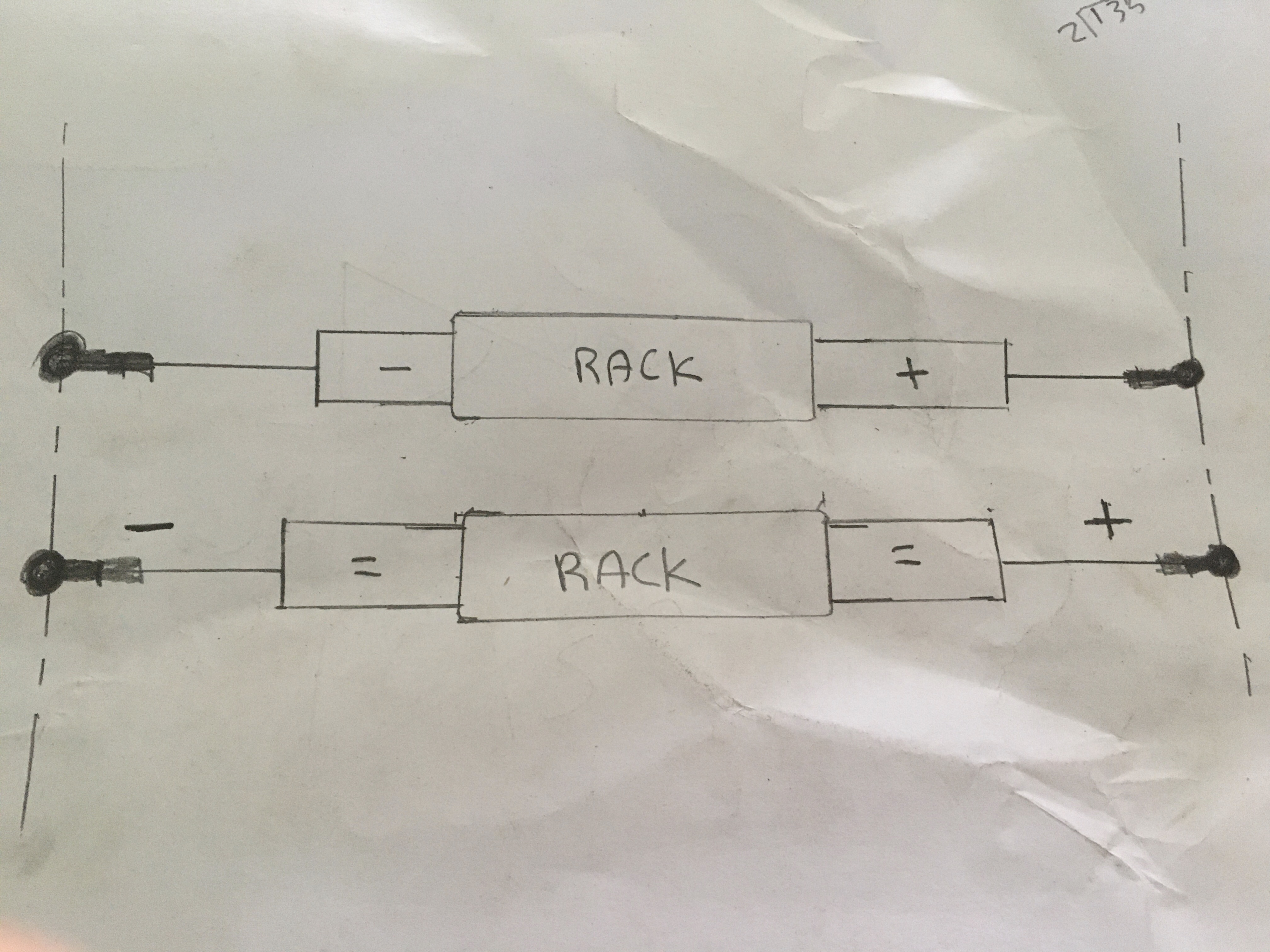

I just don’t get it might be missing something obvious or i am just stupid
The rack does not need to be perfectly equal
But If it did you would just wind one track rod in and the other out.
This is exactly what they do at most tracking centre to correct a pull to one side and is exactly the same result as doing a recalibration.
If the car is badly bent it needs fixing first
