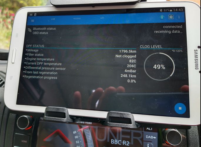

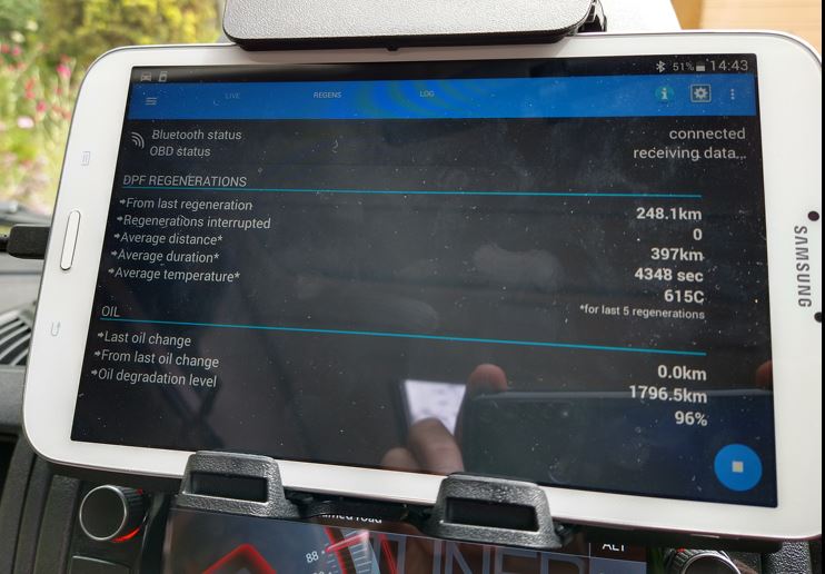

Yes, that's the package I bought from them for my 2019 X290. The adapter supplied is the OBDlink SX rather than a (modified) ELM327 and represents quite a chunk of that £97 but does seem very good.
By the way, for live DPF data I'm using the 'DPF Monitor for Fiat and Alfa Romeo' app for £6.99 reading via a Konnwei KW902 bluetooth module at about £12-16. I think most of the Ducato ECUs are selectable in the app. It's a bit of fun and does allow you to see that you're not interrupting an active regen before switching off the engine.
