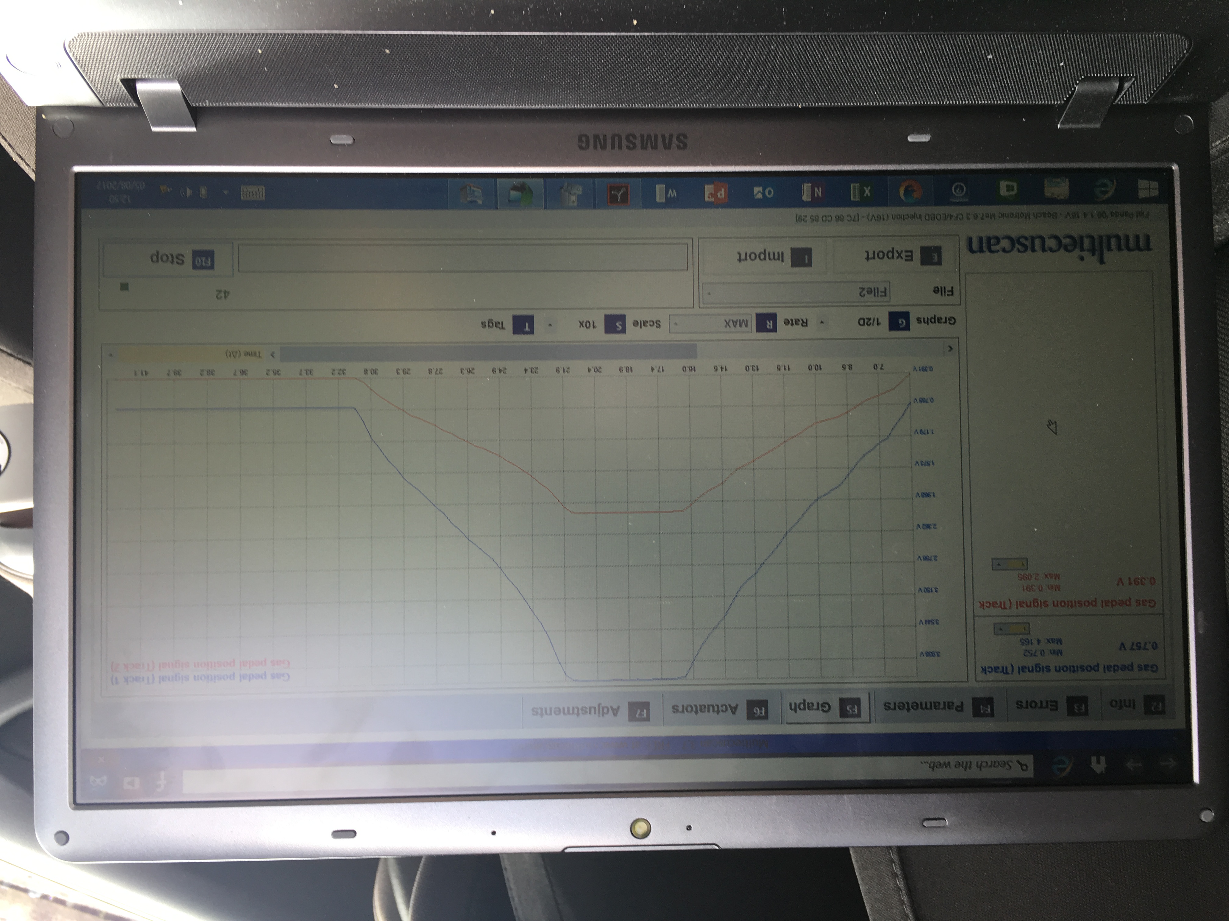

Hi,
If you connect to the engine ECU with MES and click on the parameters tab (or press F4) you will get a list click the tick oxes for throttle angle, Gas pedal position, Gas pedal position signal 1 , Gas pedal position signal 2 and brake pedal. These will then show live data. exercise the trottle with the engine off (ign on) and see if the two pedal signals track each other. They may be slightly differnt values but should change by the same amount. as the pedal moves. The % postion reading should change from 0 to 100 at the same time.
If one of the signals is errtic you need a new pedal sensor or may have a bad connection. The brake pedal signal should only change when you touch the brake pedal.
It may be worth monitoring the signals while gently moving the wiring loom near the pedals, ECU and in the engine bay.
If this all checks out start the enging and see that the throttle angle signal changes smmothly as you move the throttle. If you have an assistant have them drive the car while you monior the signals.
HTH,
Robert G8RPI.
Checked out those parameters and did a graph to check the voltage on the sensors too. Both operating in sync although track 2 is lower in value. Not sure if that makes a difference? I've tried attaching a photo of the graph.
% goes 0 - 100 as expected. I didn't fiddle with the witing loom to see if it throws it up again, I've managed to clear the errors now and light is off, restarted several times, left to idle, warm up etc and no errors have come back on.
Not had time to take it on a test drive to see if it flags back up. I did notice the wiring loom protective tape along the top of the back of the engine bay (bottom of windscreen bit) is all eroded so wires all exposed so these will need taping back up for protection.

Apologies, quick reply on the phone and it appears the photo is upside down.
Thanks for the help on monitoring and logging those parameters.
With me not seeing any faults on those items to monitor, would you recommend just keeping an eye on these things to see if it pops up again. I assume things like this aren't really 'one-off' occurances and ultimatey the underlying issue is still going to be there - whatever it may be?
That's good. You've got everything working and recording correctly.
Unfortunately your car is working correctly with no error so there is no fault to log. That's the problem with intermittent faults. You can only diagnose them as they fail.
