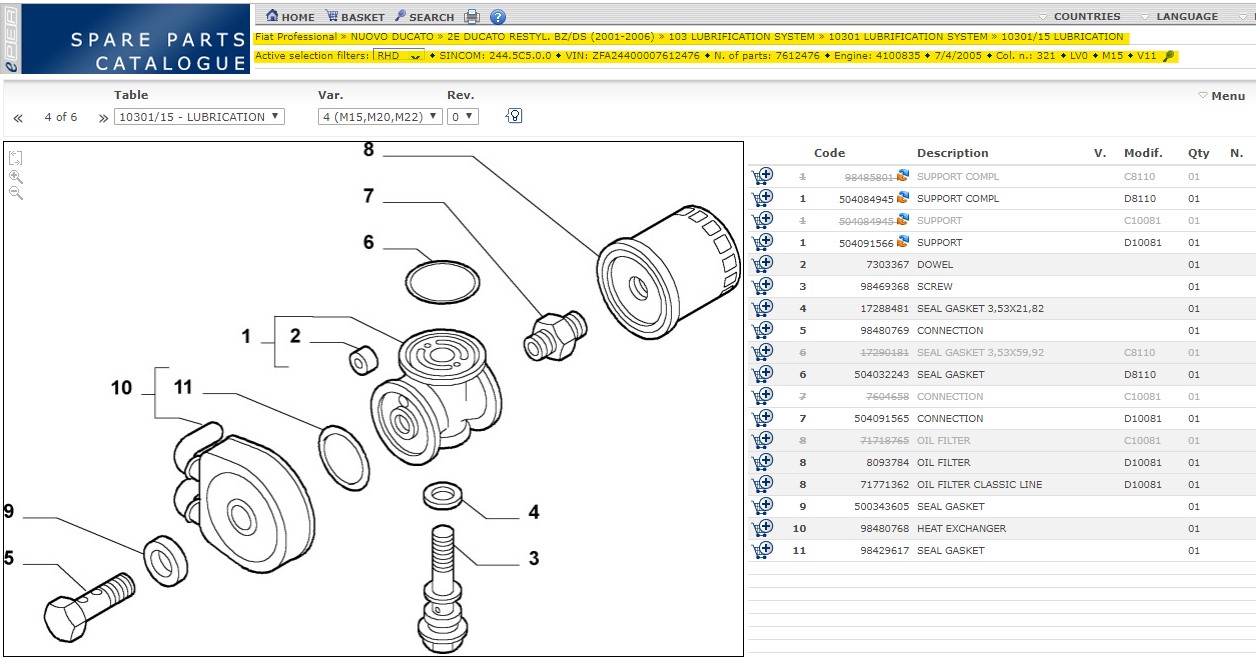

Use the ePer link at the top of the page to enter your VIN to find out exactly what you have. I tried it but looks like your VIN is missing a digit.
Our catalogue here only covers up to 2005 though so may miss your vehicle, a quick Google search should find a more up-to-date version of ePer :)
If the details highlighted yellow are correct for your van, then the part number is 8093784 which has now changed to part number 71753739.

If it's any use, mines a ZFA244 2.8jtd 2005 127BHP Camper and my next filter on the shelf is the same as the one fitted, I always keep a duplicate filter in stock so to speak.
It's a Fram-PURL S235 also marked LS235.
