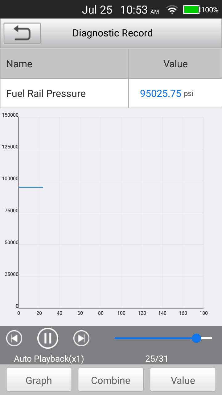

The RAC engineer said that the fuel rail.pressure was 450 bar checking with my launch crp 429c scanner it recorded 655350 kPa is that 6553 bar? , if so do you think my scanner is telling the truth .
Would such a high pressure be possible ?
And would that stop the engine ?
I also jave to add scanner hasn't given same results consistently so have doubts about it

65535 indicates an invalid or out-of-range measurement (it's the largest number you can store in 16 bits, if you're curious). Most likely meaning is "couldn't measure / couldn't read".
Are you seeing that 655350 all the time or intermittently? It could be your scanner that's deficient but it could also be the pressure sensor or ECU glitching. Would be good to check with a better scan tool.
It's for the 40 / 60 seconds its running, i will take time today to check against another car in the household.
I've reset to imperial psi
