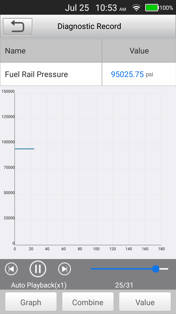

2.8JTD uses 275/300 bar in high pressure fuel lines, so if you are overpassing that value the ECU will stop the engine. The same happens if the low pressure fuel pump performance decreases due to a problem on it, this can be diagnoses with a fuel pump gauge connected to the fuel line and it should be around 4/5 bars.

The fault codes this morning were P0638 p0235 and p0403
