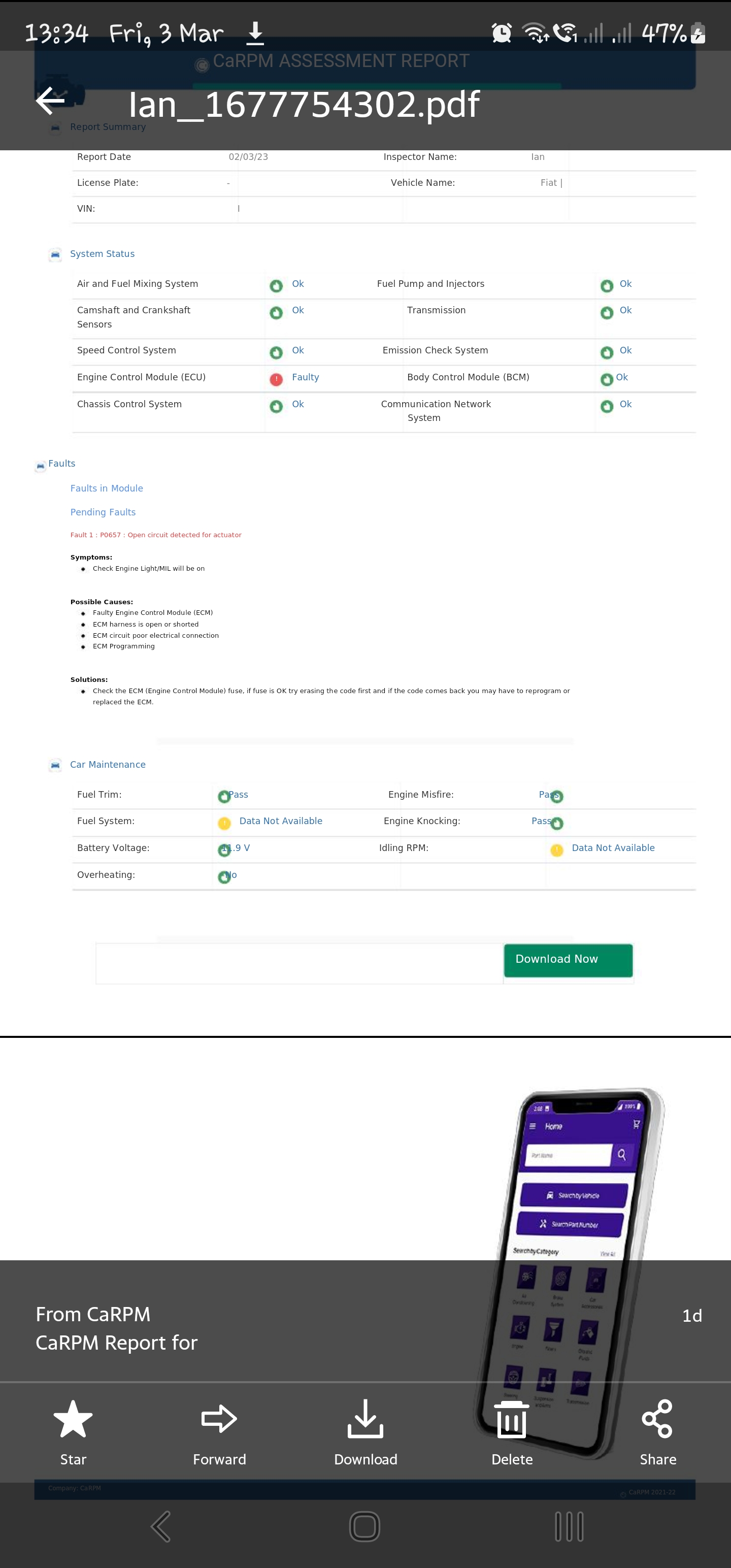

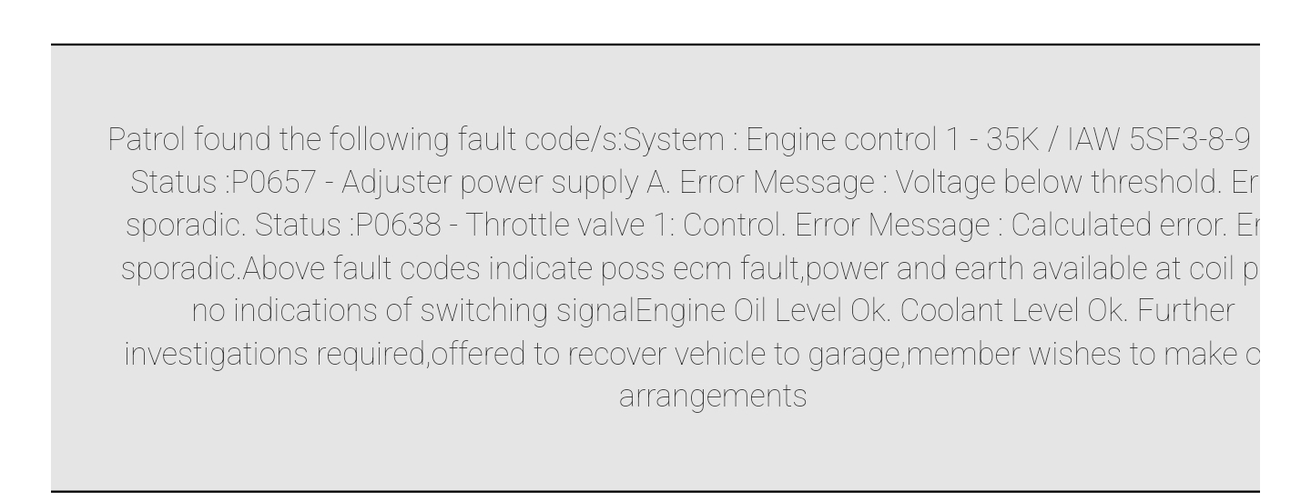

Just received the report from AA. I've attached it to see if it makes sense to you all
I would start with a wiring fault, earthing points, low battery voltage issue etc. Especially where getting a variety of error messages. Unless water has got into a ECU in my experience on most makes of vehicles the ECU is generally quite reliable.
Maybe other Forum members have better specific guidance on where to start .
The wiring has all been checked with no issues found.
I agree that the ECU is the least possible fault
