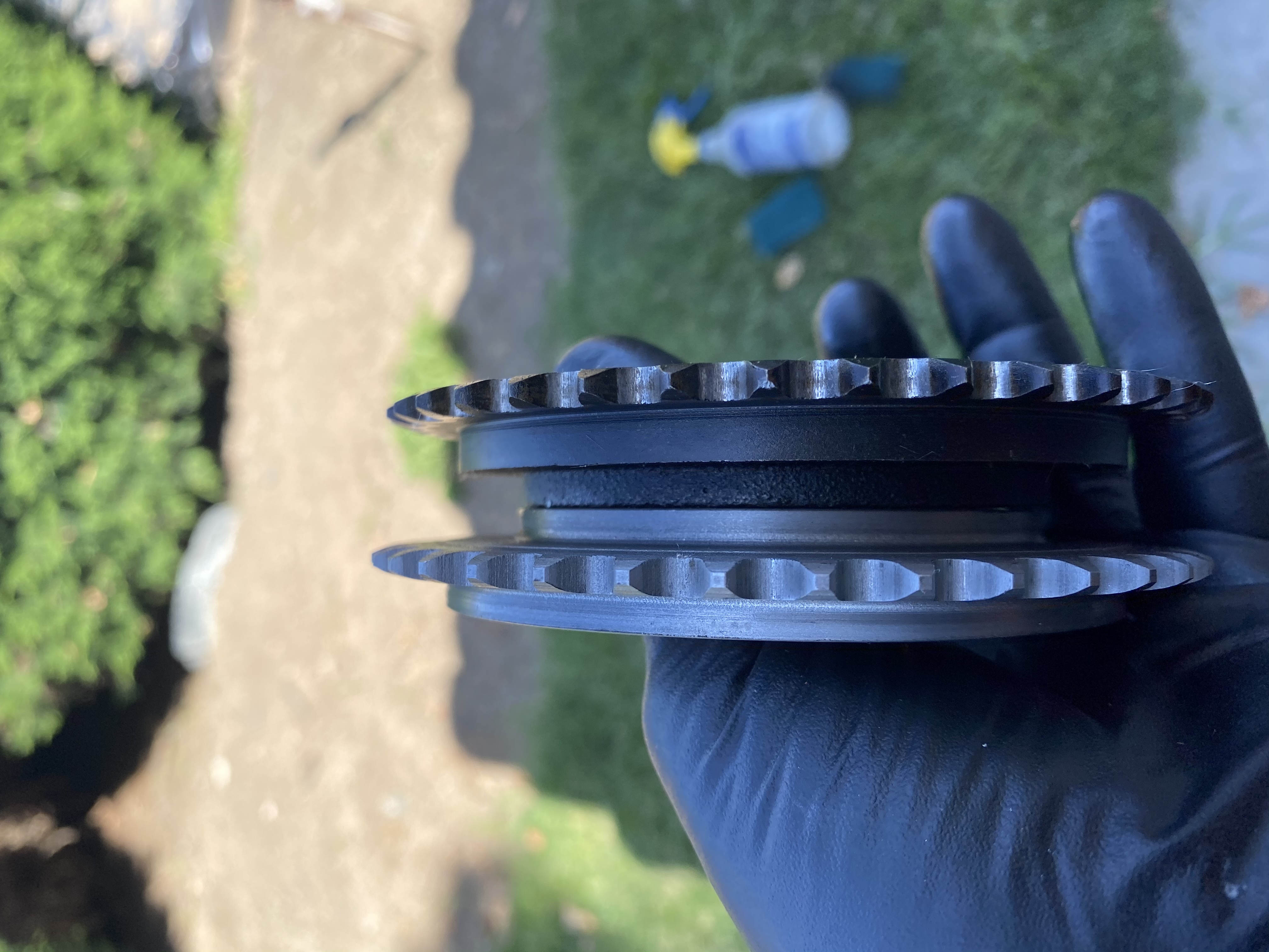

Turns out, I won’t be using MOST of the parts associated that I purchased. Possibly including a timing chain, which may be another issue in itself. I also had to order a new cam sprocket, as mine was pretty worn, per my engine builder friend. I found an original new one, so I’ve got that going for me.
I bought my parts through FD Ricambi, who was adamant that there have never been any issues fitting these parts to a 479 engine. Now I need to send proof back. They are substantially different. See the attached pics!
