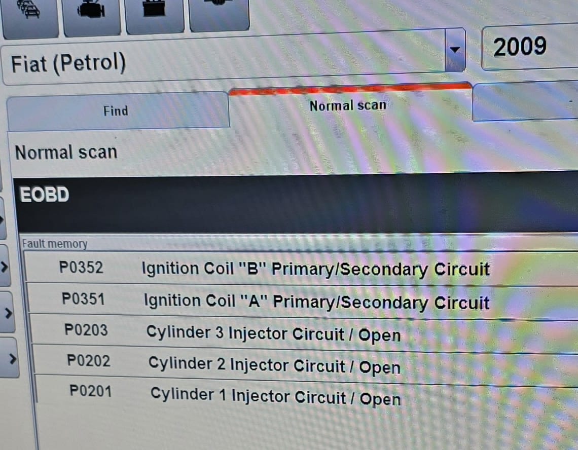

Attached is a picture with the codes that keep reappearing after ODB delete.
The last thing I could think of is the ECU. Is there a way of checking this?

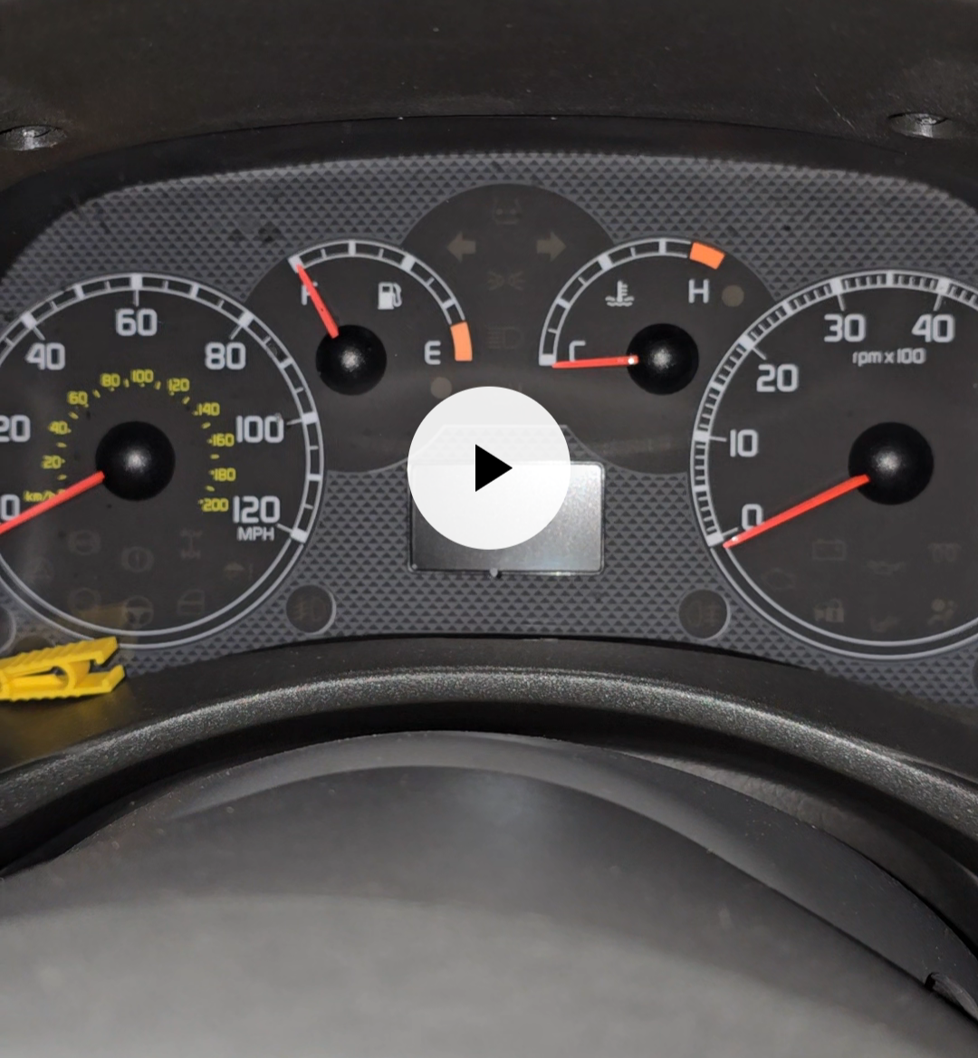

post a video of the dash as you switch the ignition on wait for the lights to go out, crank the engine for a couple of seconds
Here is a video from yesterday.
By now the battery is a bit worn out as I've been trying to start it for the past 4 days. However, it used to spin much faster.

That last video tells us quite a lot
The block ground is probably okay the battery, oil, immobilizer and engine lights are as they should
Supply to the body computer (BSI) now remains over 8.5V
ECU, BSI, dash and immobilizer are probably fine the key CODE is read and the light goes out on the dash
The crank sensor is working, rev counter moving
The inertia switch is fine, pumps priming
petrol in the car, fuel gauge moves
The electric power steering (EPS) fails it's self test

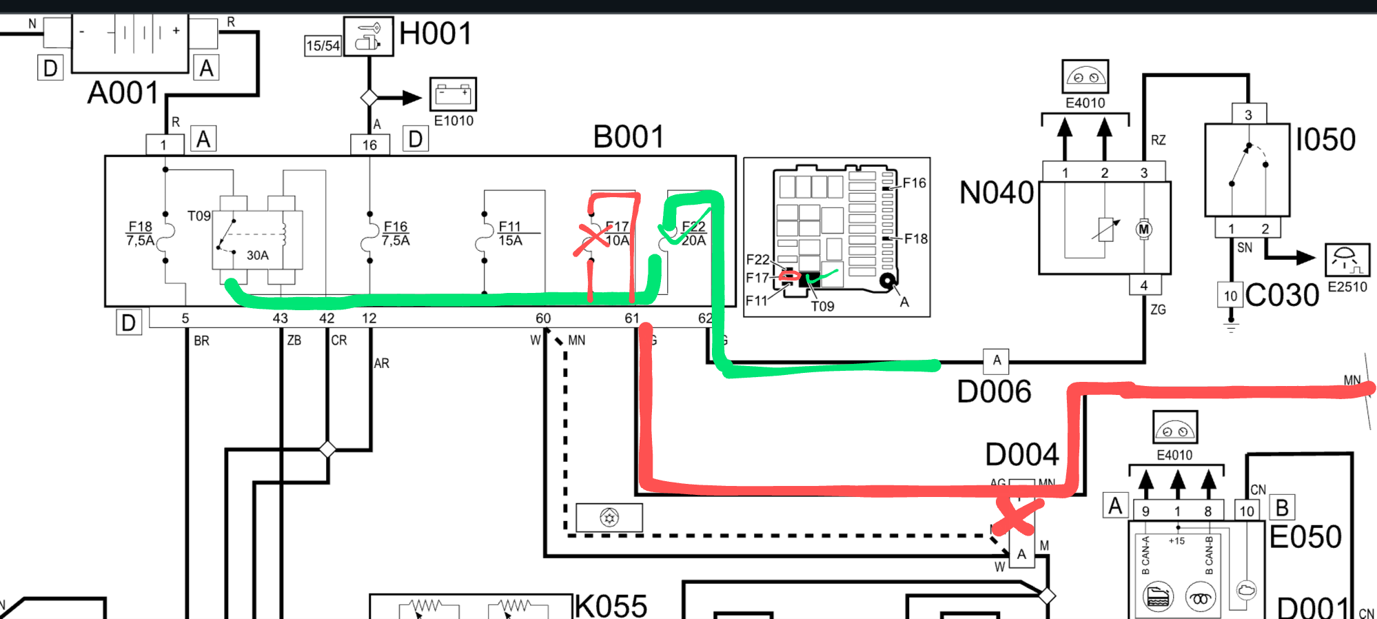

The error codes help to point in a direction all injectors and coils share the same power supply,
We know the relay working as it is also shared with the fuel pump, green on the diagram below
I would check the red line as it powers all of the 5 items that failed
F17 is as good a place as any
It's in the black fuse box under the bonnet near the battery
The picture of the box is upside down second one down on the right hand side 10A
Check it's not popped out slightly first, then check with the meter it's resistance if it looks okay, check the legs for corrosion and the connectors in the fusebox
Try not to touch too much at a time, if it starts to work, because it was intermittent, it best to know the last place touched

Hallelujah!!!
It started!!!!
Thank you very very much!
I am not sure which wire it was, but it was something behind the fuse box.
There was power going at the F17 fuse...
I tried to move the wires around to find out which one it was but it didn't cut out anymore.
