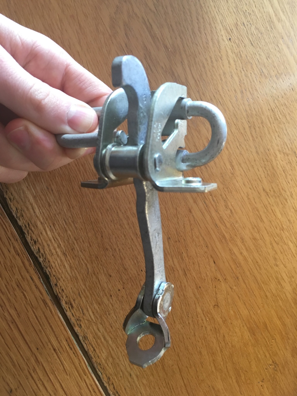

Well, bit the bullet. Ordered it from Fiat who sells it for £35.14 in NI.
Please tell me the check strap functions by preventing the door from breaking off? Because if it doesn’t I don’t know why I bothered.
A total of £91 for that little surprise on Monday of the window sticking. Tempted to put signs up on all the other ones asking passengers to ‘only use in emergencies’ lol

Would uploading a photo of the check strap I picked up today help?
It might - as might the fitting steps.

I haven’t forgot to post photos of the strap... but I’ve spent all day looking for where I left it. Hopefully it turns up before the motor for the window is due to get here
Front Right Check Strap
Ricambi Originali
0051779914
Front Right (Drivers) Door
