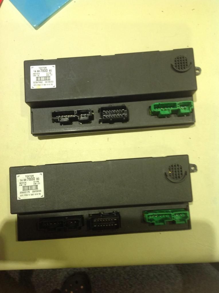

my door node-
delphi (not texton)
model - 14887800 80
barcode - 42567326
production - 22/6/2004
what you got Franc? And can i px this/these module/s with you?

These are the type I've removed from Ulysses and C8, they are stamped with dates, I have 2 more but from 52 models but I can't see them being any different. The bottom one is an 03 and would be the nearest to your VIN but I personally think any of them would work.
This is what I've got
If you want to try one, cover the p&p and if it works you can have it for £20, if it doesn't return it.
Or you can post me yours and I'll try it in one of mine.

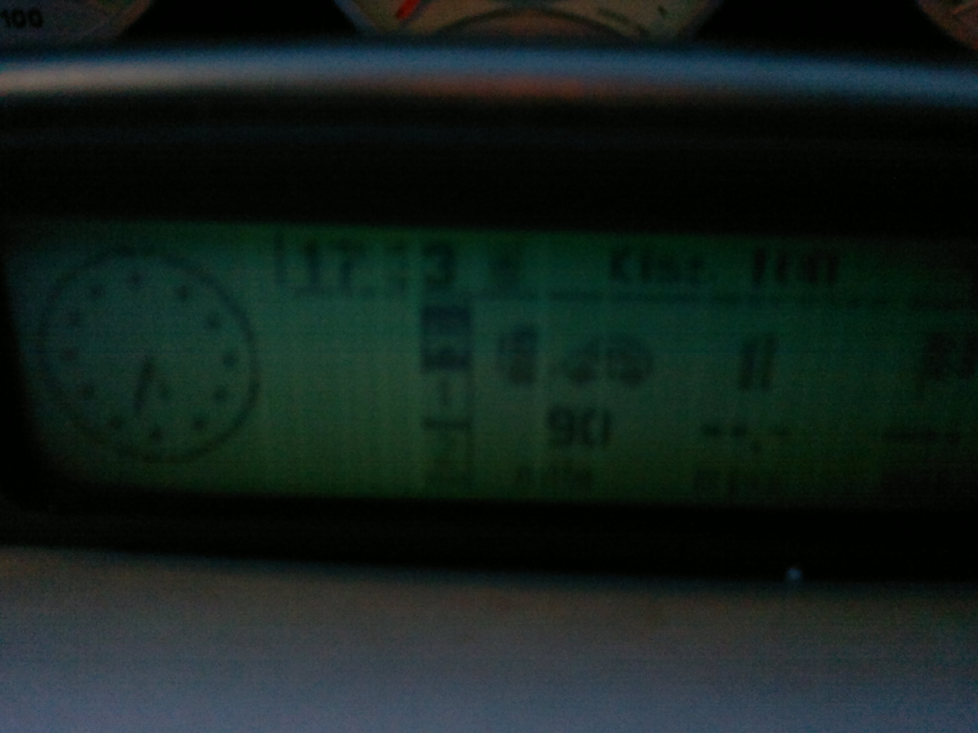

Twin button is in reasonable nick as far as i remember, i/r is suffering from the lines of death

Yes, i/r in mine is going to replaced with n3. reasonably bad unfortunately. twin button in the donor.
Will snap some snaps of both thisavo and put them up for you cliky.
