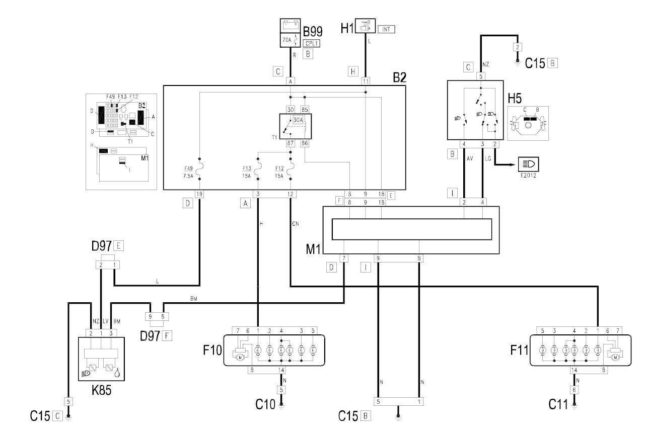

Davren Moderator Staff member Uploaded 10+ resources/downloads Joined Jul 6, 2008 Messages 16,433 Points 3,937 Location London, UK. Oct 28, 2017 #2 Wiring diagrams for the dipped and main beam headlamps are below. F10 is the left headlamp. F11 is the right. . Attachments Dipped Headlamp.JPG 88.8 KB · Views: 51 Main Beam Headlamps.JPG 90.6 KB · Views: 53

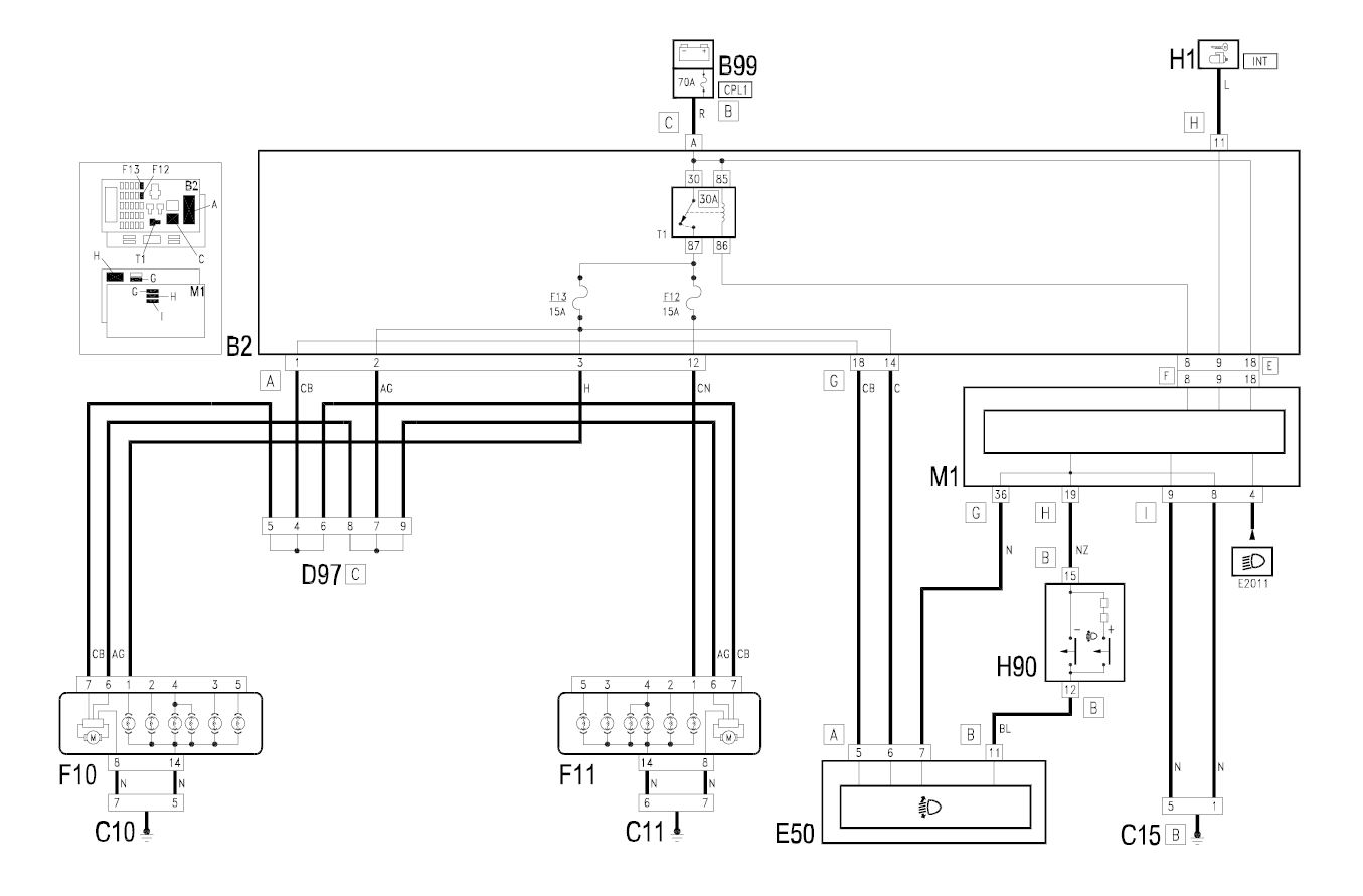

Davren Moderator Staff member Uploaded 10+ resources/downloads Joined Jul 6, 2008 Messages 16,433 Points 3,937 Location London, UK. Oct 30, 2017 #4 misu said: It's ok! but I need the circuit at the headlamp adjustment motor. Click to expand... First diagram below is for normal headlamps. Second diagram is for original Xenon HID headlamps. . Attachments Headlamp Adjustment Motors.JPG 99.7 KB · Views: 40 Headlamp Adjustment Motors HID.JPG 94 KB · Views: 44
