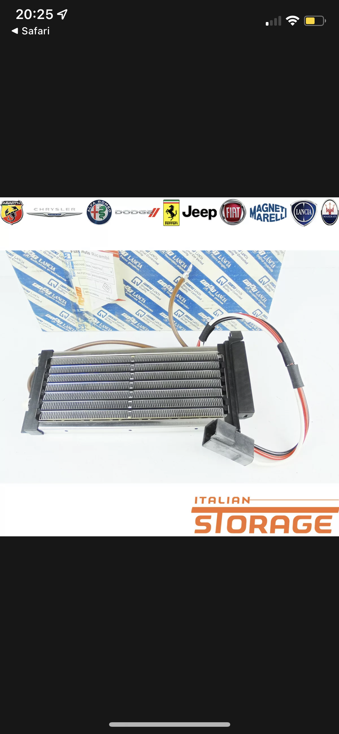

Hi,
I haven’t found anything about my problem!
I don’t know if every Stilo has this electric heater wich give us hot air although motor is cold, but mine has.
So, this is the problem.
From 3/4 weeks, everytime I put A/C on HI temperature and the engine is cold, the electric heater start but there’s a cicling “tic-tac” came from the relay.
The air flow isn’t hot enought and this “clicking” stay till engine is get hot.
Everyone has this problem?
I am attaching a photo of electricale resistance of ours Stilo.
Thanks.
Uhm… if I have the engine at 800-850 rpm, the relays click.
But, if I have the engine above 850-900 rpm, like driving, the heater work and relay only do 1 click like “on”
