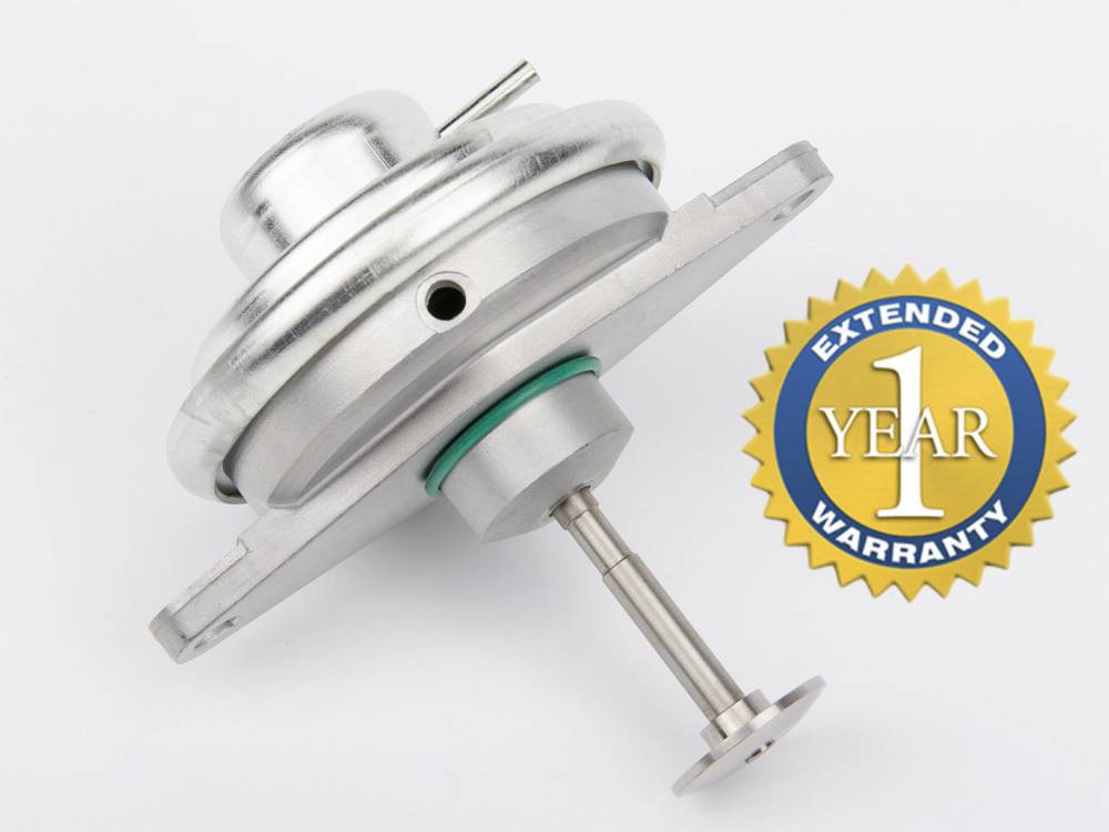

hi all . my next job is the egr but the more i look into it i don't see the need to use the blanking plate for when you disconnect the plug from the vacuum unit to plug into the cheater the egr will not work as removing the egr unit is & can be a bitch ( life's too short ) but i need to test if the valve is fully closed looking some cars ( see photo ) they are sold separately so if i undo the 2 screws on top would the valve probe come out any info much appreciated .cheers

I would assume it is closed. If it isn't, the worst thing that can happen is that the motor will smoke from overfuelling when under load. If it does, then you need to give the valve a clean and seat it properly. If you have a high mileage unit, it may jam a little open with carbon buildup. If reasonably new, highly unlikely.

hi oigle. thanks for that but I need to know for sure that the valve is closed otherwise I will fit the blanking plate my question is if I undo the 2 screws on the vacuum on top of the egr valve will I be able to check it closes off the exhaust in which case that will save me a lot of work
I don't know - have never had mine off. Why do you need to know initially? The fitting of the emulator looks like a 10 minute job without the blanking plate. Try it first and then, if it smokes under load, go to the trouble of inserting the blanking plate - that is a much bigger job. You would have to remove the egr completely to clean it and ensure it is seated, if you want to go down that track. Is your unit high mileage?

hi. first I need to make sure it's closed ( seated ) so I can just fit the cheater .
second I know fitting the cheater is a 10min job thanks to techno 100
thirdly I don't want to clean it just stop the crap recirculating mileage 22'500. it's hard sometimes trying to ask questions on forums about problems as they tend to come out wrong & get misinterpreted not the same as face to face but having said that this IS a good forum thanks

All I meant was that to ensure seating, you would have to clean it to get rid of any carbon around the valve seat. At 22000, I would doubt that you would have a problem.
