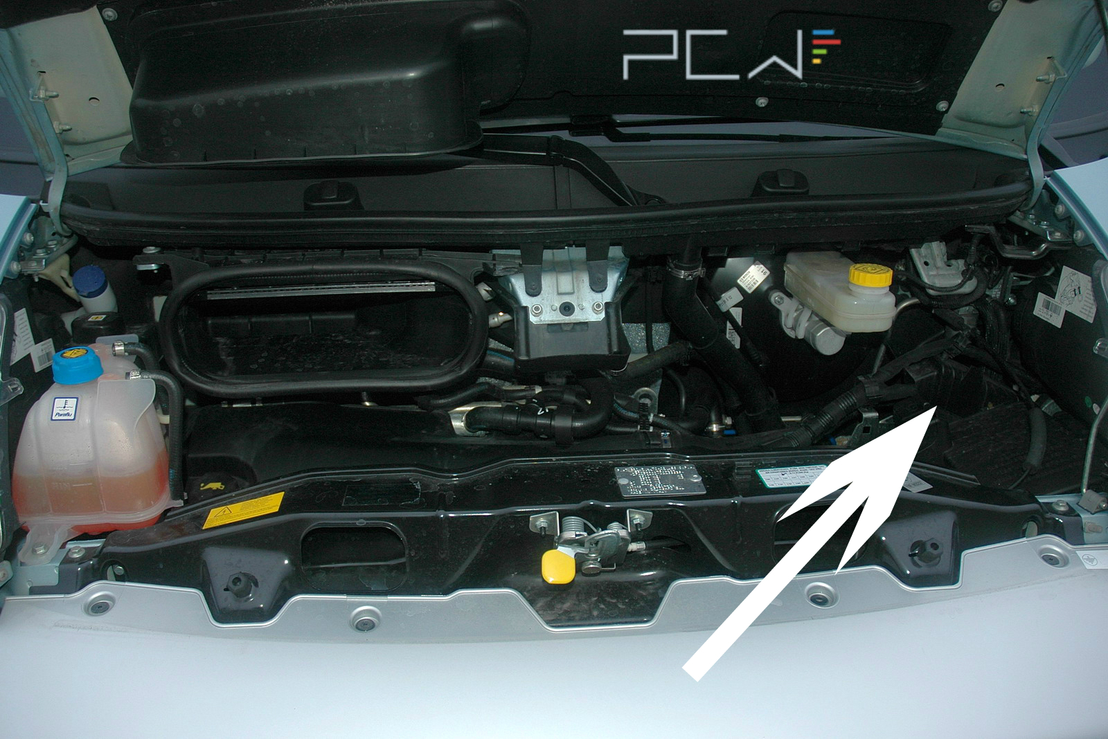

Hi everyone,
I am failing at locating where the ECU is located on my Fiat Ducato 2007 3.0 160 hp.
I need to send it to repair and I would like to extract it myself, instead of sending it to the garage.
I have the workshop manual but I am unable to see anything related to this.
Thanks in advance!
On the ones I have had it has been in the engine compartment between the air filter / fuse box and the fuel filter. it is shown by white arrow in this photo which is of a LHD vehicle but ECU is in the same place on RHD

Thanks a lot for your reply.
I will have a look! I can certainly locate the fuse box, air filter and fuel filter, but I couldn't identify by eye the ECU. I will have a further inspection. Thanks!

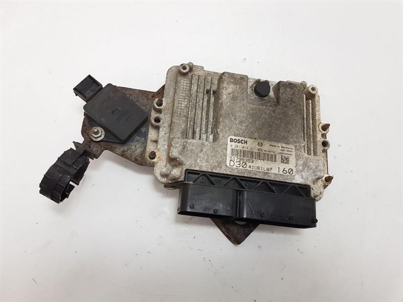

You can't miss it. It is behind the metal bracket it is attached to with a big cable going to it.
Attached is a photo of a used x250 3.0ltr ECU, advertised on Ebay.
