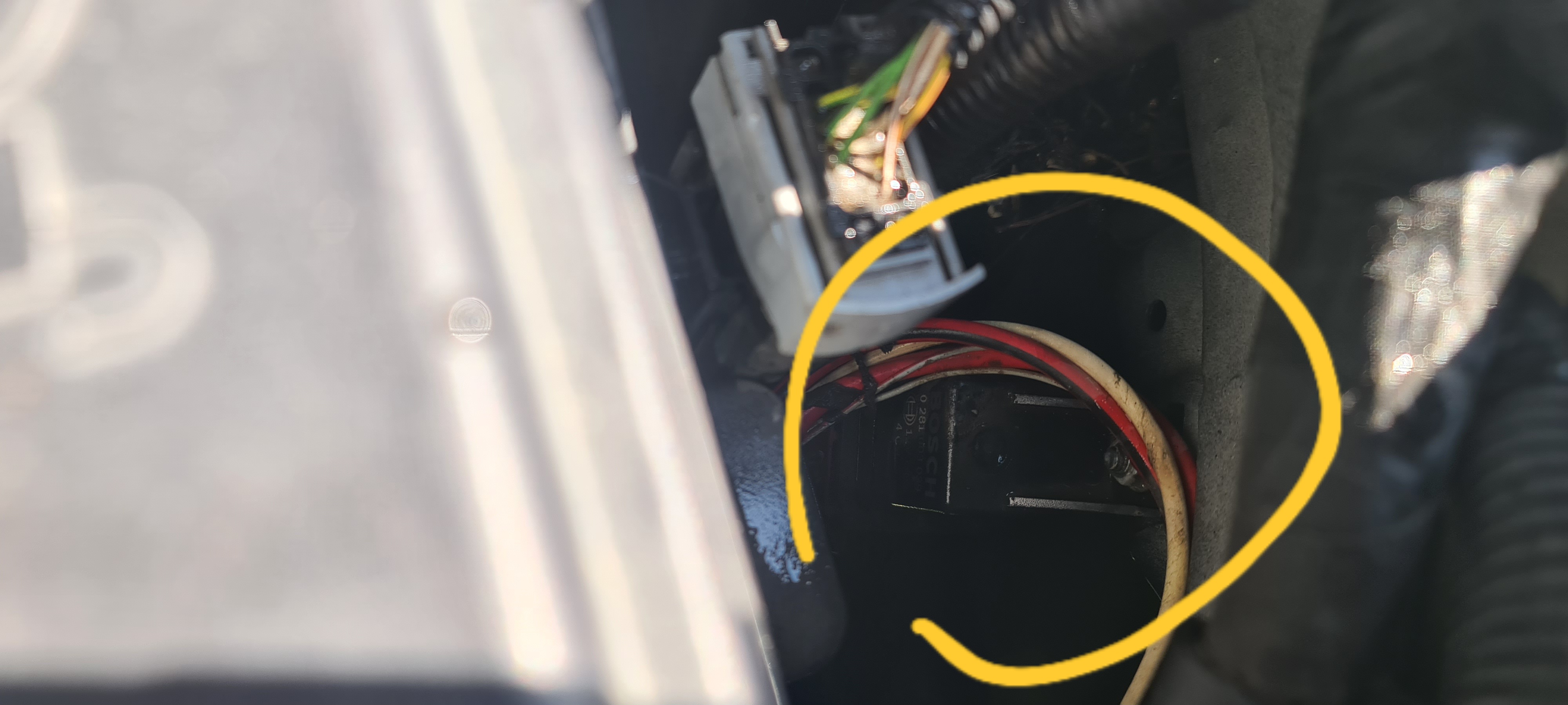

Hi, you need to check around main ecu,also fusebox in engine bay. Maybe it's filled with water. Also check connectors of airflow sensor and others, maybe they are moist. If they are moist buy some K2 spray contact spray or something like that and spray all the connectors.
I have a visual memory dating I think from the last few months of a posted photo showing damaged wiring near the ECU, on LH inner wing. One of the wiring forms can rub against a tubular member to the extent that the insulation or more is damaged. The poster had taken preventative measures on his current vehicle. Perhaps an example of "rusty junction". Unfortunately I cannot recall poster or forum.
Given the conditions mentioned it seems that rain water will have reached this area, and if wiring is damaged..........
To gain access it may be necessary to remove the LH headlamp unit.
Thank you .. this sounds like it could be the culprit! When you say LH is that looking at the front of the van ( near side/kurb side )
Ill have a dig about!
The nearside for a RHD vehicle. I always quote sides as viewed from the driving seat. If for example you purchased an LH lamp unit, you would expect to get the one on the left as viewed from that position.
As I said previously, you will probably have to remove the LH lamp unit for access. Take a good look, and then take care not to move the adjusters. This should avoid any need to reset the adjustment. If the adjusters are the same as those on my x244, they are like a large nut (18mm spanner) around the M6 (10mm spanner) fixing bolt.

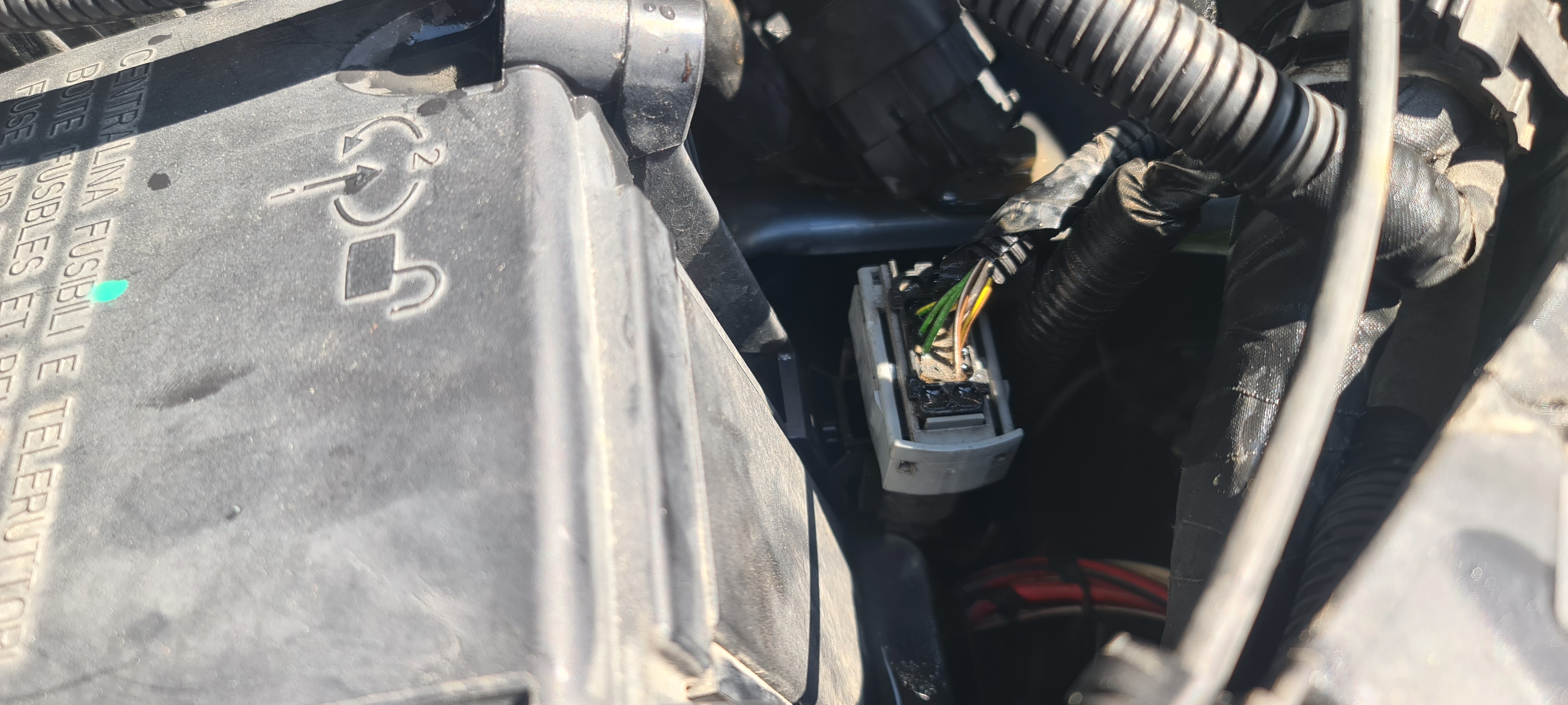

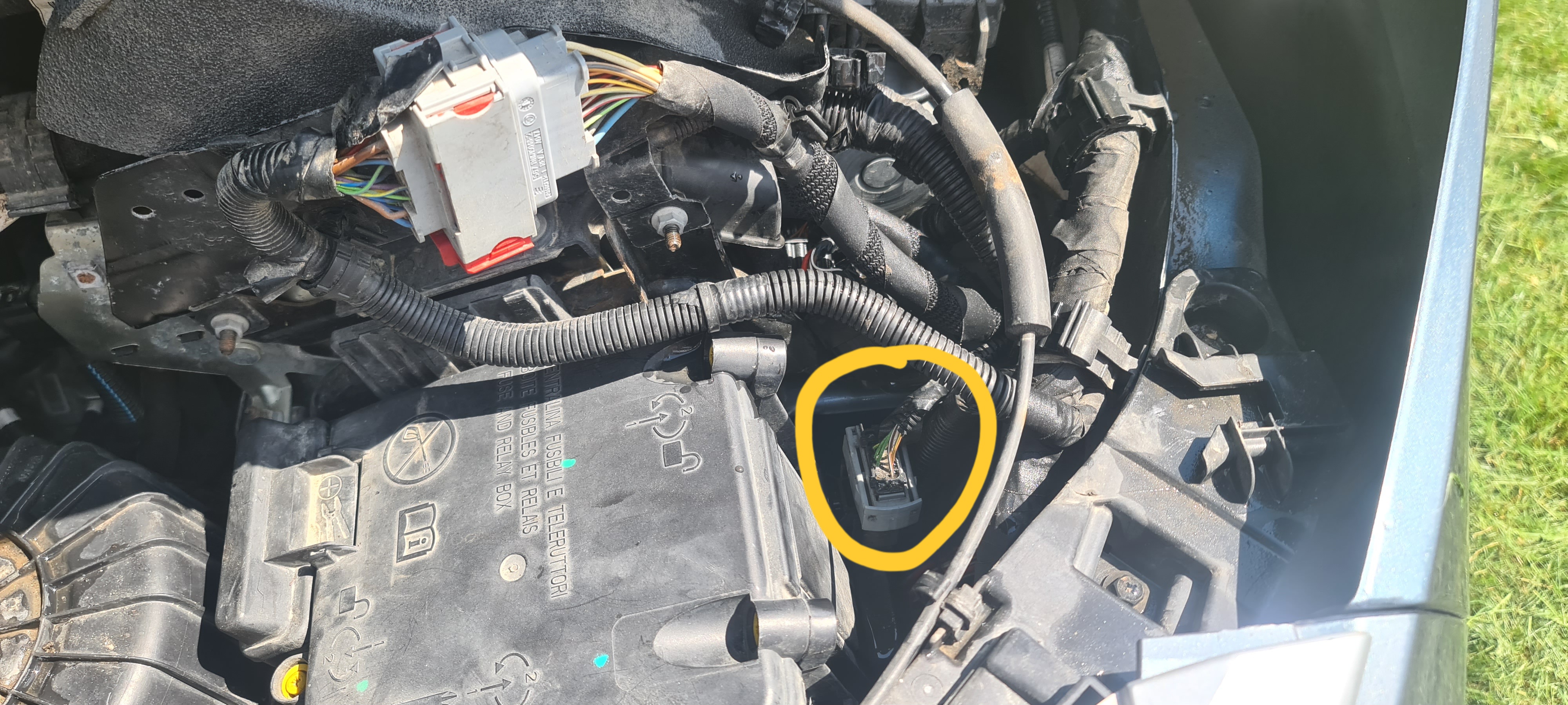

I have had a look after hosing the windscreen with lots of water.. It appears when the right hand scuttle drain pipe cant handle the load, it overflows the our of the scuttle and seeps water into the area you describe.. I took the lamp off and could see a grey electrical plug with water sitting in the back of each terminal.. although they appear sealed.. Im not sure.. Also the large black replay bolted to the inner wing just below this plug is drenched. Is there anyway in finding out what these components control.. it may makes sense with the stalling?
My thoughts is this scuttle design, although flawed anyway . probably wasn't designed to take the quantity of water from the top of a motorhome roof when its torrential.. my MH has two forward drain channels on the roof that the water flows out onto each side of the windscreen. This issue has only happened in bad rain when my vans nose is parked slightly down.
Any info on the connectors would be most appreciated!

I do not have information specific to the 3.0 multijet. eLearn for the x250 is a large downloadable file,and is available in the forum downloads section (see top of page). Also available as CD on Ebay. Needs Windows computer, and optical drive for CD. x250 Training Manual is smaller file, also downloadable. Much useful info.

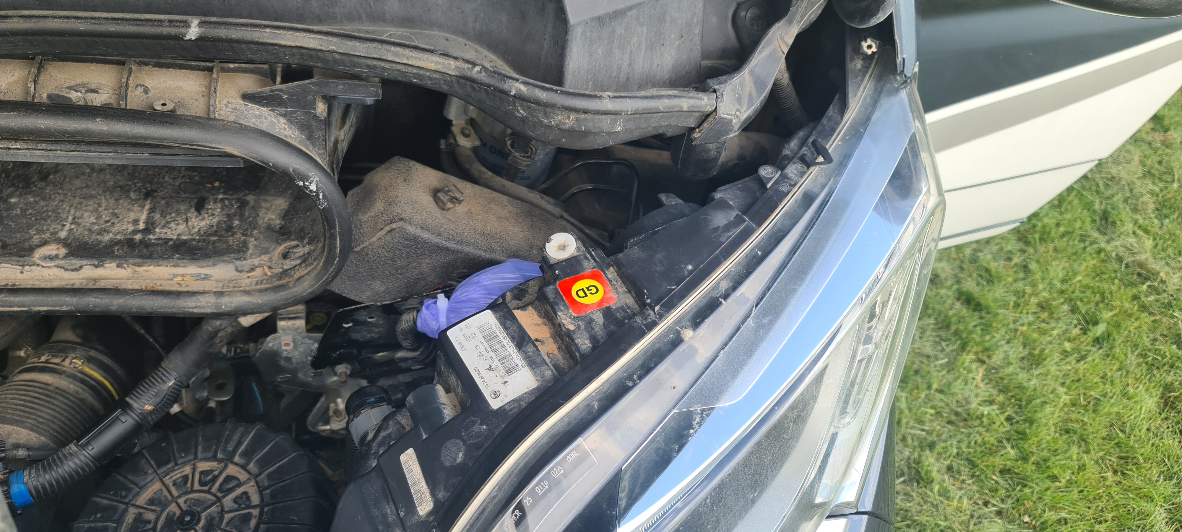

Thanks for all help people!
I think found the relay was actually the glow plug controller. But the grey connector that may be the culprit is the DPF for the cat. I'm wondering if wet in this plug caused the issue.
Anyway I have covered some of the connectors to protect them from the water ingress!

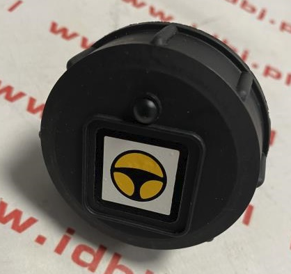

On the opposite side of the engine bay (right hand side) there's a power steering fluid reservoir. The x250 cap has a small hole in it and a small pipe which normally works as some kind of vent. The pipe was known to fall out due to vibrations and water was getting through the cap into the reservoir! It was not mixing with the fluid, but it created an emulsion, which caused problems to the steering mechanism.
That's how the x250 cap looks like:
That's how it looks like without the pipe:

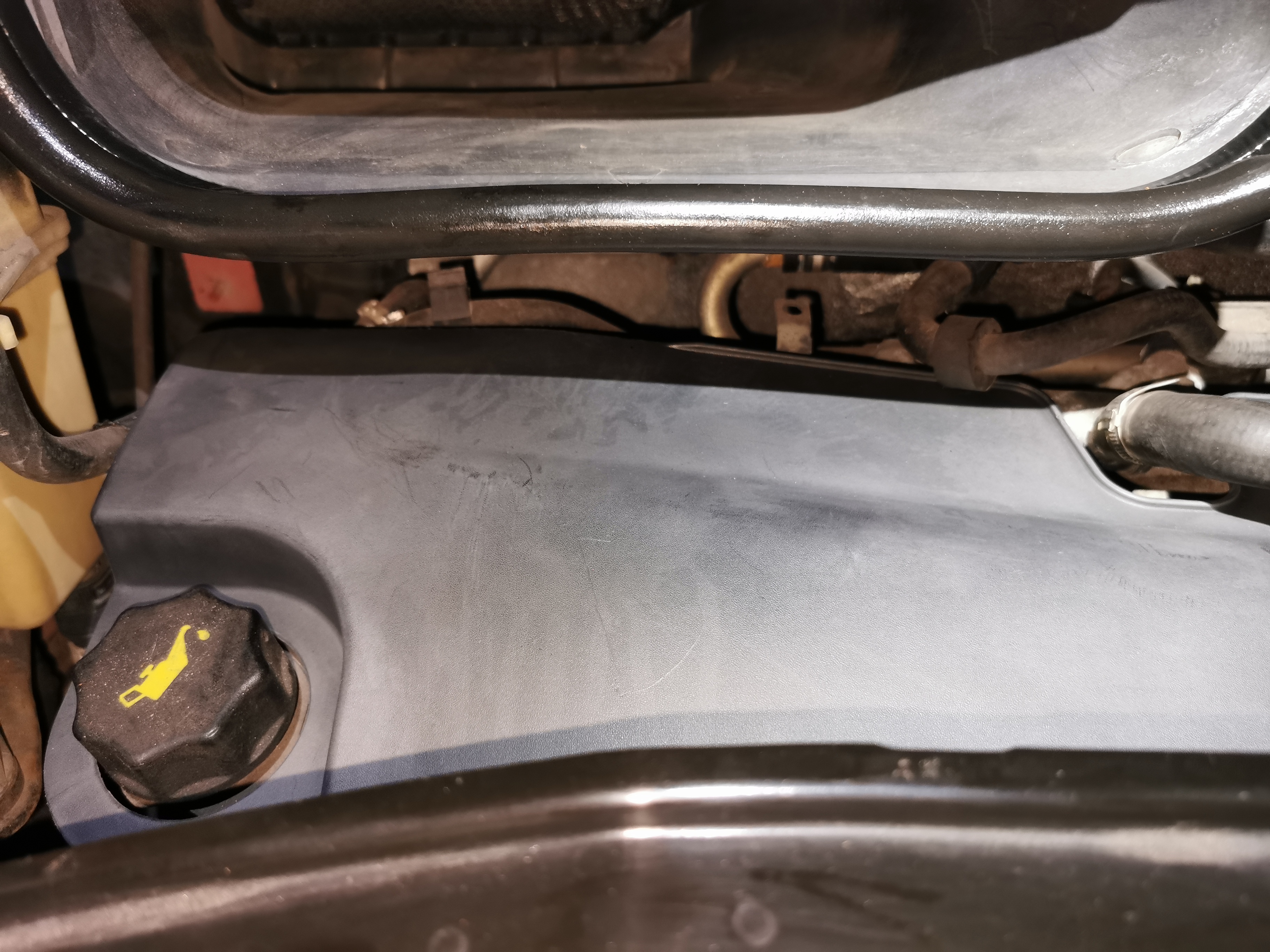

In my 2012 x250 I have an extra cover which apparently was fitted by Citroen:
It just clips onto the cap:
I've just found online a new cap without the hole:
I hope it is fitted as standard in the x290. But please check that your cap is sealed. And safe for your van.
I've read on the Polish forum that Sevel was fitting an extra engine bay plastic cover for the English market (hahaha, probably because of the amount of rain you have), which was directing water to the front and the back of the engine bay. And thus preventing the connectors getting wet. I have no knowledge of the Fiat part number, but I'd be interested in getting one, so if someone has got this extra cover in his engine bay, please post the part number and / or photo here.
I have some cover in my engine bay, too on the top of my Natural Power engine, but I think that it covers only the right hand side - I need to check a few things on the engine in a couple of days, so I will take a photo and post it here together with the part number for future reference.
Thank you for your reply. I have now protected the connectors that were getting wet. I'll look at the earth strap too! Thanks for all the extra info!

I know that this thread is about this precise electric problem, where water caused an issue on a cable with damaged insulation. But in x250s and x290s there's a known issue with water ingress into the engine bay during rain. If water won't be able to get into the engine bay, it won't cause any electrical issues, even in case of some cables' insulation being damaged.
People having this water ingress problem will find that post useful. I hope :) I know that not all of the x250s / x290s have this plastic cover, as written in my previous post. I also know that the water ingress is causing problems with injectors removal.
