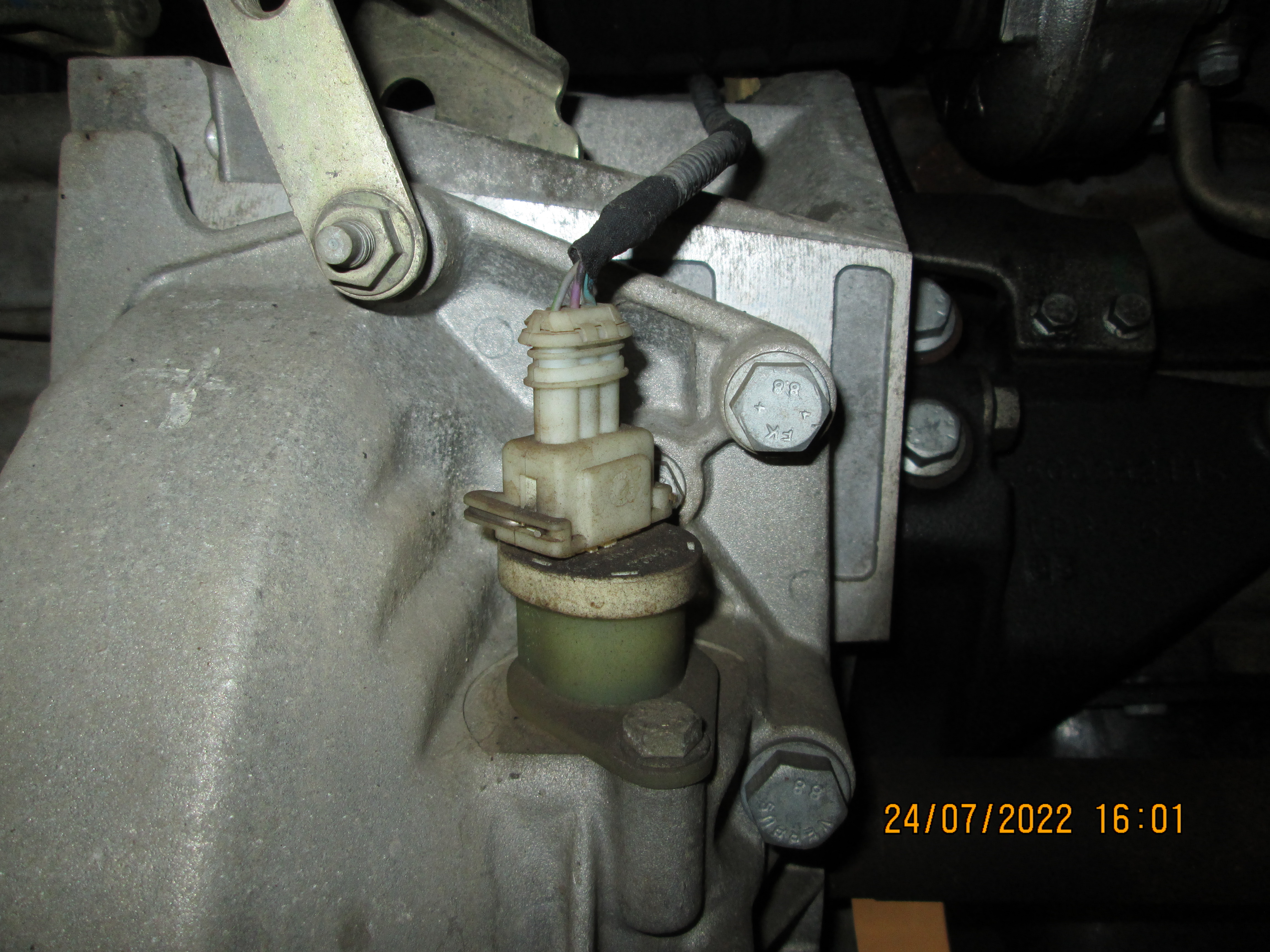

Hi, my 2004 Fiat Ducato jtd has a speedo issue.
Early into my journey the Speedo suddenly stops working but sometimes starts working again🤷‍♂️
Any idea’s guys 🤞
The fact that the fault is only manifests itself after some distance has been travelled suggests that the problem may be caused a rise in temperature.
With this in mind, the speed sensor which is located at the gearbox becomes a possible suspect. Heating will be due to the gearbox warming up, and perhaps from the power consumed by the sensor. Sensors are not expensive and can be obtained from China via Ebay for less than £5.
Another cause could be a failing oil vapour heater. However I have only read of this device going short circuit and staying in that condition. Both the sensor and the heater among with other items are supplied by F11 in the engine bay fusebox. If that is blown by the heater failure, then no speedo. This one is easy to eliminate, as you can unplug the heater and operate without it unless venturing to the Scottish Highlands or Scandanavia in winter.
On the x244 the ECU uses the speed sensor in the cruise control option, but not clear whether used elsewhere, so perhaps no fault codes?
If neither of the above, and in the abscence of further suggestions, you may have to consider the possibility of a fault in the instrument panel.
