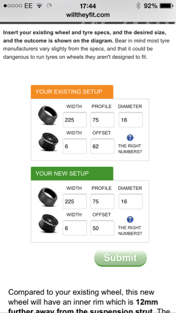

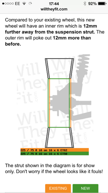

Need to know width of alloy?
If 6" same as standard,
Et50 will sit 18mm further away from the centre of vehicle than ET68.
That's 36mm wider (both wheels)
From memory that would put quite an extra load on the bearings/hub and steering
Possible tyre rubbing on wheel arch,
My van has 225/75x16 tyres and come close to arches, std size is 215/75x16 which are slightly smaller diameter, so may get away with that (front arches)
Maybe other members more mechanically minded van confirm this
Hope that helps
ImageUploadedByFIAT Forum1389894978.561569.jpgImageUploadedByFIAT Forum1389895001.314142.jpg
This offset tool I've based it on ET50 & ET62 so it shows 12mm
But ET68 equal 18mm
Tyres based on what I have fitted

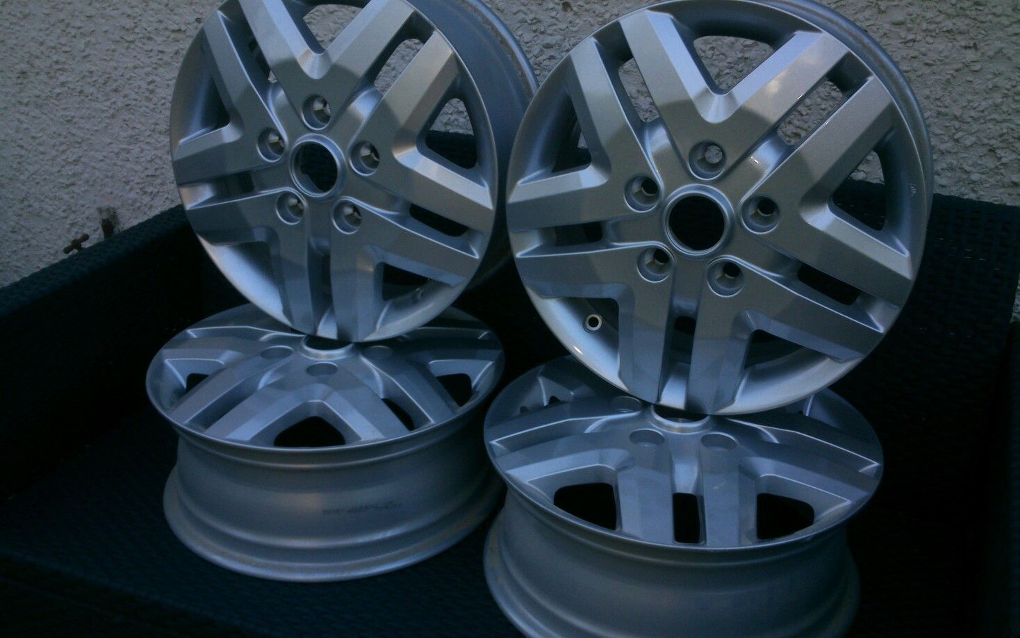

The wheels that I am after are 16" Fiat Alloys. I am waiting to find out from the seller what PCD 118 or 130.

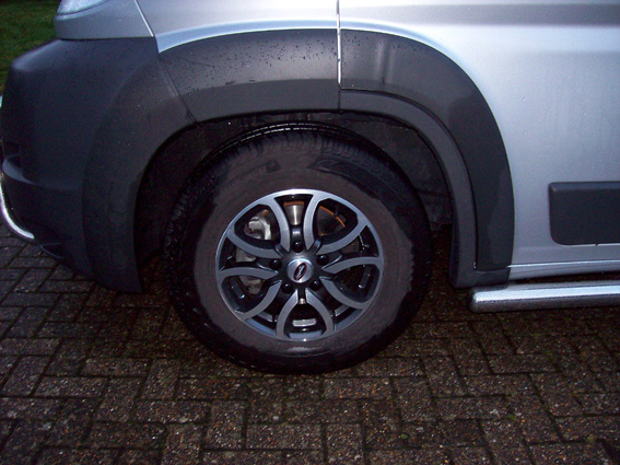

No I was outbid and I forgot about them. They went for £250 for all 4 new fiat wheels. I have got some new scorpions which look a lot better. Made for the Maxi van with a load rating of 1250kg per wheel.
Hi All. Finally got the new scorpion wheels on the van using the existing tyres. Just for your info the new 250 does not have the blanking plates where the fog lights go. I had to take off the quarter bumpers to cut out the circle to fit the day running lights. I do not know how but when wired up to the fuse box and ignition turned on, the onboard display tells you that day running lights have been installed ??. Can anyone tell me how to upload pics to my threads.
