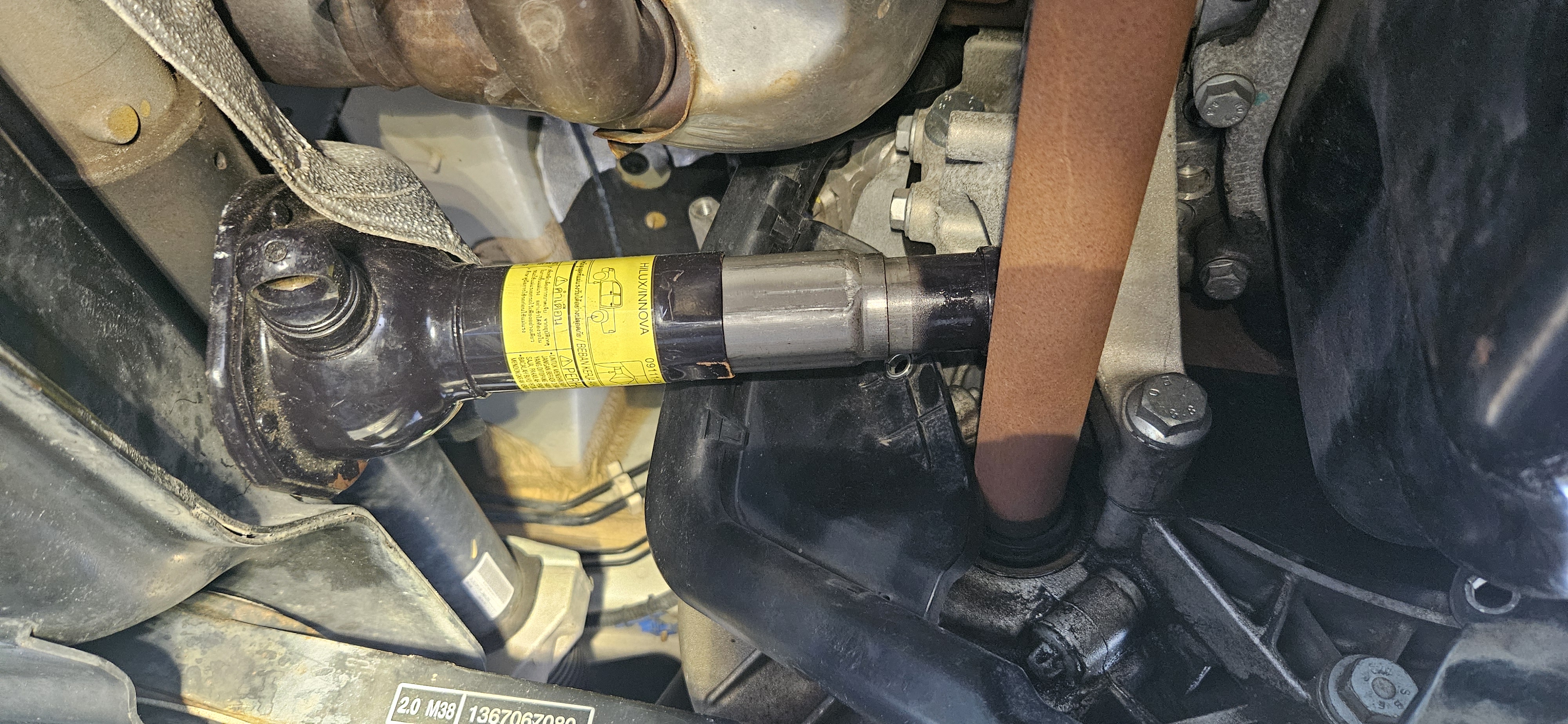

Update for other 2017-2019 Ducato owners with dual EGR needing to replace the alternator.
Alternator failed.
Symptoms in mine were burnt smell for a short period. Battery light coming on. Slightly raised idle. Voltage with engine running 12.4V.
Other than that vehicle runs and drives normally.
You can drive for a while with the alternator not charging, depending on the health of your battery. Mine is a motorhome so I paralled the 2 home batteries to the engine battery and I drove it for 2 hours without any problems. Batteries still had good charge at the end.
Alternator replacement was a real pita.
It is relatively easy to unbolt the alternator, but very difficult to get it out due to very limited access space.
I had to undo the bottom engine mount (near the gearbox) and tilt up the engine. I used a small mechanical bottle jack pushing up from the subframe to the gearbox. I tilted the engine up as far as it could go.
Then I had to undo the bottom clamp on the corrugated metal hose for the EGR. The clamp is very hard so I made up a spreader.
After that, with lots of patience, I found a way to manouvre the alternator out between the DPF and the power steering column.
Putting the new alternator in was even more difficult than removing the old one. You have to try fitting it in the same way, but this time gravity works against you and the alternator weights about 7kg, so the slow process of finding a way in takes its toll on your arms.
Once the new alternator is back up there it is quite easy to finish the job.
My old alternator had a freewheel clutch pulley. The new alternator I could find, recommended replacement for my vehicle is identical, but with a fixed pulley. I could swap the pulleys, but it requires a special tool, so I just installed it with the fixed pulley. I hope it is not going to make much of a difference. Comments and opinions on this are very welcome.
The original alternator Fiat (Bosch) would have been $2515AUD. The identical (except pulley) aftermarket Bosch alternator I got was $575AUD.
Attached are a few pics that could be useful if you need to do the job.
