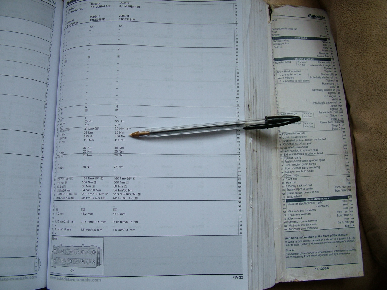

Never done one, but does this engine series no. match yours?
This is a 2012 manual so confirm else where to be sure.
Thanks for the reply, the engine code is F1CE3481E its the multijet 180 I believe. there really isn't alot of room between the pully and the chassis leg. so wondering if it's possible to get at by lowering the engine on the o/s a few inches
I suppose it depends how long the "spigot" is towards the engine, as in how far you have to pull the pulley out to clear crank side.
