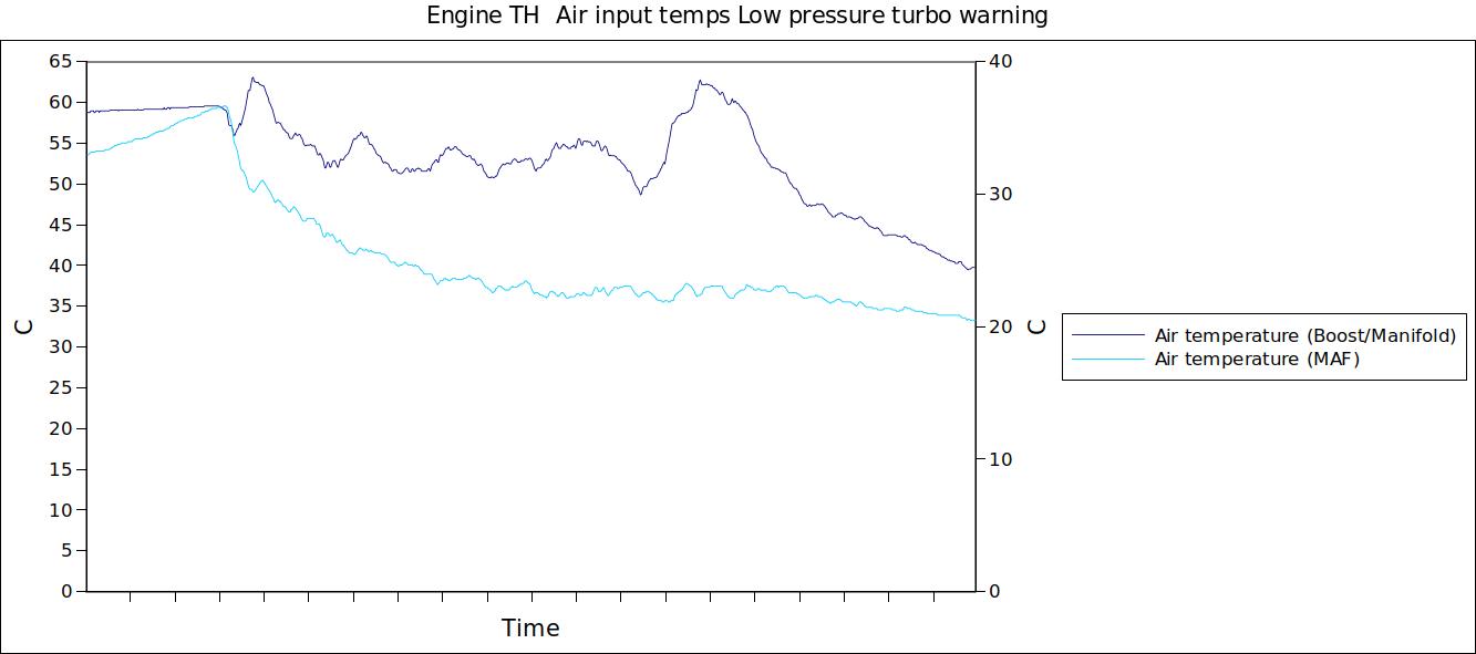

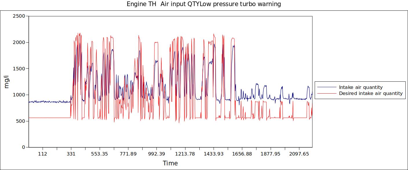

Here are a couple of graphs
A couple of observations
the turbo actual boost generaly is higher than required
the turbo actuator generaly follows control position but not to required value
the air intake QTY generaly follows desired QTY but not to required value
The MAF and MAP sensors are working
