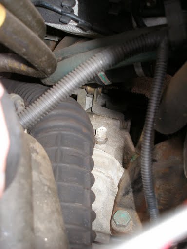

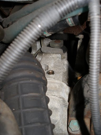

Hi
Have a look at the Pictures on here pic 37,38 & 39 might give you an idea where it is located. It is just to the left nearly under, where the top aluminium engine mount casting which is bolted with 3 studs to the lower black steel casting in which in turn is bolted to the top of the gearbox.
Looking from above it is behind/under the large air tube from the bottom of the air cleaner & also just behind the clutch slave cylinder. (if all that makes sense)
http://picasaweb.google.com/ggrigg/FiatGearbox#5366238857960949186
Hello Free spirit, I have just come across the same problem, unfortunatley your pictures are unavailable now, any chance you couls resend or forward them on to me , many thanks
Hi
The Pictures on Pacasaweb were linked to a post by Gary, I did save a copy of the Reversing switch ones. The vehicle he had was a 2.8TD I think, with a slightly different gearbox.
I have found it on my 2.8 JTD (after a lot of searching) & it is as described above under the Air cleaner & slightly under the gearbox mount, & can be seen with a little difficulty if it (air cleaner assembly) is removed, the Gearbox Breather is also visible with the air cleaner assembly removed & it is under the large air cleaner tube to the turbo if you move it (the Tube) out of the way slightly. I will attach the reverse switch pics from Garys' web. Next time I have the Air Cleaner assembly off I will take pics of mine & show the location of both the Reverse switch & breather.
Cheers
