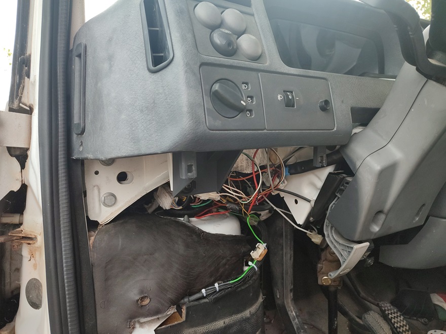

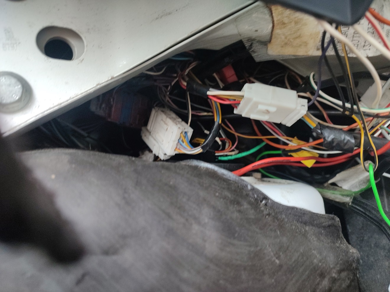

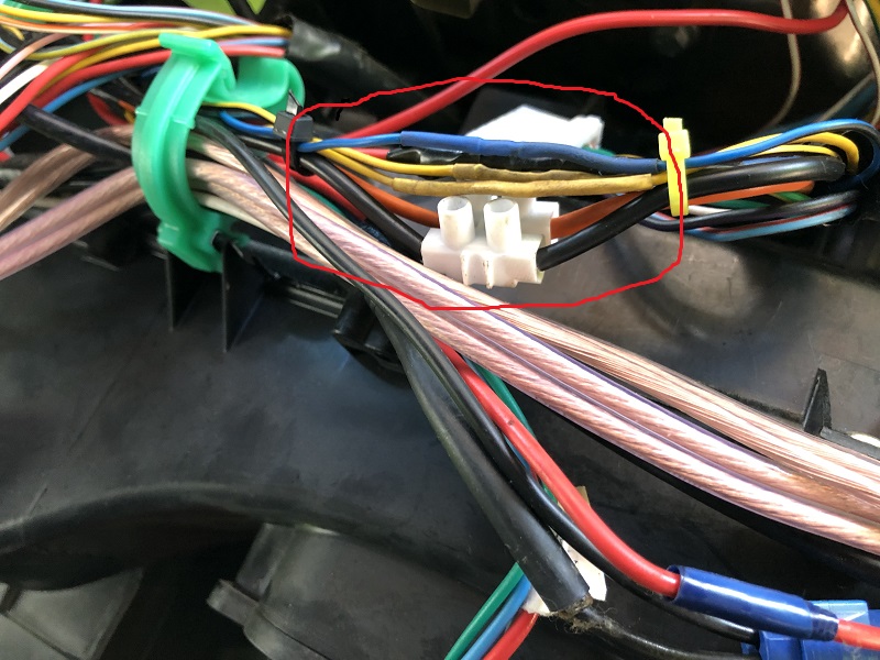

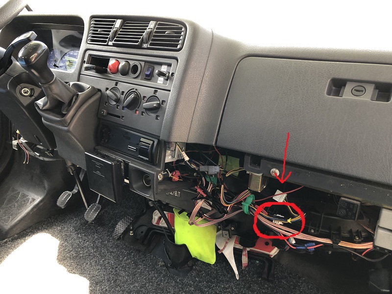

Today I removed the passenger lower dashboard panel (5 screws) and cleaned a 6-wire connector which was right there. I could not find any posts showing the location in my x230 model when searching the forum, but I figured it probably was this one you meant. Anyhow after cleaning with electrical contact spray, air gun to dry it and refitting the hesitation was still there. I then cut all 6 wires on both ends of the connector and soldered them together. Amazingly after soldering them the hesitation is almost completely gone. In some cases, I can still feel it a little bit around 2.200 rpm at light pedal action, but 90% improvement. Can there be anymore connector along the way?
This is the one I cut and replaced with soldered joints (except the 2 thick ones these one I used screw joint as you can see)
Attached images.

Nice pictures! Are the connector in the same place on X244 Ducatos?
The quick answer seems to be NO!
The connector location may be correct for an x230, but for an x244 eLearn shows only connector D004A as an intermediate between the accelerator potentiometers, and the ECU.
Connector D004A is located in the bottom of the engine bay fusebox, and is referred to as the engine front coupling. Access to D004A is gained by uncliping the fuse and relay panel.
Disconnect the battery negative before starting work.
There is a black 6 way connector behind the LH dashboard on the the x244, but the outer 4 wires are associated with cruise control, and the middle two wires (one thick red) with aircon. This is connector D018B and the cruise control wires also connect to the ECU via D004A.

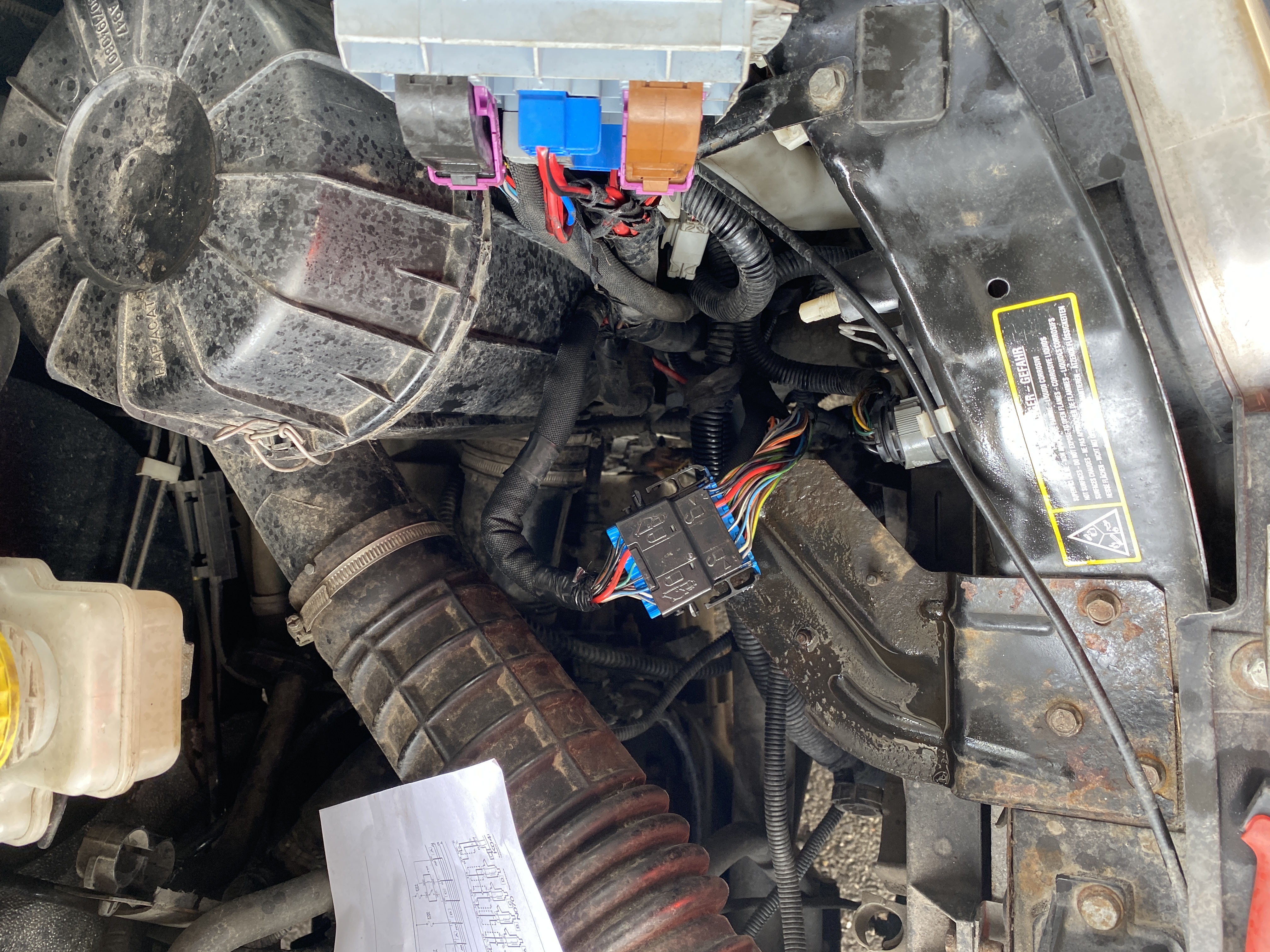

Thank you Communicator! Here is the remedy:
X244 Ducato 2.3JTD -02
Code is P0220 - Accelerator pedal sensor 2
Drives normal but Check Engine lights is on, problem started after engine swap to -06 engine, this was done during previous owner. But mechanic could not locate problem so they decided to blank the check engine light. :bang:

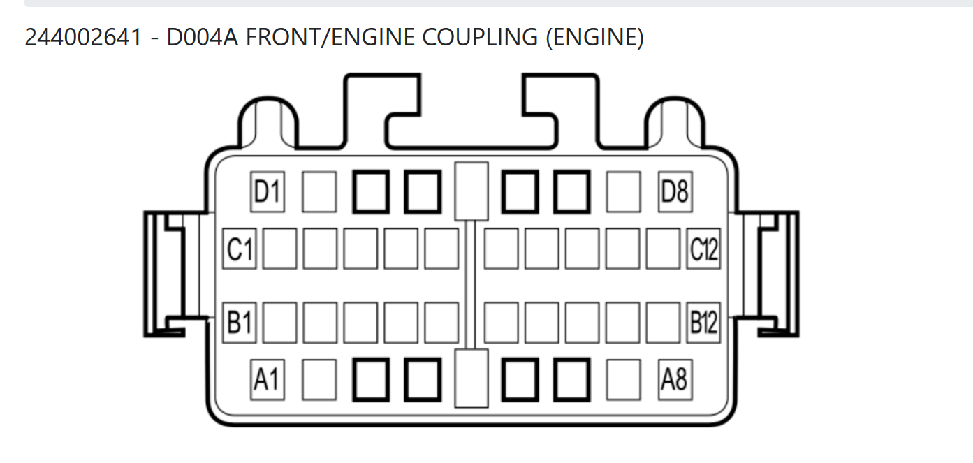

D004A is located under fuse box in engine room
PINS C02 and C01 was bent and lying at the bottom inside the connector. Straightening these out was the remedy.

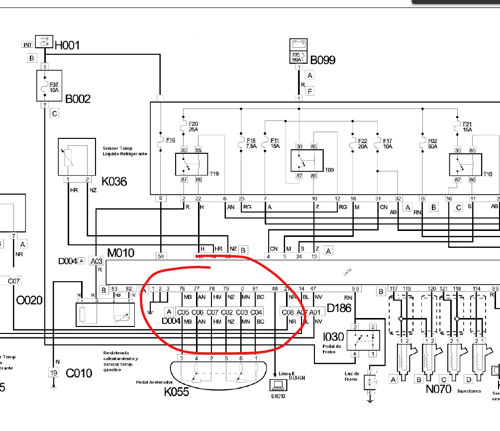

Some wiring diagrams for knowledge:

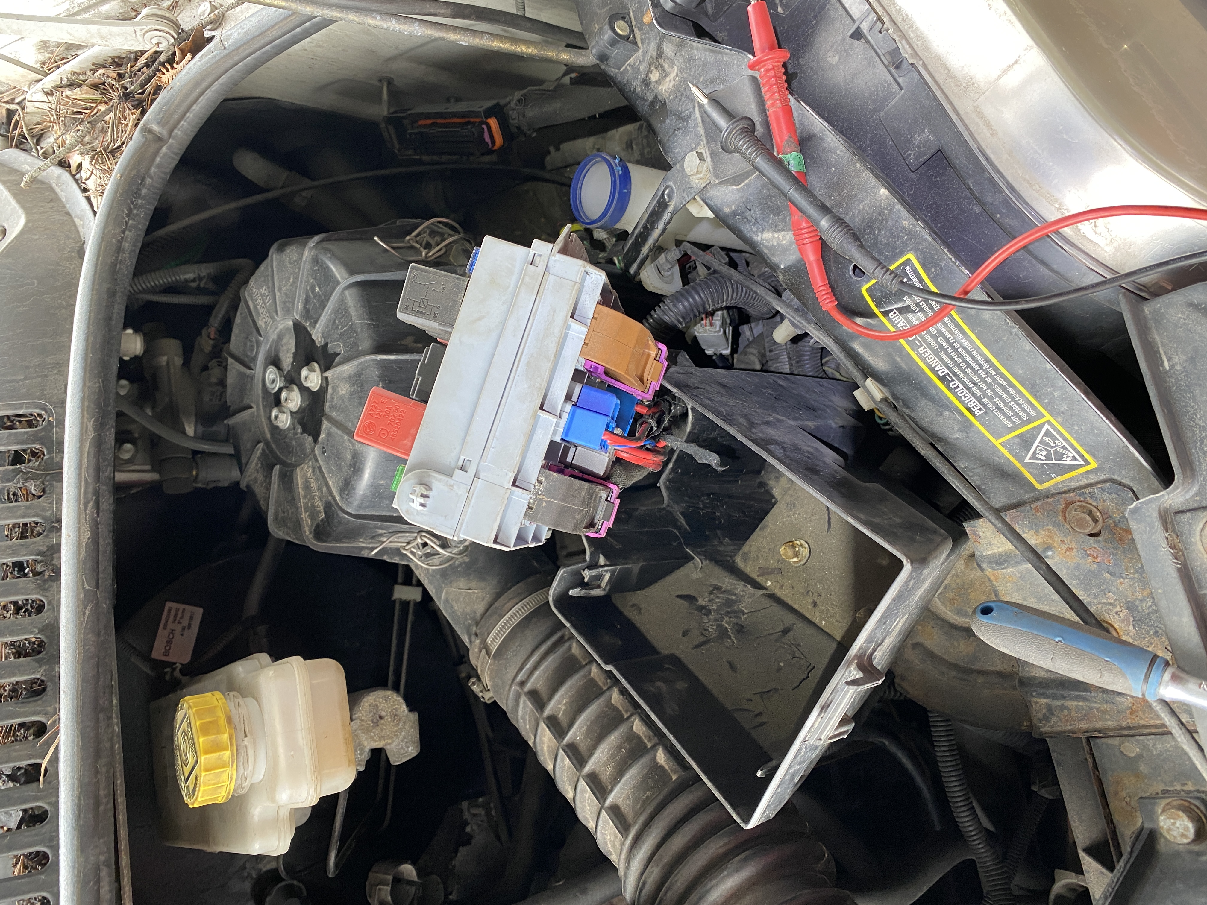

I had limp mod. go on when low trottel, ~1700rmp .. low load after a breaking down and accelerating again. maybie if u let the foot quick enough the ecu dont save the error and u can drive normaly on.. in my case. i had too reset the ecu error poti2 gas pedal.
- i measured 35ohm between peda and ecu on grey-red cabel.
-when i checked the connector it self healed and said 0 ohm sudendly. (so maybie juste touching it cures the problem?!)
so far ok now.. 150km went smooth..
