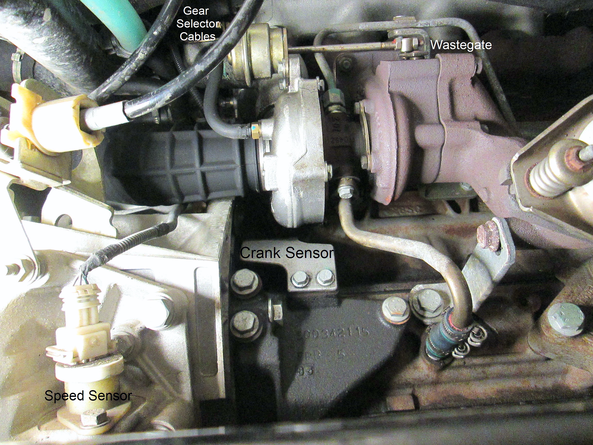

1. The common rail engines were "dropped" into the existing Ducato x230 model, which is usually indicated by the first three numbers of the VIN. ( The format of your VIN would require more research.) The 2.8jtd Sofim 8140.43s replaced the mechanical injection 2.8idTD Sofim 8140.43 engine. As I understand the mechanically driven rpm and speedometer were retained. Subject to confirmation the rpm drive is mechanical, and taken from the primary shaft, so will not indicate until clutch is engaged.
You mention having replaced the crank sensor. This is located at bottom rear of engine, and access is not brilliant. See photo

The selector shaft moves into the box, as you move left to right across the gate. Best to observe what happens as gear is engaged by assistant. You may need to be underneath or remove air filter and hoses to get a good view. Try this before considering dropping box.
3. The lack of power could be due to a faulty wastegate link. Split or leaking air hoses are also a possibility.
