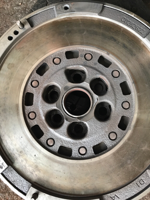

This is what happened to mine, the centre piece of metal started to detach itself and it caused release bearing noises and turned out it was the dmf then loose in the centre, several small bits flew off, changed the lot and it’s all good again IMG_3962.JPG
